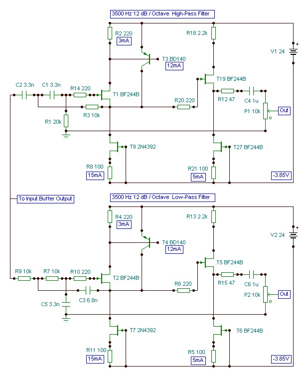

Considering the size of the bass-mid driver, the tweeter could be more suitable for reproducing those frequencies still with 12 dB roll-off. That´s what I think.
I mean, at least from what i have read, the cut-off frequency is also connected with distance between drivers, if that is time-space distinction then ok 🙂

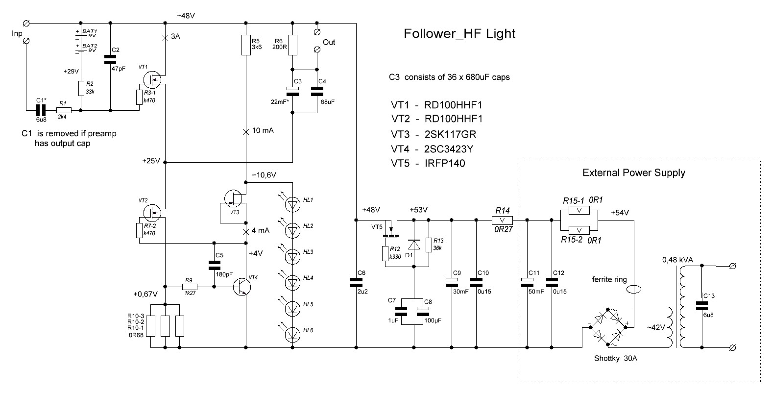

I don't really understand some of the posts about the power supply, I see some disagreements but not sure what the conclusion was. When I review the schematic I see a SE amp, the active device is loaded by a CCS and the speaker is in parallel with the active load - so the draw on the amp psu is a constant current and the filter caps are indeed outside of the audio path to first order. Isn't this a 'bog standard' configuration - what am I missing ?
... - so the draw on the amp psu is a constant current and the filter caps are indeed outside of the audio path to first order. Isn't this a 'bog standard' configuration - what am I missing ?
It is really not a standard case, since say 99% of schematics being in use do not posess this property.
Here I post the "light" version of this follower. It does not need matching of transistors, mor reliable (less voltages, especially to the gate of VT1, and sounds in the few watts region even better than "senior" version. The only "contra", output power is smaller.
Whats so so different is that the load is referenced to the regulated upper rail and not to GND...in that way the PSU caps i effectively taken out of the signal path..

WladimirK...
what is the upside of using the RF-device for the current source...?? and would there be any drawbacks by using a less costly mosfet in that position...??
WladimirK...
Could be you are right, and I would propose to try to substitute VT2 by 2SK1530.
But, I consider the VT2, VT3, VT4 section as a specific amplifier, and it must fit to VT1 properties. However, the difference could be negligible, I simply have not tested it.
MiiB,
the loudspeaker motor´s function is represented by the simple formula e = Blv, which defines a voltage source. For greatest linearity, any voltage source must approach the properties of an ideal voltage source and must be driven from a nearly ideal current source in direct and exclusive manner. Pertinence has been generally abandoned because of the need for practical convenience. Your company may have the opportunity to change the trend, but I haven´t seen any sign of it yet. It´s rather regrettable to talk about things of secondary importance, while neglecting the central point.
My speakers exhibit a gentle roll-off without the usual irregularities in that range, allowing very easy adaptation, I still preferred a higher ƒc point with a weak 6 dB slope. My experiences are not generally valid.
