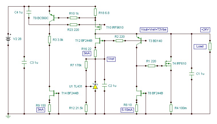

I will try to come up with something. This is a proposal for the power supply. Would 24V be suitable for the active crossover?
Of course, i prefer single ended topology for active crossover. Your power supply will feet excellent. Thanks WuYit 🙂

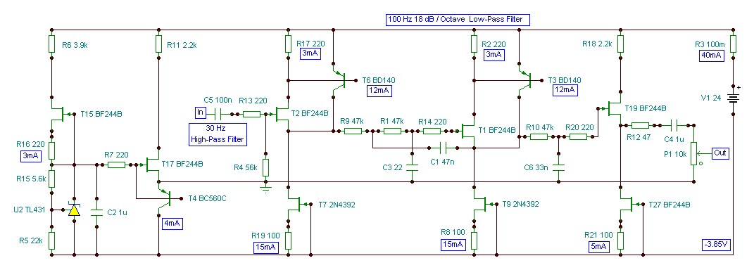

After a couple hours of intense work...
great !!! I will need some time to undersatnd your circuit. Is it yours or you find it on net?
I think its Butterworth type of filter or im wrong? I will try to use it for 6dB and to increase the frequency to 140 Hz because i have to, the distance between drivers is for 140Hz, maybe 70Hz could be an option also. You are using workbench software?
It will be my pleasure to build your design for crossover and PS also.
The cutoff frequency for the sub bass and the bass-mid driver should not be the same. Please don`t worry about it, 100 Hz will be fine. We can expect resonances in the area.
