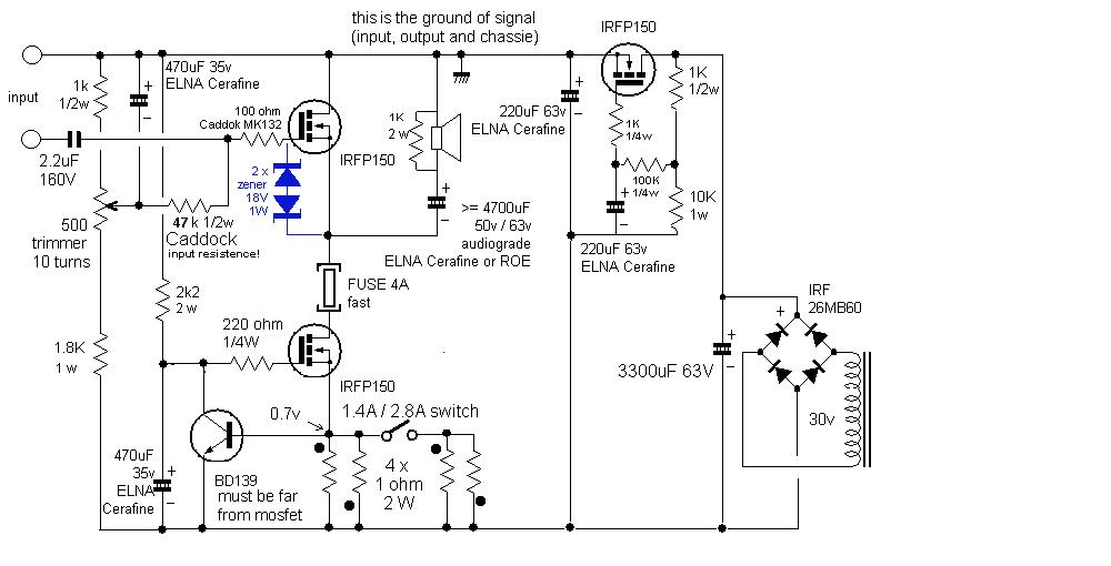

power supply rails serve as a (usually poor quality) AC ground. Taking a quick look at the Thevenin equivalent circuit can be helpful and hopefully would reduce the number of misconceptions.
You are making statements, for whome? Possibly, you would like to warn somebody, against what?
Why is the the rail a poor AC ground...since it also the reference for the active device.. it must be the best possible...
VladimirK
What do you think, what would be the limit of current and voltage for PF99 by Andrea Ciuffoli?
I would propose, for you specific heat sinks, to use a simple temperature probe, being an accessory of multimeter. Just press the sensor to metallic part of IRFP150 case and measure its temperature. Junction to case heat resistance of IRFP150 = 0,65 deg/W.
If you dissipates P = U x I watts on the device, and if you measure case temperature = T degrees in this specific situation, you can calculate the junction temperature Tj = T + 0,65*P.
You are allowed by the datasheet to increase P and correspondingly T until Tj remains less than 175 degrees. I would not advise to go higher than Tj=150 degrees.

A concept we speak about here is well known, shunt-like approach. There is nothing conceptually new in audio for quite a long period, any "new" circuit can be decomposed into well known parts.
However, the shunt approach is almost unused, due to definite difficulties with its implementation. It is not convenient especially for mass production, class D is a way to future here.
For diyers and hobbists, the shunt-based schematics could be quite appealing, and I consider myself lucky since I have got sound that I listened only from the very top systems.
Did You ever had an ocassion to compare the sound of PF99 and Your design?
I can see that using fast devices like HF transistors with low input capacitance the responce should be faster. Can You send a meassuring results of square signal on 1KHz and 10KHz?
I did not test the original Andrea's schematics, there could be some difference. Important also is a choice of the output capacitors.
I observed square wave responce while selecting R1 and C2 values, using them limits the pass band (near 1 MHz) and makes flat the top of the square wave.
Of course, 1 and 10 kHz square waves are reproduced absolutely perfect (on my 50MHz scope I do not see any deflection from input signal after slight output signal level adjustment).
At 100kHz there is some deflection, the left top corner of the square wave becomes a bit rounded.
But, this is absolutely not decisive for final sound, much more specific properties are involved.

MiiB,
Decoupling is isolation of amplifying stages in a common line. Separating the signal grounds (reducing the shared supply traces), gives minimum transmission of noise, interaction and interference.
Bypassing is reduction of high frequency current flow in a high impedance path.
Jean Hiraga used several hundred thousand uF of capacitance in his battery powered MC amp consuming about 10 mA of current. (In my view, he understood the essence of audio more than anyone else).
Mainly because of power supply insufficiencies. Power supply capacitors play a decisive role for the properties of signal ground and have a major impact on amplifier linearity.Why is the the rail a poor AC ground...since it also the reference for the active device.. it must be the best possible...
Excuse me, but what you are saying here is not reality, concerning the signal ground (one is free to choose ground on plus or minus rail, there are detailed writings about this on tubecad, including explainations of this kind of follower), and references to Hiraga is not suitable as well. It is not difficult to speculate, but for solving the question it is better to assemble hardware.
