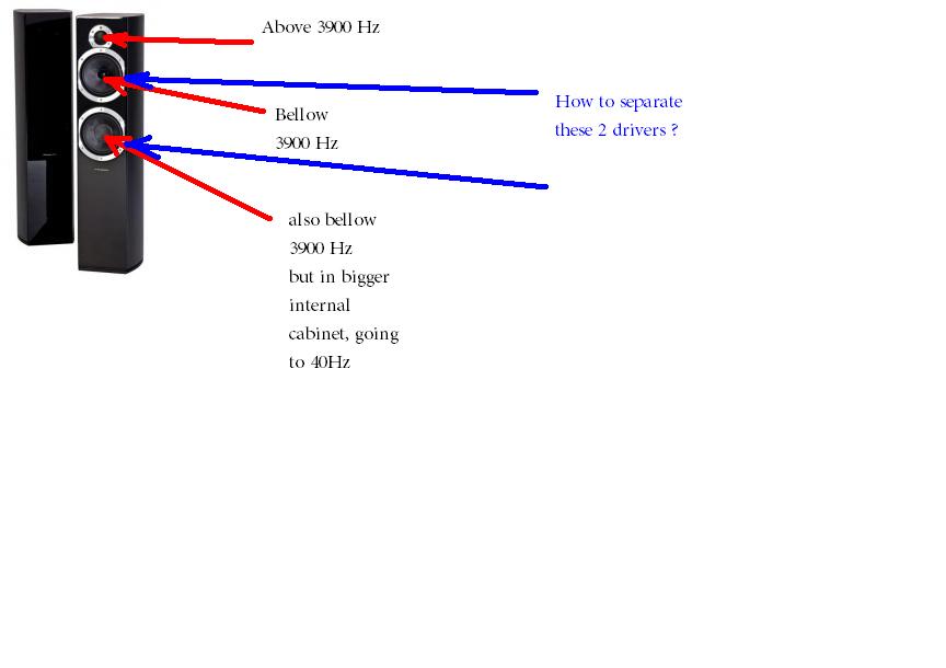

In my case its little difficult to build an active crossover because of dpeakers i have (cheap Wharfedale diamond 10.4 - 450 EUR) they are two and a half way speakers. the cut-off frequencies are 140Hz/3900Hz. The two mid bass drivers work together, one of them works down to 40Hz because of bigger cabinet (cabinets are internaly separated) for that driver is only a choke. The other part of cabinet consist mid-bass driver - choke in serie and capacitor in paralel, and tweeter C in series and L in paralel.
So, i build an act. crossover with cut-off frequency on 3900Hz/12dB. I didnt knew what to do with that bass going down to 40 HZ, so i connect it in parallel with mid-bass and i get 2-way speaker. The fact is i dont know the slope of original passive crossover in these speakers and sensitivity of each driver, so my act. crossover was far from perfect. For 2 mid bass drivers i used Marantz PM-44SE, and for tweeter PF99 and tube gain stage. I couldnt set the gains of these different topologies. Now you can realise how inperfect that project was.
I would appriciate any suggestion how to implement an active crossower for Wharfedale Diamond 10.4.
I have to say that using act. crossover bass was so clean and thight.

It would be easy to do, but cut-off between two bigger drivers is 140 Hz (Why eighty Hz?) and i dont know the slop (could be 6 db becouse is one choke only for the bass and midd bass according me have slop at 12 dB because of L and C filter) also what about sensitivities? How to set the gains for every amp? I dont have such a equipement to meassure the f. responce.
I was trying to find the sensitivities for drivers i have try hard but it seems too hard to find such a information.
You can eventually keep the 140 Hz high-pass filter or/and insert a series capacitor at the input of the amplifier. It´s not necessary to measure sensitivity, just make some adjustments afterwards. I would not go higher that 100 Hz anyway in order to achieve high resolution.
You were right. Finally i understood how 2.5 way speakers work.
I have to use 6 mono-bloks and 3-way stereo active crossover.
For speakers i have it should be:
1. 0-140 Hz/6dB
2. 140-3900Hz/12dB
3. 3900-20000Hz/12dB
What you need is 80/100 Hz 18 dB active high-pass filter, 3900 Hz 12 dB active high-pass filter and 3900 Hz 12 dB active low-pass filter combined with 140 Hz 6 dB high-pass filter, right?
After some researching on net i realise that i need:
0-140 Hz / 6dB act. low pass filter
0-3900Hz / 12dB act low pass filter
and high pass act. filter above 3900Hz
