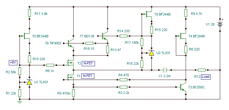

In any amplifier regardless topology, the audio signal passes through all parts, thus the power supply components, it would be weird if not.
You insist in refusing quite an obvious fact, that appropriate topology design DOES allow the audio signal to pass only part of the whole schematics, in particular by using shunt power supply.

the audio signal only sees an impedance...
Yes, in case of a shunt power supply, schematics is separated from PS electrolytics by a current source, which has an impedance for alternating current close to infinity. In this understanding, an alternating current of output signal does not pass through PS behind this CS, and output signal is produced by dynamically sharing some fixed current with active regulating device of shunt PS.

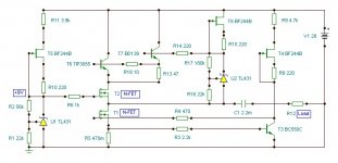

Do you have at sense off weather the quality of this amplifier is due to to the fact that it is single ended or its the shunt nature that contributes most to its qualities...??
After thinking a little I'am reluctant to think that it is the latter....the shunts....and isolation from the PSU
I'll try to finalize the double shunt concept and also put some gain into a pre-stage so it can be driven from normal line level......I'll also design it with more normal and not so expensive mosfets....I hope there then could be some builders....

the cascoding compound has nearly same the location as VT5, but the base is referred to the output. I mentioned one reason, otherwise, there´s much to say about cascodes.

I am absolutely sure, the shunt topology contibutes much to sound perfection.
I see no problem to add an amplification stage to the follower, just common source stage based on J74, loaded on drain resistor or another J74 in a current source mode. The only doubt, such additional stage also needs shunt PS.
I use similar amplification stage as a separate preamp with shunt PS.
I was thinking on putting the pre-amplification stage on the same rails...and making it as a folded casode with two-shunt followers as the second stage... differentially driving the loudspeaker without the need for output caps...

MiiB,
I have opinions like anybody else.
What I mean is that, disregarding the improper bias arrangement, the amplifier of this thread is an ordinary source follower, behaving as such, not more, not less. I can't see any particular shunt concept.

... I can't see any particular shunt concept.It is really pitty that after 10 pages of this thread you still do not see shunt concept. But we must not be crying about this. One small IMHO, if you have an interest to sound differences from various topologies, just try and make own conclusions.

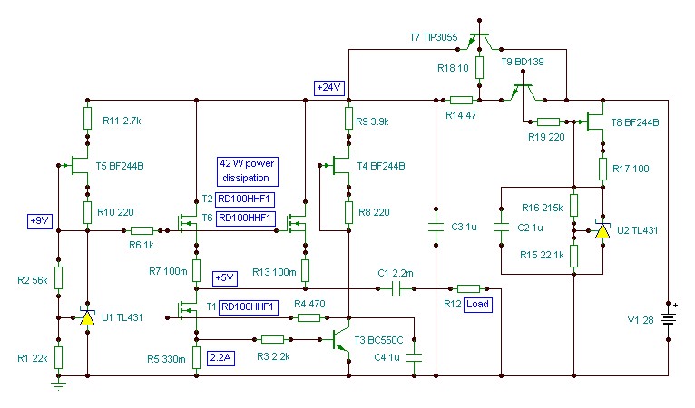

Another variant, Vds still held pretty stable:

Goran, The Aikido was not available when I built my PF99s. I have tried to modify my BOZ using more than 100V rail but couldn't solve the problem. I don't know why a tube should be better here. Is it because of the voltage gain?? I will try again using Vladimir's preamp (or Aikido) and use small mosfets for the modified PF99 (IRF630 or IRL510 or IRG4BC20UD-IGBT or laterals if the amp deserves it).
I know that they are considered too "small" by others but why not? I can add fans... and lower power of course.
- Modified Follower-99 With HF Transistors
