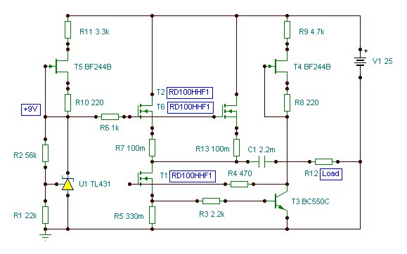

I am making tests of a "light" version of this follower, only one RD100 as VT1 and VT2, current 3A, gate bias of VT1 only 18V (two 9V batteries), rail voltage on the drain of VT1 only 48V.
Also I put Allen Bradley 1W resistors fir R1 (2k4), R2 (33k) and Silver-Mica cap for C2 (47pF). As was expected, sound has got some additional ultimate vitality, but less maximum power.

Also I should mention, that there is no need in source resistor (0,1Ohms) for VT1.I am making tests of a "light" version of this follower, only one RD100 as VT1 and VT2, current 3A, gate bias of VT1 only 18V (two 9V batteries), rail voltage on the drain of VT1 only 48V.

I proceed from the criterion
quality = (transconductance) / (parasitic capacitance)
As per this criterion, only other HF mosfets and tubes can compete with RD100.
It is my guess, that naturalness of sound from good tube devices has two main reasons: small parasitic capacitances + less electrolytes used
Not forget, parasitic capacitances of MOSFETs, not only relatively high, but also nonlinear.
Listening to this follower and comparing to 300B SE tube amp, I conclude that my suggestions are not wrong.
