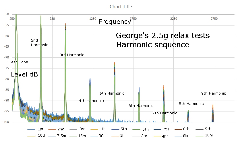

Here's the last of my analysis for George's 2.5g test for now. It show relative amplitudes of harmonics of the test tone, for all files on the same chart.
One might recall that an earlier post analysed 3rd harmonic distortion levels, and noted a strong correlation for reduced 3rd harmonic distortion with progressive number of tests/plays.
This chart illustrates that the same phenomenum appears to apply to all odd harmonic levels, and the effect is increasingly pronounced for higher order odd harmonics.
I can't resist pointing out a fact: slew rate limitation of a sine wave progressively makes a waveform become more triangular, with harmonic content of odd harmonics increasing in a tapered pattern remarkably similar to that observed here. And vica versa, of course: reduced harmonic distortion in this pattern would be consistent with improved slew rate with increasing test number/plays.
Also I note that even harmonic levels appear relatively unaffected by these tests, especially the 2nd harmonic. Weakly, I suggest any correlation with test number is in the opposite direction to that for odd harmonics, ie increases slightly with test number, if at all.
All very interesting, don't you just think ?

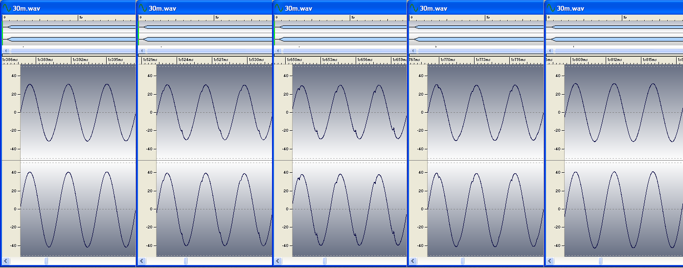

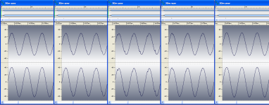

Any chance of cumulative tip contamination affecting tracing distortion?

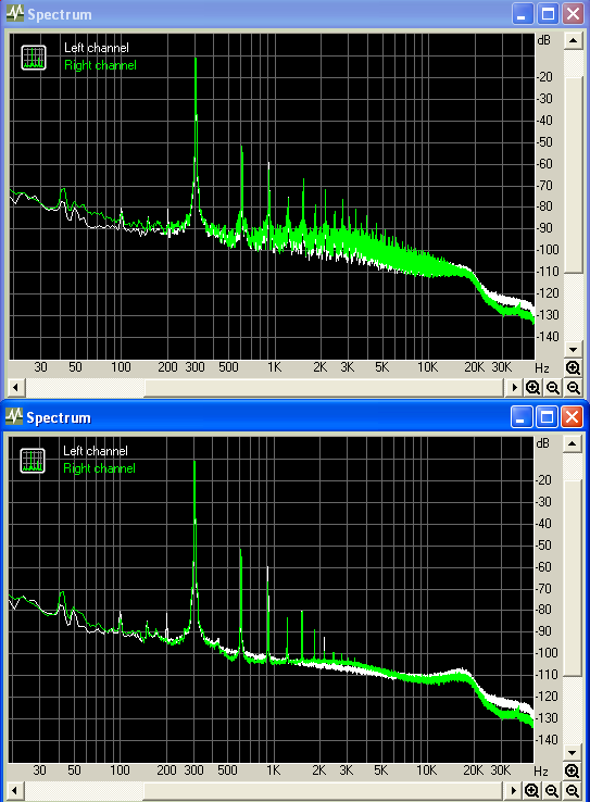

Cumulative in the real sense of the word, I wouldn’t say, but dirt sticking in the needle yes (*). The room I did the tests is the living room and it’s not designated as a clean room.😀
In fact, the static increases –thus the potential to dust attraction- after each disc cleaning and I had to lower the needle at various radial points across the disk (not over the test track) to discharge the static before starting each test recording.
(*) Results of dirt sticking in the needle can be observed when doing a single tone track recording by watching the tone’s waveshape in the digital recording. It distorts it. It consequently alters the peaks spread in the FFT of that recording.
That was a case that I happened to capture in a recording while doing the 300Hz test with the Stanton at 2.5gr VTF. I mentioned the discrepancy in post # 918.
In the 13th playback (the after 30minutes), there is a mysterious glitch at the beginning of the recording for 30secs, which affected the FFT. So, for the diagrams only (*), I dropped the data of the 13th playback and I replaced it with the average of the 12th and the 14th recording.
I noticed there was a problem due to the dirty FFT and I opened the wave editor to see the waveforms.
The dirt remained on the needle for 321ms but the damage on the FFT of the 18s 300ms recording was pronounced (see the screenshots with/without the dirty section).
If you have downloaded those test files you can review and analyze the file yourself.

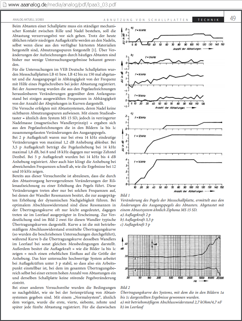

Here is the 1st page from the article of the German magazine ANALOG ACTUELL 3/2003
http://www.aaanalog.de/media/analog/pdf/lpaa3_03.pdf
Image 1
Change in the level of the measurement disc (various high frequencies) versus number of playbacks (1 to 150),
a) tracking force 2 p
b) tracking force 3.5 p
c) tracking force 5 p
Image 2
Transfer curve of the system with which the results in the images 1
were obtained .
a) with moderate operation terminating resistor 2.7 ohms / 4.7 nF (as used in the tests)
b) open
The cartridge used was the RFT Ziphona System MS 15
http://radio-ftv.podspot.de/files/DSC02640.JPG
http://radio-ftv.podspot.de/files/DSC02641.JPG
http://radio-ftv.podspot.de/files/DSC02642.JPG
This part of the article says that under 3p tracking force there is no discernible change in HF tones with multiple playback of the same vinyl track. This behavior also varied a lot depending on the vinyl material from brand to brand.

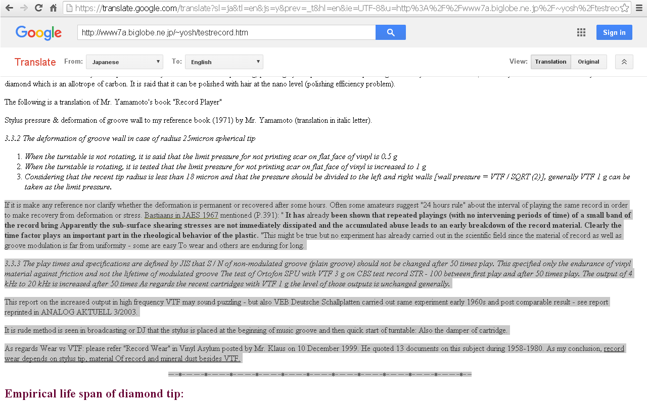

I found this in Yosh site.
ƒeƒXƒgƒŒƒR�[ƒh
Thanks, George. Yes, Yosh's excellent resources explain what I was trying to say. There's a diagram that shows at what part of a sine cycle that force is applied, depending on whether spring, damping or inertia is making the demand.
Spring is associated with big groove displacements, damping with steep groove angles, and inertia with tight groove curvature.
Strictly, it's not a frequency thing, rather a matter of the groove shape which, in real programme material, comprises all these factors: they are all in play at the same time. Of course, it's true that low frequency sine waves have big displacements for a given velocity, high frequencies have tight curvature for a given velocity, and mid frequencies have neither.
But it's an artificial construct to think of frequency 'partitions' to cartridge behaviour since strictly it's about displacement, angle and curvature.
For example, in the case of that 300Hz@+12dB tone test of yours, both groove displacement (90um) and angle (25 deg) are quite stressed, near performance limits, but curvature is relaxed. So even if the stylus stays in contact with the groove, high forces are applied via teh cantilever, and if anything can flex one would think it will at the locations of high stress on the groove.
Interesting.......
Can't work out what's physically going on at all, but interesting in the context of your tests which appear to show a similar trend !
BTW, in your 2.5g test with modulation near the trackability limit, it's like double the stylus-groove peak force ie equivalent of about 5g in a lightly modulated groove.........I wonder if your tests are showing record wear due to high modulation?

Also, Shure published an article mentioned by Richard, which presents that in progressive playback tests @1kHz, 3rd harmonic distortion can be observed to improve with number of plays.
In the past I chose to disregard this, partly because it lacks a satisfying explanation, and partly because the article appears to be marketing focussed.
Nevertheless, here's what the article presented:
Test 1: 2nd and 3rd harmonic distortion versus number of plays
Cartridge: V15 Type III
Tips: biradial and hyperbolic
Signal: CBS STR-100, bands 3A and 3B, 1 kHz
Tracking Force: 0.75 gram
Number of Plays: 100
Results:
2nd harmonic with biradial:
no significant change on either channel.
2nd harmonic with hyperbolic:
3rd harmonic with biradial:
decreases about 33% of original value.
3rd harmonic with hyperbolic:
decreases about 40% of original value.​
Test 2: Same as Test 1 but at a tracking force of 1.5 grams.
Results:
increases by an average of 20% from original value.
decreases by an average of 40% from original value.
decreases by about 33% from original value.
decreases by about 33% from original value.​
For clarification, I mean that the 2.5g 300Hz tone tests show a correlation for small increase in test tone level with progressive number of tests/plays.
The 2.5g 300Hz tone tests also show a strong correlation for significant reduction in 3rd harmonic (and odd harmonics generally) with progressive number of tests/play.
