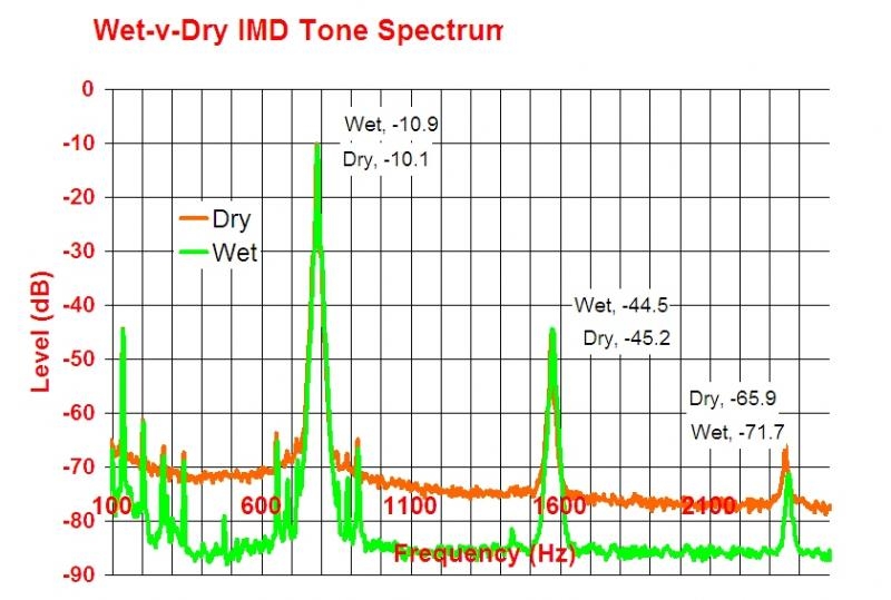

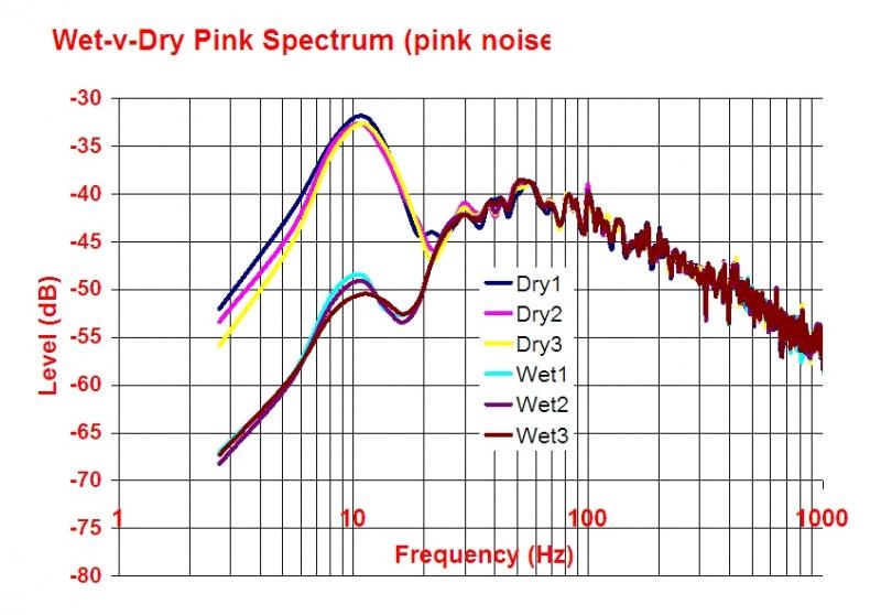

One of those Eureka moments...... just realised there is a very interesting elephant in the room as to a possible cause for the effects seen in George's 2.5g 300Hz tests........
Improvement in cart-arm stability, reduction in noise, significant reduction in 3rd harmonic distortion concurrent with near unaltered 2nd harmonic distortion, and modest improvement in test tone level are also all observed in wet playback IME. And correlate with stylus-groove friction coefficient, IME.
So a single cause hypothesis for all effects seen in George's 2.5g 300Hz test suite would be reduced stylus-groove friction with progressive plays.
Attached are some old plots of wet-v-dry playback. The X axis is mislabelled, but shows a fundamental, 2nd and 3rd harmonics.
I acknowledge that Hans has been unable to reproduce these results, but stand by the general observation that friction coefficient correlates with these effects, and wet playback reduces friction coefficient.
I like this explanation: it's simple, plausible and fits. Proposition is the groove gets progressively polished, effectively without changing shape. I still can't explain the effect on 3rd harmonic distortion, but know it to correlate with reduced friction coefficient.

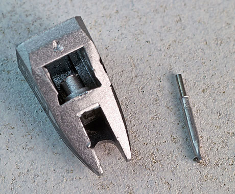

Well first test would be a comparison between new and old to see if there is a significant difference (at least below 20kHz). So no waste in me buying stylus 40.For sure! I'm willing, however my OM40 stylus is near the end of its life - I've had it a long time, used it a lot and loved it, so be advised...........it's currently retired but still OK.
its the blob on the back that matters and I think they are standard since some time back (still have an original 70s concorde to dissect). But this is the thing I need to investigate first, hopefully without lunching £200 worth of stylus.I'd love to know about OM40 stylus/cantilever performance on S-120 suspension. There might be an issue with tube diameter, thinking about it, because S-120 is a fine example of fat tube, and OM40 is skinny.

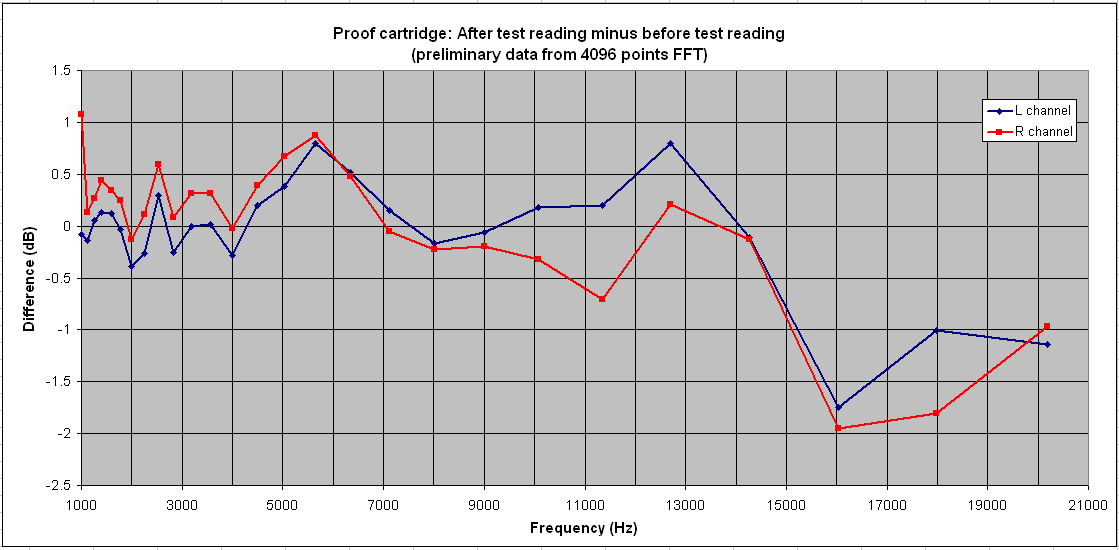

There will be one-two days more before I will have the 150 test recordings ready for uploading (24b/96k, 33.3sec, 3.2M samples each)
I decided to use the 1kHz to 20kHz stepped freq sweep from the Ultimate Test LP (side 1 Track 6) which allows measurements at 27 specific frequencies.
Preliminary rough data analysis based on 4096 sample FFT from the Shure reading the test track just before the x150 Stanton playback and just after the x150 Stanton playback.
The chart shows the difference.
There is an interlay between some test tones and the harmonics from lower tones, that’s why we see these two bumps.
A 2M sample FFT clears up the scene but it is to be used later.
Now I only want to show that there is no dramatic evidence of vinyl polishing.

Hmmm.......such things aren't strictly a matter of frequency: rather a matter of instantaneous programme level, especially if sustained, or a matter of slew rate. All that matters is a groove shape which incurs high stylus-groove force, and presumably wear/polish. So even George's 300Hz@+12dB 2.5g test, apart from having a notable standing VTF stylus-groove force, has significant modulation induced stylus-groove force.I'm assuming and wear from the polishing is above 15kHz.
I tried to explain this, but not sure very clearly.........
LD
I understand that, but if the polishing is also removing useful information, rather than just reducing surface roughness that should remove HF content first. By the time there is a significant glitch in a 300Hz tone in music I would suspect a lot of HF has been ground off.
But I do need to think what a real musical signal with high stylus-groove force looks like. I do forget to think time domain.

Thank you for doing these tests George, and I so much look forward to the test files.Now I only want to show that there is no dramatic evidence of vinyl polishing.
If the principle effect of polishing is to reduce friction, I wouldn't expect effects to show in f response to any extent. The best marker IME is the cart-arm resonant system which gets stimulated by variations in friction. Other markers are the noise floor, and odd order harmonic distortion. These markers together would be a strong indicator IMO.

For reasons unknown (to me at least), all one has to do to improve 3rd harmonic distortion for a sine tone is reduce stylus-groove friction IME. So no 'ground off' required, and besides it would be a remarkable coincidence if any grinding was in exactly the right place on the groove to produce a purer sine tone, and we can have a very good guess at where the exact location(s) are..........and in the case of wet playback, it's reversible........!
