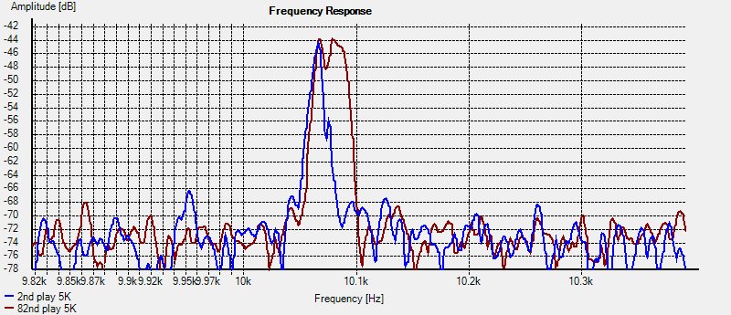

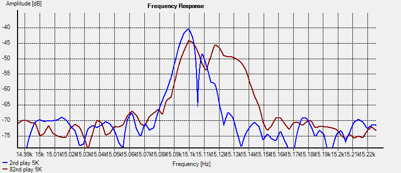

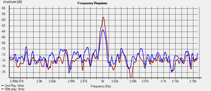

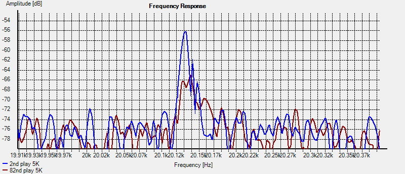

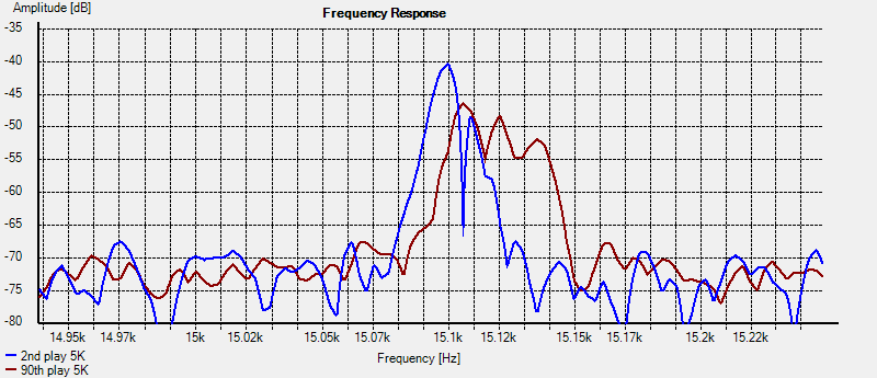

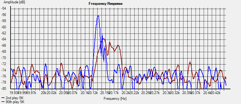

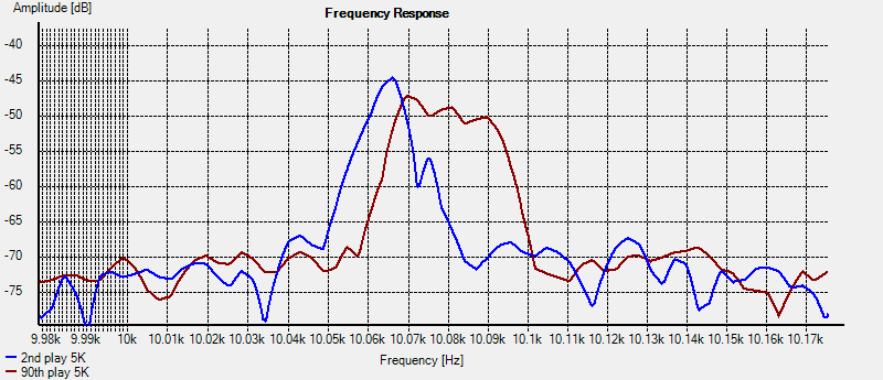

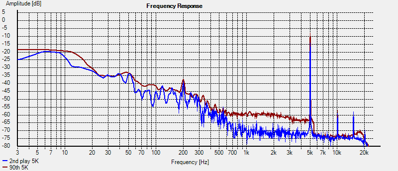

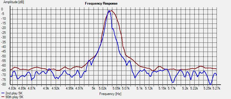

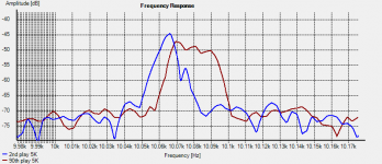

I've looked at the 2nd and the 90th play and done some analysis. I've looked only at the 1K tone and the 5K tone. The recordings were surprisingly low in volume, they had to be amplified by 36dB to get good levels. That done, I ran a spectrum in them at 32K points, Blackman-Harris window.
Below are the 5kHz graphs. You'll see that the fundamental of 5kHz is the same from the 2nd play to the 90th, but the 90th does not look as clean. I've also isolated the harmonics for you to look at.

There are several very strange artifacts. First of all the almost instantaneous drop off in the noise floor (red) after 5k simply has no reasonable physical explanation. What's with the triple peaks???.

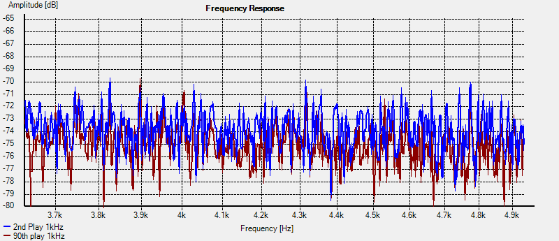

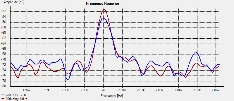

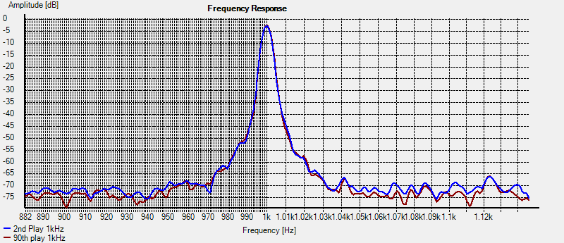

Here is the 1kHz tone from the 2nd and 90th plays. This looks much more reasonable.

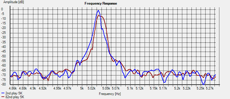

I'll go back and check the 5kHz files. Maybe a corruption. Might look at play #80 instead.

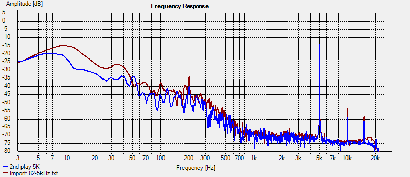

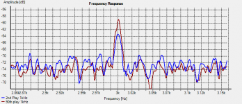

Here is the 5kHz tone from the 2nd and the 82nd plays. Noise looks better than on the 90th play. That file must have been corrupt. Still seeing more than one peak on the harmonics. Are they hitting more than 1 bin?
but plays 12, 82 & 90 are about 0.7% fast.
That's a lot for polishing to account for. TT issues????.
