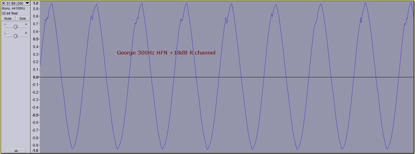

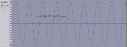

Just started to look at George's HFN 300Hz +12dB, +14dB, +16dB and +18dB files. Very interesting to look at the extremes of force/trackability in this test.
This visual is very interesting, I think. It shows just the right channel at the onset of mistracking @ +18dB. One can see the location at which the stylus stops following the groove locus, and follows a chaotic path before resuming. This is, unsurprisingly I suppose, near the peak of programme sine level, which corresponds to near the zero crossing of physical groove shape where angle (velocity) is high, curvature (acceleration) is near zero and displacement is near zero. At this point, force opposing stylus movement is dominantly from suspension damping and stylus-groove friction, and the balance of forces downwards and upwards is near zero.
But just look at how much variation there is from cycle to cycle in terms of mistracking onset point and the consequent behaviour..........! Is this evidence of variation in friction force, perchance ?
And, for this test including the 2.5g 300Hz previously analysed, the physical zero crossing location of the sine groove shape must be the area of maximum force, so if flex happens that is where to look, methinks.

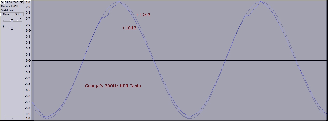

Here's another interesting visual from George's 300Hz HFN tests, this one overlays the +12dB waveform with the +18dB waveform, normalised for level.
One can see that an effect of the extra +6dB is to make the waveshape more triangular: effectively slew rate has been limited. This seems to fit with odd-harmonic correlations seen in George's relax tests.
I think it's now possible to see and deduce what might be physically happening in the difference between these tests. At +18dB the stylus takes a longer path perhaps by riding up a groove wall when forces become high, until at some point the balance is impossible and it mistracks for a moment.
It's also possible that something flexes, rather than stylus rides up the groove wall. If that were vinyl indentation, the stylus path would become shorter, and slew rate would increase - but the opposite happens ! If the cantilever flexed, on the other hand, the generator at the far end would perceive a slower slew rate, which is consistent with what is observed.
So, perhaps this is differential evidence that, in this high force test, cantilever flex is possibly indirectly observed rather than vinyl indentation? Or that neither happens, rather the stylus rides a groove wall to find a longer path when force is strong, which I prefer I think.

Lucky thank you for looking into these recordings. Very nice presentation.

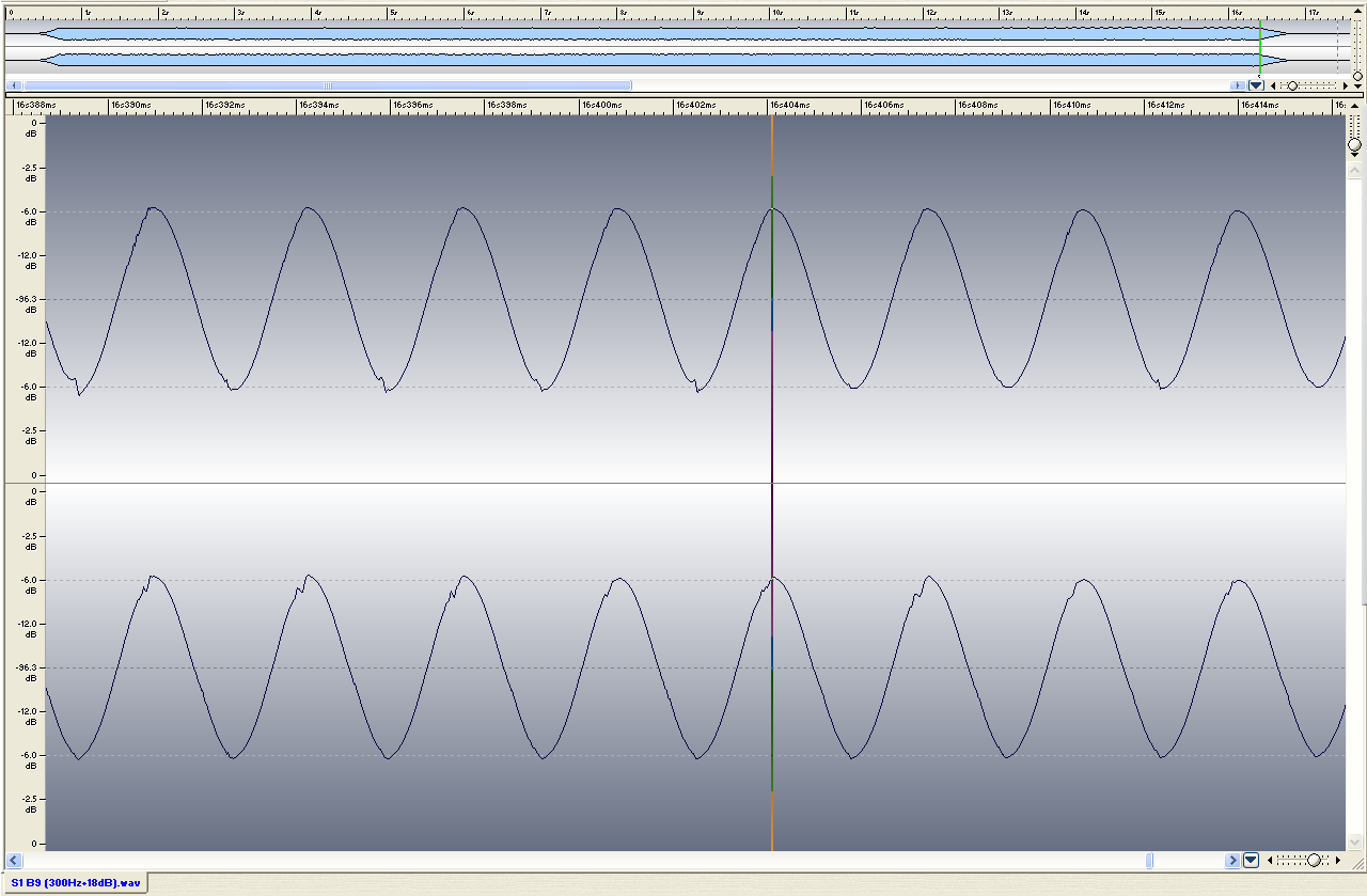

When you want to visualize the actions and reactions that occur during playback of this extreme track, you want to isolate the events in time.
In the +18dB recording, the waveform peaks at 700ms.
The first few waveforms between 700ms and 706ms show what you are investigating at the very front end before the cartridge body, head shell, arm, arm base ect (*) start to return vibrations back to the cantilever fulcrum
Past the 706ms, waveform remains at the same amplitude but the visible distortion increases and moves a bit across the waveform. This is one of the indications of the returned vibration energy.

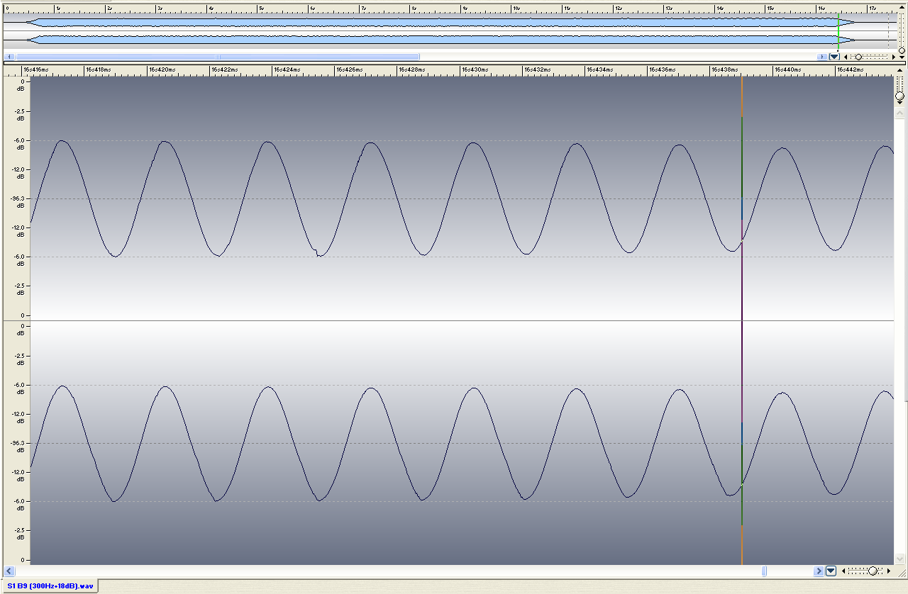

The waveform remains at the plateau peak up to 16s 408ms, then it starts dropping.
Notice how the distortion at the waveform is visible many ms after waveform reduces in amplitude , actually it is visible till 16s 438ms. This is another indication of the delayed vibrations coming back, dying out gradually.
Note that there was great care in modding and adjusting this pick-up system, that’s why what you see (at least in the +18dB recording) is a bit unique i.e. very mild distortion.
(*) and possibly vibrations from the vinyl bulk too.

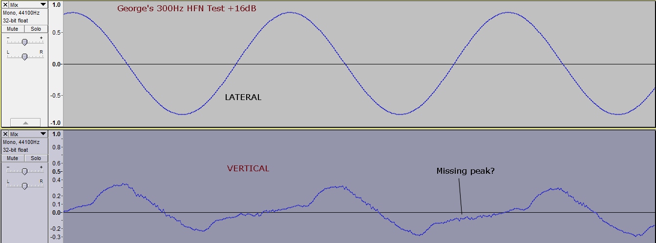

Well, in theory for a mono 300Hz sine waveshape as we have here, pinch effect should force a stylus up symmetrically at both grooveshape zero crossing points, and VTF should push symmetrically down at both peaks. So pinch effect fundamental should be at 600Hz, and stylus motion should be vertical. That's easy to see by extracting vertical signal from L-R channels, of course.Lucky, could the longer path trace be attributed to simple tracing error (pinch effect) at these extreme modulation levels?
However, a quick look at the vertical signal (L-R) and lateral signal (L+R) in the time domain shows no such thing here. There's a whole peak missing at one of the zero crossing points, so it is very asymmetric across test tone cycle......suggesting the stylus isn't moving much vertically at one of the groove zero crossing points, where it should/must!?
I'm sure there's enough here to work out why, but it makes my head hurt right now ! Explanations ?
