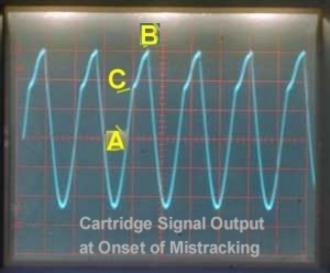

Well, for that to happen, the playback wear/indent pattern would have to match cutter-induced shape distortion pattern of the groove.......which seems a big ask, and lacking a reason IMO. However, IIRC Shure mooted something along those lines but also didn't know why that would be.
For the 300Hz +12dB test tone, we can know the locations on the sine groove shape where stylus-groove force has maxima. Seems fair to assume this is where fastest wear/indent would happen.
In principle, the locations are somewhere between the zero crossings (peak velocity) and peak displacements (peak suspension spring displacement) of groove shape. This is illustrated in one of Yosh's own measurements (IIRC), where by happy coincidence he used the same 300Hz test HFN track as George used, except Yosh reduced tracking force until onset of mistracking, whilst looking at an oscilloscope trace of the cartridge output. So we can know the location on the grooveshape where onset of mistracking happens, which we can say is the point of maximum groove-stylus force (or close to it), as per Yamamoto.
Attached is a marked up image of Yosh's plot that shows the onset of mistracking, in terms of cartridge output, labelled at point C.
We can see that it agrees with the prediction of where maximum stylus-groove force should be.
However, also note that the mistracking is asymmetric, suggesting forces are asymmetric. This is because of the effect of tonearm offset angle on applied force at the zero crossing point, ie instantaneous skate force is not symmetrical.
For these reasons, should not wear/indentation lead to a progressively asymmetric groove shape, ie even-ordered distortion? But neither George's tests nor Shure's article suggest this, quite the opposite. And what's more, the region of groove needed to be worn/indented to become less triangular (fitting the observed harmonic pattern in George's tests), is not the region of maximum force........ it doesn't fit.
So I doubt Shure's explanation (IIRC) of wear that cancels cutting error, appealing as it might be. I think some more satisfying explanation is needed and still out there...........

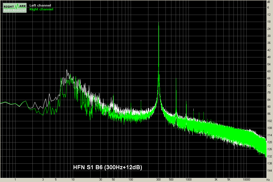

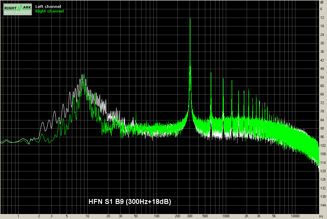

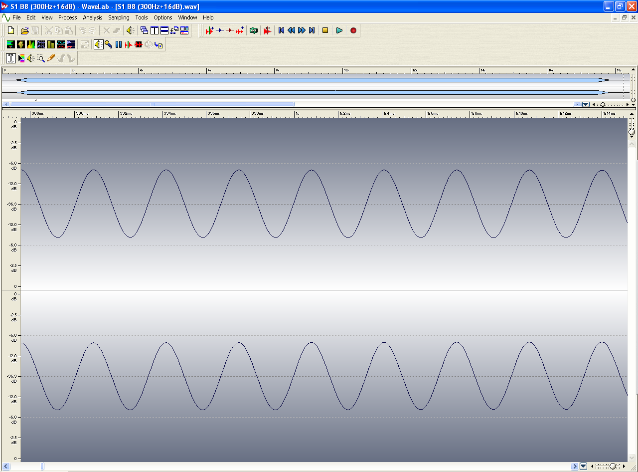

You may be able to fish some more data on this 🙂
S1 B6 (300Hz+12dB)
https://www.dropbox.com/s/8ywohjdhf6mrsge/S1 B6 (300Hz+12dB).wav?dl=0
S1 B7 (300Hz+14dB)
https://www.dropbox.com/s/ygcl802hgsjrn31/S1 B7 (300Hz+14dB).wav?dl=0
S1 B8 (300Hz+16dB)
https://www.dropbox.com/s/rat62hj91ei17rh/S1 B8 (300Hz+16dB).wav?dl=0
S1 B9 (300Hz+18dB)
https://www.dropbox.com/s/eligf221adid2gr/S1 B9 (300Hz+18dB).wav?dl=0
George

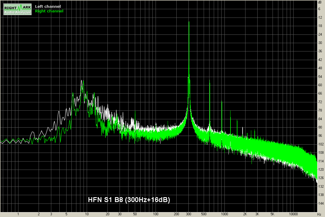

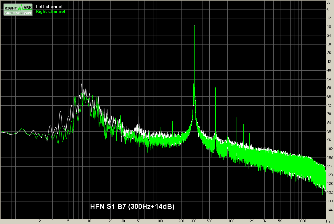

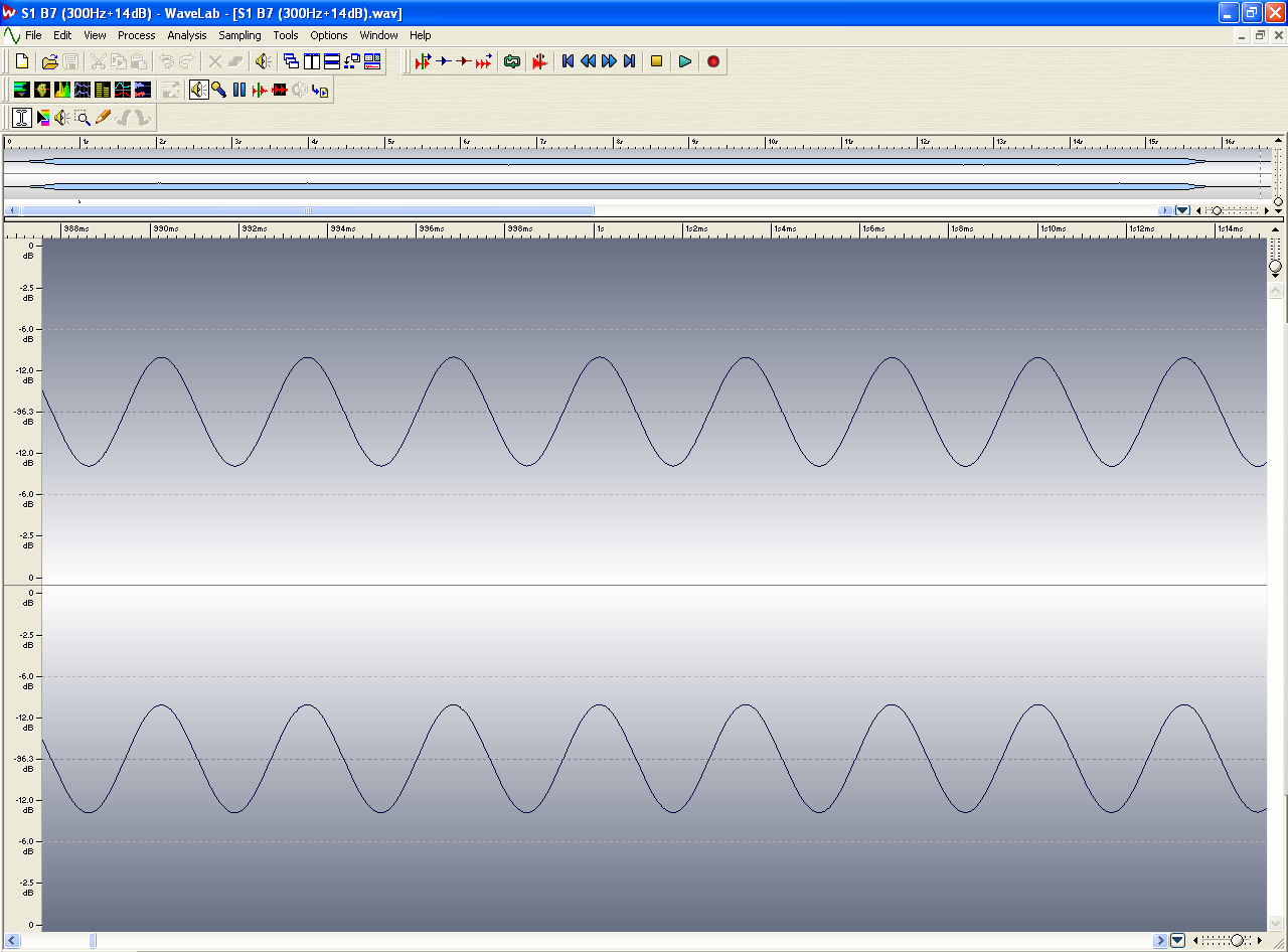

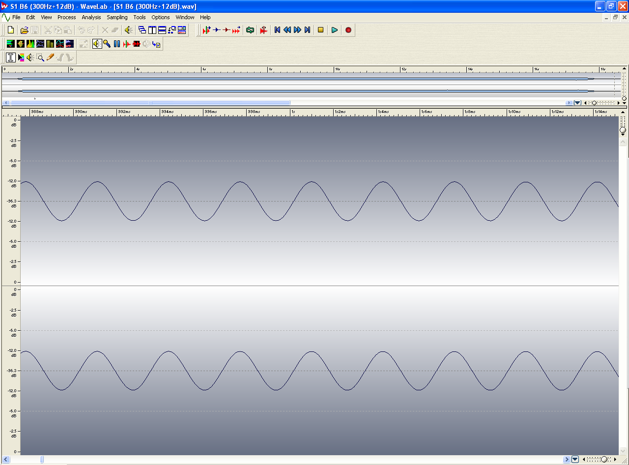

Is there a specific reason why the change in THD after repeated playing is just blamed on the LP.
Can't it be that the suspension of the cantilever is gradually getting different specs when playing a lot in a short time, while slowly restoring back to it's original behaviour when not being used for some time ?
With the Dr. Feickert test LP I get a different FR when not having used my TT for quite some time. Is the cause the LP or the cartridge ?
Since I use this test LP only very scarcely, to me the cartridge seems to be the obvious cause.

I suspect that many of us have thought about the cart and stylus changing, but wouldn't that show (disappear) in the tests delayed by hours? Does it?
An easy way to test that could be to use two identical LPs, one with many plays, the other without.

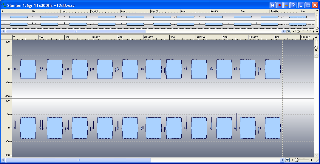

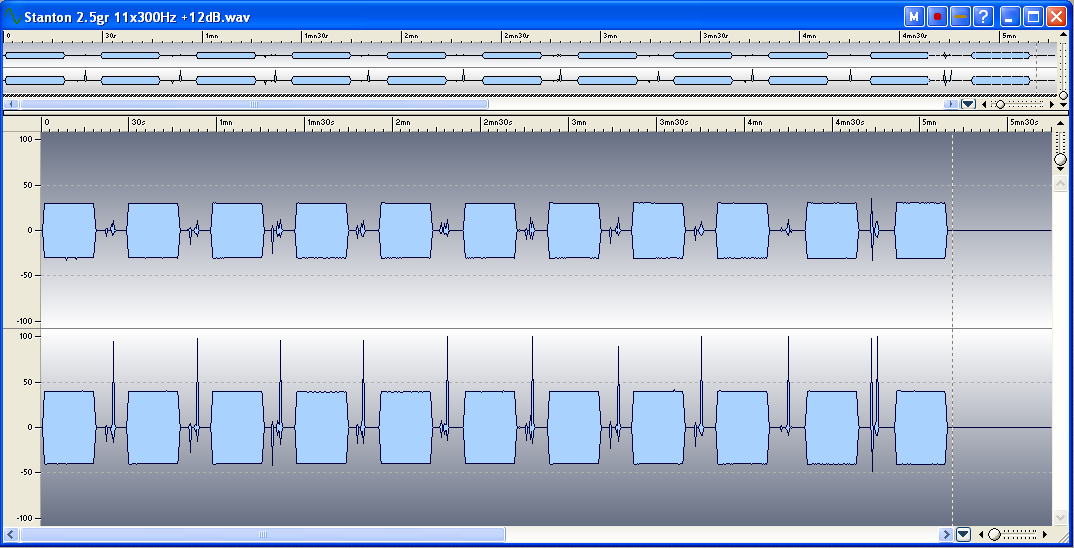

Hi Hans
Yes. This is one of the variables I tried to neutralize, I don’t know how much succesfully.
A played for 15minutes a music vinyl before starting the recording of the 1 to 10 test tracks and again before any delayed playback (leaving out only the 7.5minutes delayed track).
Each 300Hz track was 18.3sec long. Each 1kHz track was 2 minutes long
George

Perhaps a simple way to detect if the it's the vinyl changing or the cart, is to use two carts.
If you do play 150 times with the Shure, record first with the Stanton. After 150 Shure plays, record again with the Stanton. If the vinyl has changed, that change should be recorded thru the Stanton, too. If the Stanton sees no change, we might assume that the Shure cart has changed.
For 300Hz or 1000Hz tones, 48K/24 bit should be plenty good enough.
