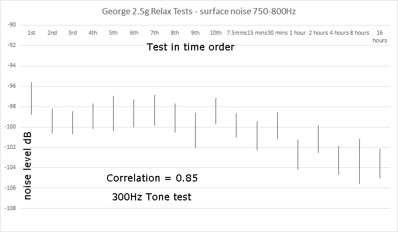

Here's another analysis of George's 2.5g relax tests. This one looks at surface noise level in the 750-800Hz region versus progression of test number/time.
Overall there was a strong correlation (coefficient = 0.85) between reduction in surface noise in the 750Hz to 800Hz region and progressive number of tests/plays. Surface noise reduced by c 4dB over the course of the tests. This change was progressive, but probably to a lower extent for the back-back tests than for the rest time tests which showed a very strong coefficient and significant change.
Given the strong correlation coefficient, there very probably was a real reduction in surface noise with increasing number of tests/plays performed.
I chose the region 750Hz to 800Hz to analyse, for convenience since it was reasonably clear of the test tone/harmonics and because that range is very audible. By inspection, the noise floor in that region generally followed the same pattern of change as much of the audioband in this test.
The error bars shown are +/- 2 sigma.
Anyways, here's the plot. Very interesting, eh ?

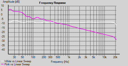

Yes, and in the past I've had pretty good luck with that using HOLM, which is why I thought to try George's sweeps.
FYI, here is how HOLM plots white, pink and brown noise against its own 5 sec log sweep. All noise files 70 seconds in length, 44.1K, 16 bit.

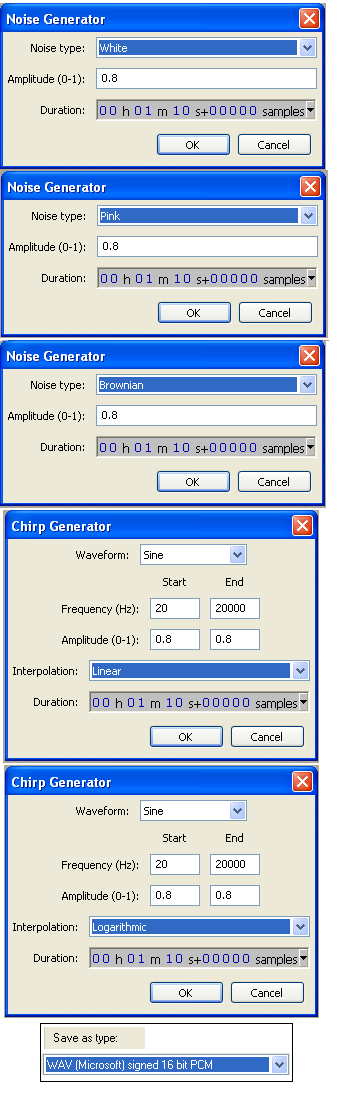

I can't attach them here, too big. Maybe Dropbox. There's nothing unique about them. They were generated with Audacity at the amplitude, length and sample rate desired. In this case 44.1KHz sample rate and 1m10s duration, amplitude 0.8 (default). Saved as 16 bit mono files. Anyone with Audacity can make the same files.

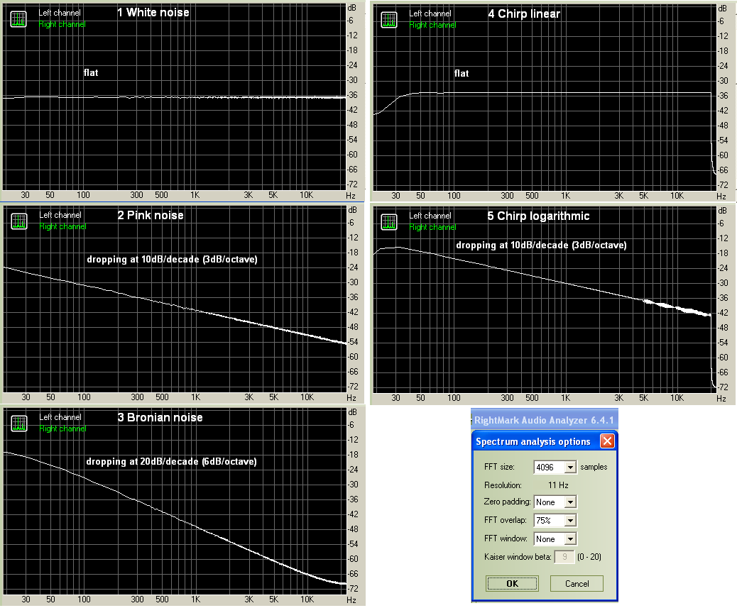

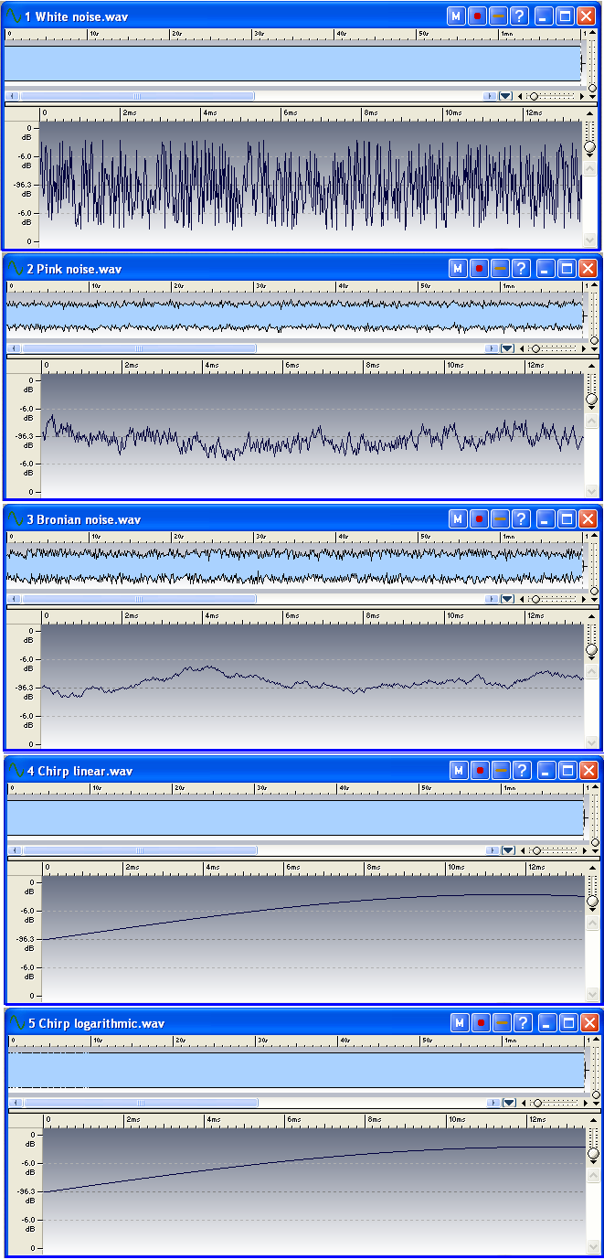

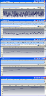

O.K. I did it.
We need a common base to start.
I hope this will ease the communication and help the understanding.
All files generated in Audacity 2.1.0
44.1KHz sample rate and 1m10s duration, amplitude 0.8.
Saved as 16 bit mono files (3087000 samples)
1 White noise
https://www.dropbox.com/s/cp7fgwfczzt82e0/1%20White%20noise.wav?dl=0
2 Pink noise
https://www.dropbox.com/s/a44evzqxysm6gts/2%20Pink%20noise.wav?dl=0
3 Bronian noise
https://www.dropbox.com/s/p9zfyrzerx6ba52/3%20Bronian%20noise.wav?dl=0
4 Chirp linear
https://www.dropbox.com/s/zoay2nqs9j64q49/4%20Chirp%20linear.wav?dl=0
5 Chirp logarithmic
https://www.dropbox.com/s/pt5wf0yqql1n9in/5%20Chirp%20logarithmic.wav?dl=0
George
Yes it is, and thanks for doing that work! But what's going on here? This looks like the direct opposite of what I would expect. Or am I seeing it backward?
You're welcome, Pano, and thanks esp for input to sweep analysis.
Well, something interesting, and very probably real, has been captured, for sure. And you're not seeing it backward !
I agree, the 2.5g results seem surprising/counter-intuitive at face value. However, the point of doing such measurements and analysis rigorously is to be confident in establishing facts/measurements associated with the back-back and relaxation playback tests. Whatever they may be. So I'm confident we are looking at real effects here, and very much look forward to moving on to thinking through and discussing physical causes as soon as the facts are gathered and posted. I hope to complete analysis of George's 2.5g back-back & relax files shortly.

Confirmed. Plotted against a linear sweep, White shows flat, Pink declines.
Makes sense.
Fine. This means that with linear sweep as the reference, Holm is doing FFT and with log sweep as the reference, Holm is doing RTA. At least this is the case with these test files.

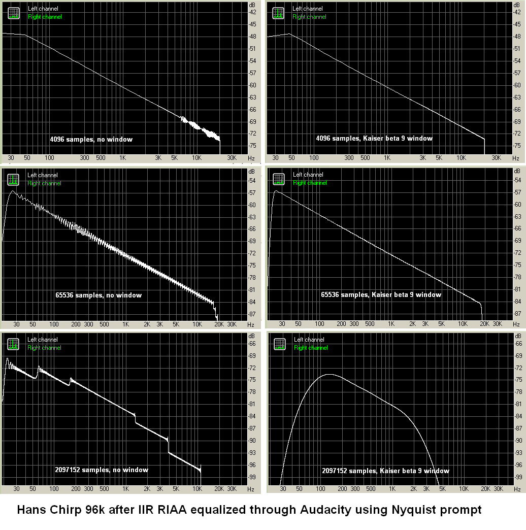

Hi Hans
On the first attachment is the RMAA FFT of your 96k Chirp file.
On the second attachment is the RMAA FFT of your 96k file after IIR RIAA equalized through Audacity using Nyquist prompt :
(biquad-m s 1.315951e-02 -1.273543e-02 0.000000e+00 1.000000e+00 -1.867054e+00 8.674785e-01)
source: Website of Wayne Stegall - Digital Phono Equalization
Compared with what you showed in post #993, I think the RMAA 65536 samples FFT is quite descent.
