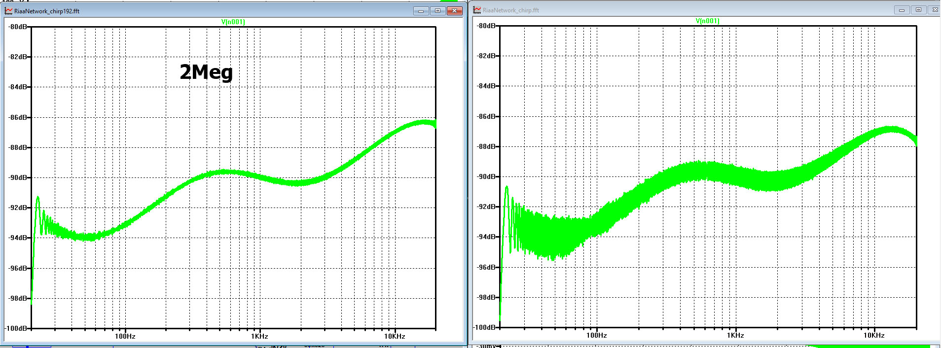

I calculated all values in time for Fs=96Khz and Fs=192Khz, with 10 decimal places.
These time and voltage values were placed in a Wordpad file and imported as PWL file in LTSpice.
In the LTSpice, after the voltage source playing this PWL file, I placed a passive Anti Riaa network, accurate within 0.01dB and with phase errors <0.1degree from 20 to 20Khz.
The output of the Anti Riaa network was converted by LTSpice into a .Wav file.
I do not agree with you that a higher Fs of 48Khz does not make sense for several reasons:
1) The computed FFT spectrum will be multiplied with a sinc function caused by Fs, reducing the amplitude at the high end of the spectrum.
Without correcting this, 20Khz will be reduced at Fs=48kHz by 2.6dB, while at Fs=192Khz only by 0.16dB, possibly leading to false interpretations.
2) Conversion into a .Wav from a PWL file, does not provide the same result for different PWL files.
When creating a PWL file in 192Khz and then producing a 96Khz .Wav file, results in much less noise as when creating a 96Khz .Wav file from a 96Khz PWL file. See both FFT images below.
And when producing a 192Khz .Wav file from a 192Khz PWL file, the Sinc attenuation at 20kHz is insignificant, see image #1046 in compare to the images below.

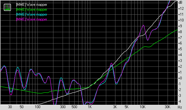

I was curious what different software might do to measure so I looked at F.R. of some sweeps. in RightMark. Hmmm.... Not a flat graph at all. And I know my sweeps are flat because they are computer generated, and they are obvious looking at the waveform.

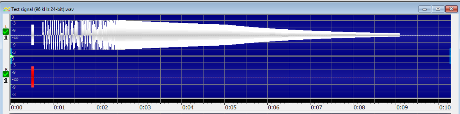

RMAA uses a log sweep of decreasing amplitude as a reference. See the waveform below. Apparently when running a Frequency Response on a wave file, this is the reference. If this file is saved and then loaded, it plots flat (not shown). Flat amplitude sweeps look ramped up. And the vinyl sweeps are just a mess.

How did you manage to extract this log sweep Michael?

Easy. Down at the bottom, the floppy disc icon for Generate/Analyze. It will make a calibration file and a test file.Oh oh!

The attenuation at the high end of spectrum is indeed a windowing artifact, but when not compensated for may lead to false conclusions.This is a windowing artifact.
The noise on the other hand is nor a windowing artefact at all, but is caused by the piecewise linear interpolation of LTspice between the samples. This is not a step by step PCM signal.
When converting into .wav file, a point somewhere on this line is taken, causing an error. Hence, the more points generated, the smaller the error resulting in less overall noise.
I agree when talking about a proper PCM signal that is also corrected for the sinc attenuation, and when a very sharp analogue filter is used after D/A.There's absolutely no reason why a 48kHz fs signal shouldn't be absolutely accurate for stuff that only happens below 20kHz
That's exactly the reason why most current Audio D/A converters do the conversion at 192kHz, enabling the use of a much simpler filter.
Hans

FYI, here is how HOLM plots white, pink and brown noise against its own 5 sec log sweep. All noise files 70 seconds in length, 44.1K, 16 bit.
