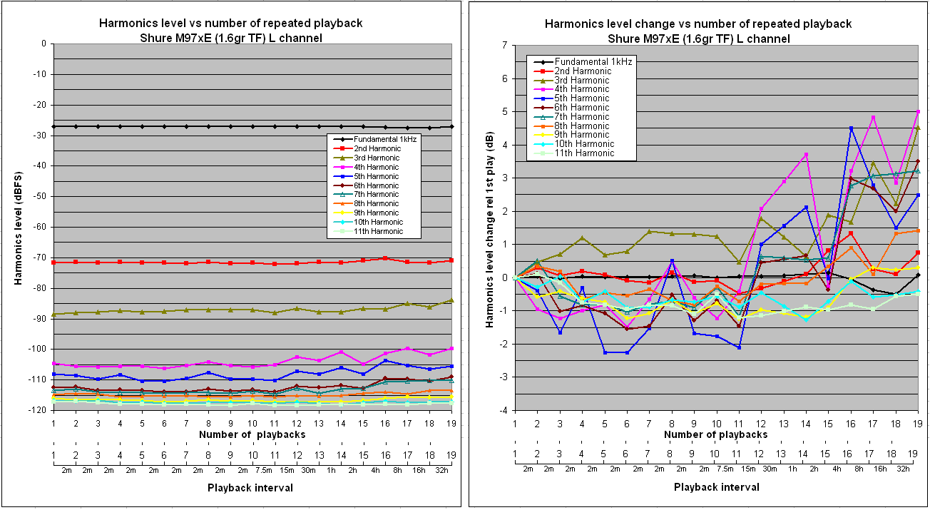

Good Grief George, that's a lot of work!
Thank you Michael.
It was a lot of work, yes. And I failed to notice the 3rd harmonic was missing from one of the diagrams I posted.
I repost the diagrams corrected here.
George
Thanks George. These are for your 1.6g test run, and seem not to show the same correlation I noted for the 2.5g test. But the format is different to mine, so can't be sure.It was a lot of work, yes. And I failed to notice the 3rd harmonic was missing from one of the diagrams I posted.
George
LD
Warning. They are for the 1.6gr VTF alright but not from Stanton reading the 300Hz track.
It's from the Shure M97xE reading (at 1.6gr TF) another track (1kHz tone) from another test LP, refer to post #1019
George
George

Thanks for the last few posts. I was trying so hard to get a clean graph of the vinyl sweeps that I lost track of the subject matter. Basically the Stanton and Shure are flat within the majority of the audio band. Enough said. Watching the harmonics as the track plays is interesting, it mimics George's graphs.
What is facinating is the last round of playback graphs from George. Do these show groove wear in the form of increased distortion, or is it something else?
Enough said.
Next week there will be another round of dealing with freq sweeps😉
I hesitate to discuss it based only on the graphs I posted.
There is a lot of data in these files and there are probably more than one way to say what is going on.
Besides the questions of vinyl wear and recovery are practically important.
Give it some more time Michael. 🙂
George
