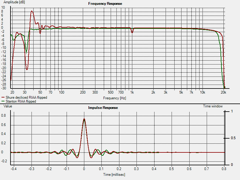

I used HOLMImpulse. It can compare two files to each other, although it isn't always trouble free. I compared George's sweeps to computer generated sine sweeps that I made. But for the graphs posted, George's files were run thru a software RIAA filter to flatten them, which is why they appear flat on the graph.
Congrats Pano!! You've just re-invented Prof Angelo Farina's method 😱
The funny above 18kHz is because your computer generated sine sweep isn't EXACTLY the same as the original.
Notice how 'all' the 'noise' is gone. The 'swept filter' has a bandwidth of 1/18s = 0.055Hz .. but that means it MUST be accurately placed ... especially at HF.
I didn't think one could get results as good as this as I thought wow & flutter would exceed the 0.055Hz bandwidth but George's system must be extra clean. 🙂
Pano, can you post your computer generated sine sweep and details of EXACTLY how you did it?
It is possible that tweaking this would give us good results up to 20kHz. I was going to count zero crossings in the 18s sweep to do a better one. 😀
It may be that we need to use different methods to get the top 8ve 'right'.
But I now don't have to get off my beach bum **** and dream up 2M FFTs 😎

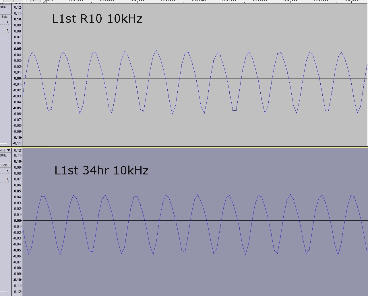

Pano, could you apply your method to George's measurements from #853 please? The differences I expect to see should be at 10kHz too.
One can do a very simple check and balance that confirms there is no meaningful spectral difference at 10kHZ comparing L1st R10 and 34hr files.
Firstly, visually examine the level of waveforms for the 10kHz sine section in Audacity..... attached is a self-explanatory image that is shows no meaningful difference (!!) Sledgehammer isn't needed for peanuts......
Secondly, run a very short FFT, trading frequency resolution for noise and artefact reduction. Reasonably spanning the 10kHz spot section. Difference I obtain is c 0.04dB@10kHz +/- 0.06dB .........

Da beachbum pseudo guru was confused and only noted that the FFTs were wonky.
Ditto, the FFTs led me astray. Should have looked at the waveform. Too much time in the Hawaiian sun will fry your brain.
Thanks, that's what I was figuring. I used several different sweeps to compare, all worked, 10 sec, 18 sec, 21sec, but seemed to be off at the top, as you mention.
One thing that shows up everywhere, even FFT, is the big bump at ~32Hz. What is that? You can actually see it modulate the entire sweep waveform.
It’s one of the artefacts due to the interaction of the vinyl rip file and the stable sinusoidal file you compared it with
(mostly due to phase difference. You can check this out by choosing a slightly different time point to start your reference file. The bump will move in frequency)

I realized that the FR plots I posted are inverted. That's because I was using the vinyl sweeps as the reference, and comparing a perfect sweep to them. So I had to flip the response. See below, as these seem a lot more believable. Still not sure about what's going on circa 30Hz.
BTW, these are 1/12th octave smoothed.

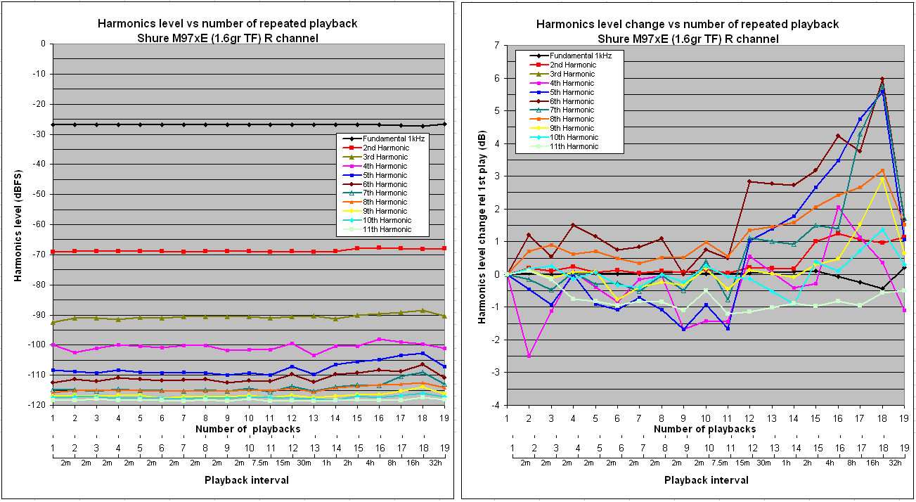

If I will be tempted by the masochistic lust to repeat the test, I will do it with the Shure M97 cartridge reading a 1KHz track from my other test record (UAT).

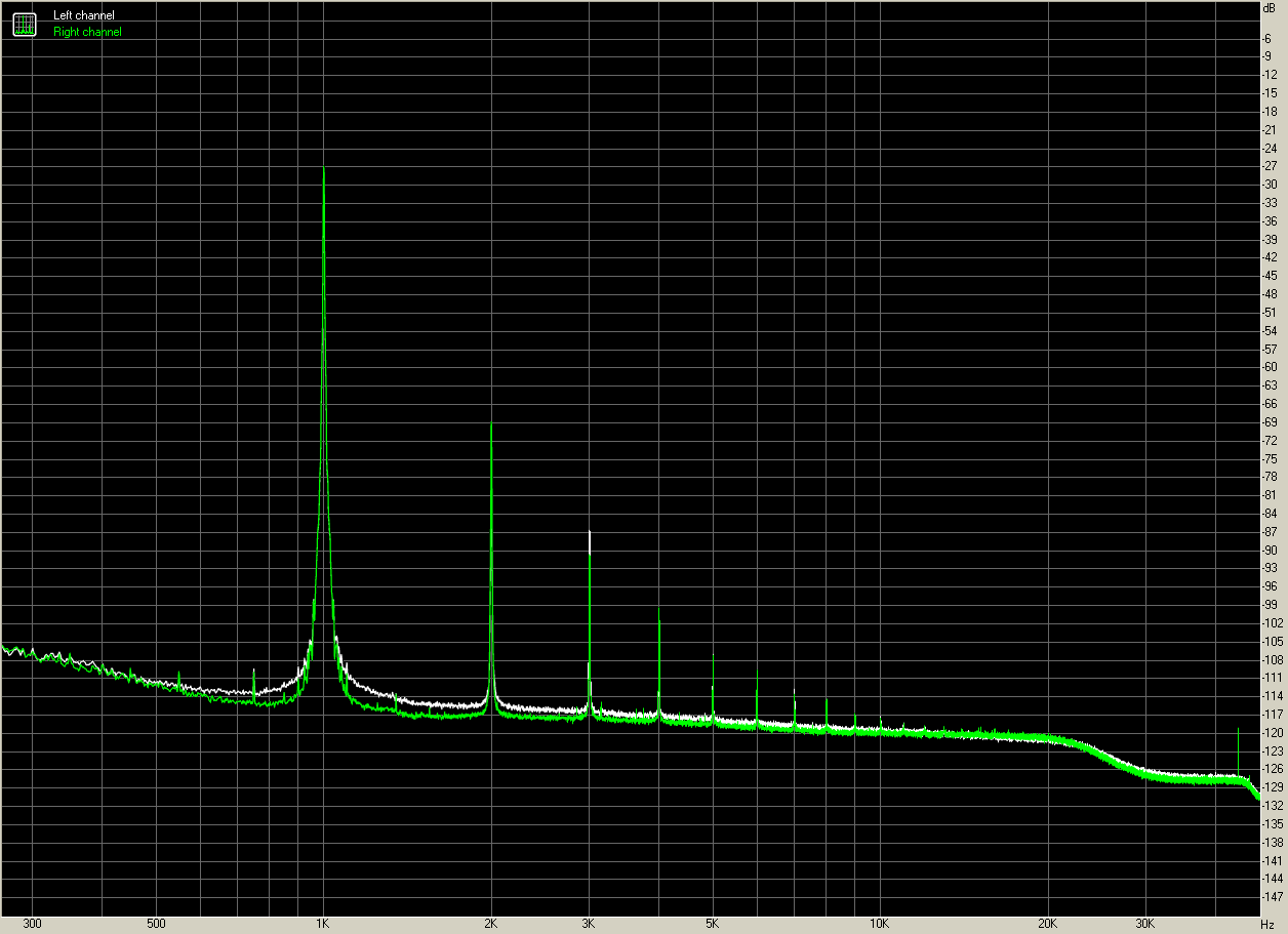

The third and last test run.
Shure M97xE cartridge on Kenwood KD-3100 turntable, to Hagerman Bugle RIAA pre, to M-Audio Audiophile USB card. 24bit/96KHz recordings.
UAT Side 1 Track 1 1KHz @ 7cm/s (2minutes track)
I exercised the cartridge by playing for 15 minutes a music vinyl LP.
Then I played Side 1 Track 1 (1kHz @ 7cm/s ) from “The Ultimate Analog Test LP” for ten consecutive times. Repetition interval 2 minutes.
Then, I played the same track after 15min. and progressively doubling the interval time to 30min, 1hour, 2 hours, 4hours, 8hours, 16hours, 32hours (again exercising the cartridge by playing for 15 minutes the same music vinyl LP).
22.8d Celcius ambient temp for 1 to 15 plays.
22.7d Celcius ambient temp for play 16 (after 4 hours).
22.6d Celcius ambient temp for play 17 (after 8 hours).
23.8d Celcius ambient temp for play 18 (after 16 hours).
25.4d Celcius ambient temp for play 19 (after 32 hours).
Again I used FFT (65536 samples and a lot of zoom-in) to read the peaks from the 1kHz and it’s harmonics on each recording. I entered the data in excel and plotted these diagrams.
