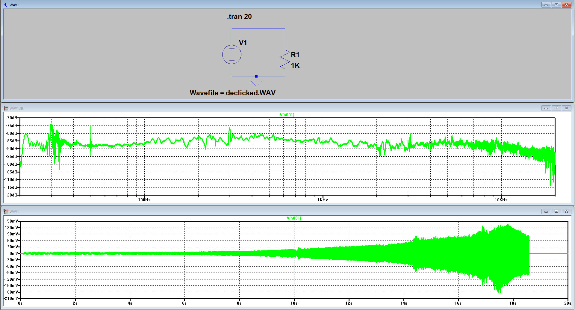

This is close to what I get (1st attachment in post #910, before doing the declicking).
I consider that the FFT shows the track to be flat (no RIAA emphasis applied during disk cut).
What do you think?
Ricardo disagrees with the flat track.
I don't want to put him under time pressure, so let's wait.
George

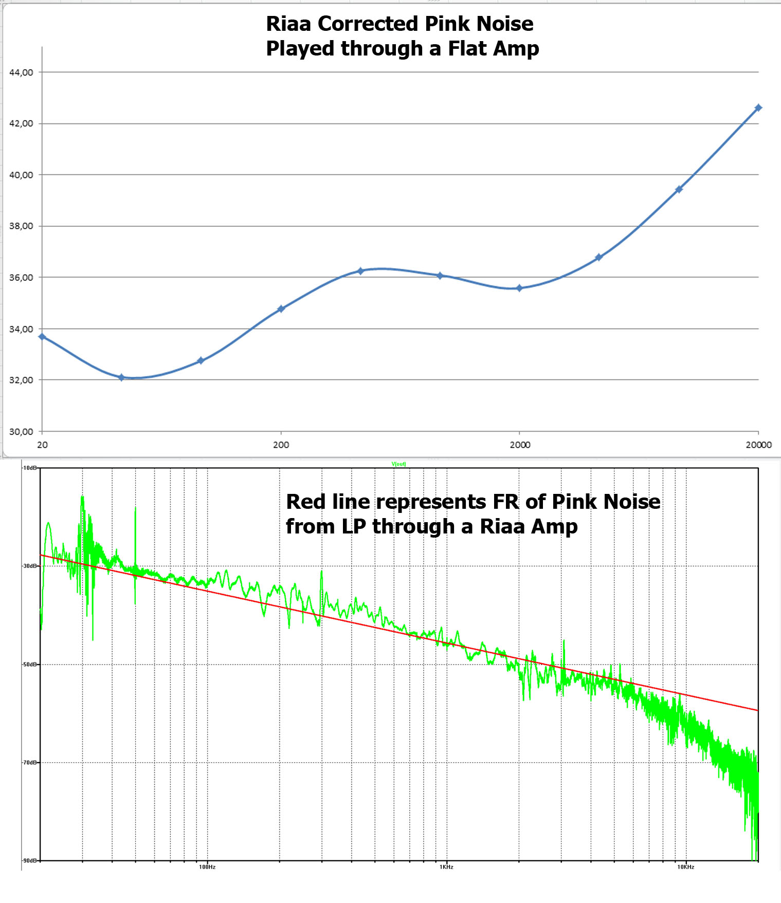

I agree that LTSpice is close to what you got, BUT ...
I als agree with Ricardo that playing Riaa corrected pink noise through a flat amp does not produce a flat FR, see upper image below.
Applying Riaa correction to your recording should have produced a straight 10dB/octave downslope, which it doesn't.
See lower image below.
This just proves that the sweep on your LP (in combination with your flat amp) cannot be used for accurate measurement purposes.
Hans

The track is not pink noise. It is a sinusoidal wave frequency sweep 20Hz to 20KHz.
If the FFT of the flat playback of this vinyl track is the one you showed, the question is: Is this frequency sweep vinyl track cut as flat or cut with RIAA emphasis?
George

George,
I'm sure the sweep is an exponential sweep, giving the same 10dB/8ve downslope as pink noise.
So the verdict stays exactly the same:
From your recordings it shows that you cannot use this LP for an accurate FFT measurement, that's the only conclusion that can be made.
You probably better use pink noise instead of this not so perfect exponential sweep, this will most likely give you more reliable FR results.
Hans

George,
I trust you mean 10db/decade (3 dB/oct)
When this track is replayed through a RIAA preamplifier, the FFT at the output of the preamplifier shows the expected +/- 20dB ref. 1KHz (2nd attachment in post #910) so it must worth something.
Now, where lies the problem ? 😕😕
