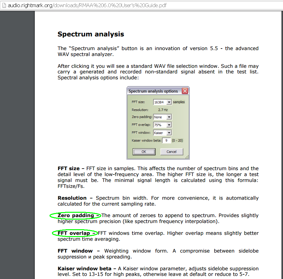

[1] similarly for RMAA 'Zero padding' & 'FFT overlap'

I'm still wary of what it is actually doing.
eg I thought the 'FFT overlap' is 'overlap & save' processing .. a method for small computers to process large files but it isn't.
Similarly with 'Zero padding'. It's not what I thought it was
See attachment. It’s from the manual
http://audio.rightmark.org/downloads/RMAA%206.0%20User's%20Guide.pdf

Thanks George but that was the first thing I looked at.See attachment. It’s from the manual

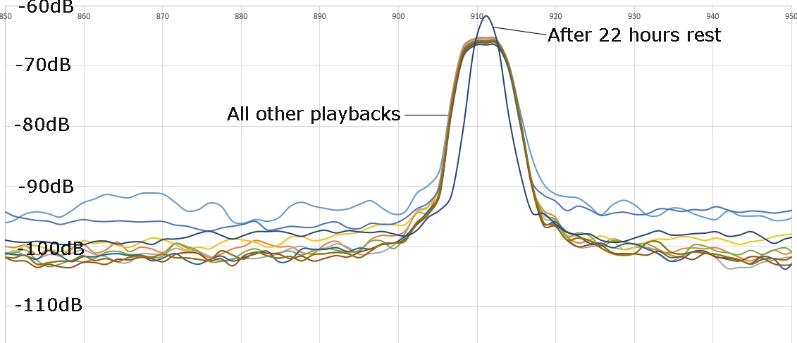

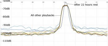

Concerning the 300Hz tone tests, George posted consistently recorded samples of 10 consecutive recordings without rest time, and one recording after 22 hours.
I've now had time to look at these, and here's my 2p worth of interpretation:
The +22hr recording is distinct from the other 10 as to cart-arm low frequency resonance spectrum, which are otherwise all similar. The +22 hr sample is significantly suppressed in amplitude of the cart-arm resonant system, perhaps 3-6dB overall.
This correlates with improved FM stability for the 300Hz test tone in the +22hr sample versus all other recordings which are similar. This is confirmed by improved FM stability in all harmonics of the test tone in the +22hr sample: the peaks are sharper versus all other recordings, and this effect progresses with higher harmonic orders as expected.
Consequently, although peak levels of the test tone/harmonics are generally notably higher for the +22hr sample, eg c +6dB for 3rd harmonic peak level, this is really an artefact of a sharper peak rather than more spectral energy in the harmonic.
Attached is a plot which shows this for the 3rd harmonic, though the test tone and all other harmonics follow the same pattern to and extent that progresses with increasing harmonic order, as expected.
IMO, any differences in peak level of harmonic distortion in the +22hr sample are dominated by expected artefacts of improved FM modulation, probably arising from improved headshell lf stability.
A very interesting question is why was the +22hr sample more lf stable than the 1st sample, which presumably was also recorded after a long rest ? (George, can you please confirm the 1st sample recording was also made after a long rest ?)
A distinct feature of the 1st sample is that the noise floor is significantly adverse, perhaps c 6dB or so. Whereas there is some variance between all other recordings, including the +22hr sample, the 1st sample is quite separate.
So I think there are two confident differences observable from George's test: a) improvement in low frequency stability after 22 hours rest and b) adverse noise floor in the 1st sample recording.
OK, so now perhaps it's a case of head scratching to try to work out physically what might be going on as to a cause........... which might be experimental or might be real I suppose ?!
Thanks Lucky for taking the time to work on those files.
Now regarding your question about the long rest.
As I have mentioned, before the 1st playback as well as before the after 22h playback, I exercised the cartridge by playing for 20 minutes a musical record.
So it is only the 300Hz track of the HFN test LP (and not the cartridge/headshell) which had a long rest before the 1st play back and before the +22 hours playback.
And this was intentional, as what I wanted to test with these recordings is the behavior of vinyl only (what Ricardo has mentioned) i.e.
a) that vinyl playback is not the same btn 1st and second play of the same track
b) vinyl needs a lot of time to recover after the 1st play (he mentioned 24 hours).
The hypothesis of vinyl relaxation time is to be tested more methodically in the second run of recordings (this with the 2.5gr VTF, see post # 918 for uploaded links) where after the repeated 10 playbacks each 30 sec apart, I do subsequent playbacks after 15 minutes, then after 30 minutes from the previous, then after 1 hour, 2 hours, 4 hours, 8 hours and 16 hours.
Before the 1st play and every delayed replay after the 10th, I played for 15min the same musical record. I placed (stacked) the musical record on top of the HFN test LP, so in all these recordings the HFN test LP remained in the platter unmoved.
In the first run (1.6gr VTF) and in the second run (2.5gr VTF) the same setup was used (test track, TT/platter mat/tonearm, headshell, cartridge (Stanton MKV D5), wiring, preamplifier, soundcart, PC notebook, recording SW).
These days I will conduct a third run (1KHz track from another test LP, another headshell and Shure M97xE cartridge.
