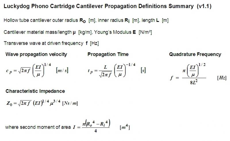

Equally, I would appreciate anyone’s thoughts on transforming a cantilever with distributed compliance and mass into an analogous transmission line with distributed inductance and capacitance.
Here's a repost of TL equations for a cantilever as I derived them a few years back, in terms of physical dimensions and material properties. Note the mechanical transmission line is dispersive - so you'd need to model it with a TL model of appropriate group delay.

6. Apologies for hijacking this thread at such length. I shall now return to lurking, with hopes the discussions will continue. There’s much to be learned about these confounded talking machines.

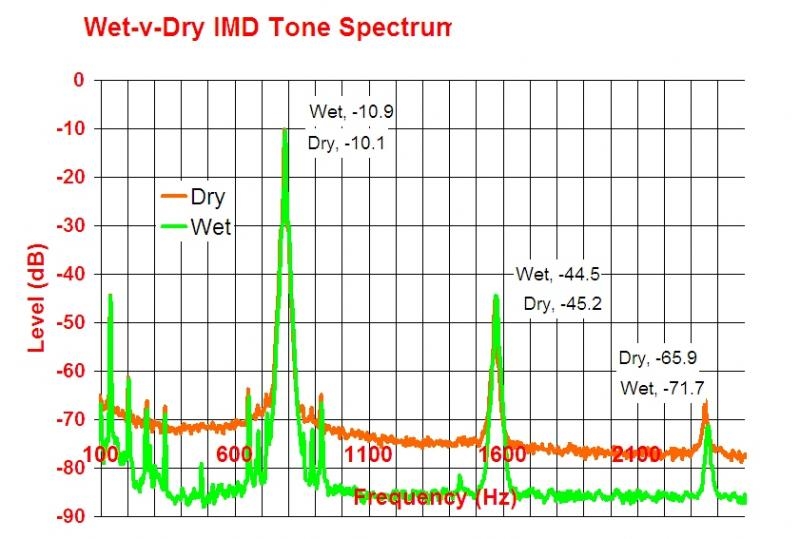

I think there's a chance of tying up a few loose ends, such as how does wet playback work, which immediately seems to apply.
BTW, I noted from my tests a time back that 3rd harmonic distortion can be suppressed by wet playback, but I never understood why. Perhaps there is a connection, further to Scott's questions and the suggestion that 3rd harmonic distortion might be a marker for flex?
You need to be careful of concluding the reduction of 3rd is due to wet play.
It's there with dry playback and supressed in wet playback, reversibly and consistently IME.
The SHURE seminar web page has experimental data on repeated playing with different stylii including some cases where THD reduced on subsequent playings.
If it's the one I'm thinking of concerning effects of 100+ plays on wear versus stylus profile versus VTF, the results are all over the place, and IIRC Shure pretty much said as such in the paper. Could be related I suppose........but in any event, that is very different from my tests for wet playback.
I found an example of 3rd harmonic suppression with wet playback, attached below, from my tests some time back. The x axis appears to be mislabelled, but one can get the gist I think.
