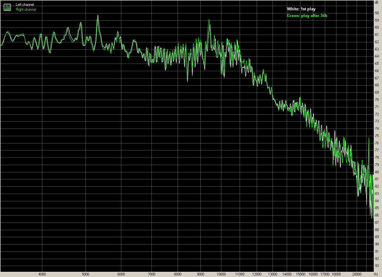

Tonight or tomorrow I will record the 24h+ delayed one
I replayed that track 34h after the last play
>Edit. The ambient temperature during that play was 23.3d Celcius.
here is the wav file (L channel 1st play, R channel play after 34 hours)
https://www.dropbox.com/s/ooga2pzt1no9270/L1st%20R34h%20later.wav?dl=0
George
Thank you for doing this George. The recordings are remarkably consistent, which suggests good method for sure.I replayed that track 34h after the last play

A swift FFT, looking at channels separately, and I see no meaningful difference between the two recordings of playback separated by 34 hours. Any differences appear within normal Gaussian noise limits, and no trend within a bracket of +/- 0.3dB IMO.
I think this is no surprise, because IMO an f response sweep probably wouldn't show the effect Richard is looking for, which probably doesn't exist in any event.........

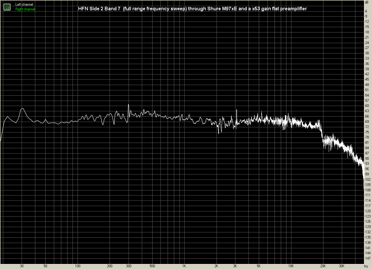

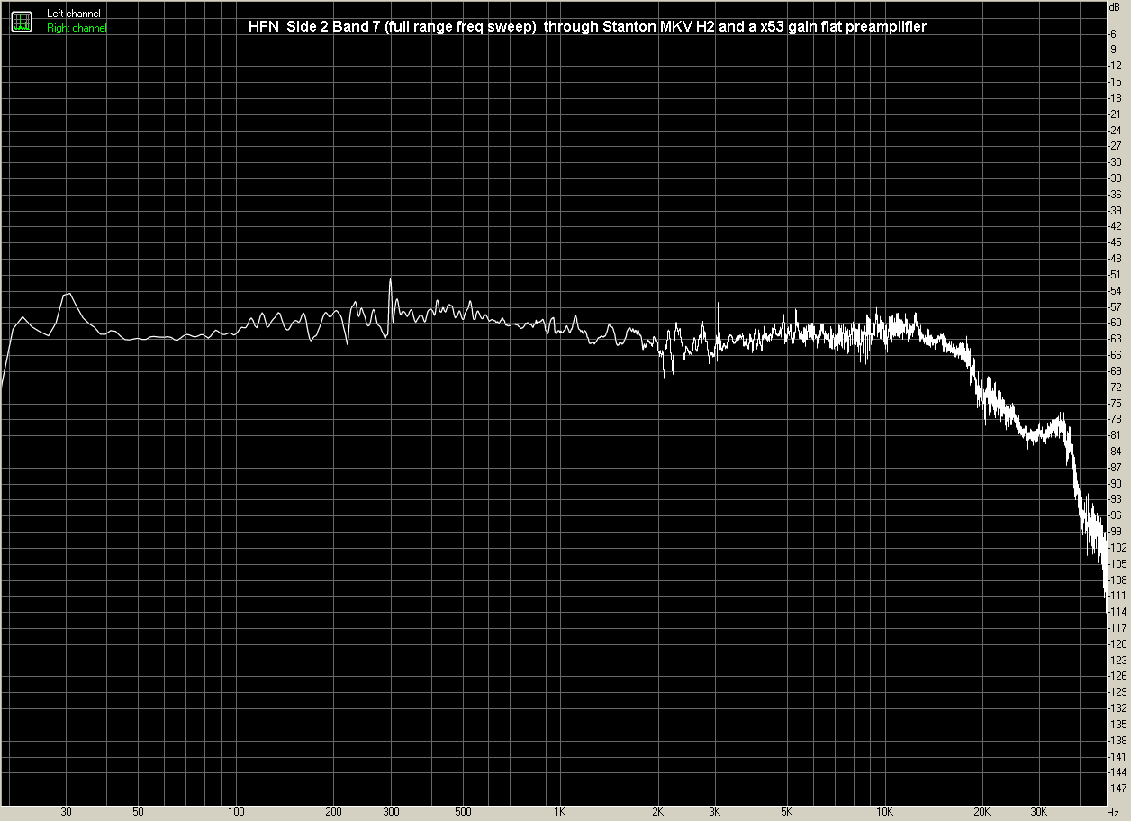

Stanton MKV H2 cartridge on Kenwood KD-3100 turntable, to Hagerman Bugle RIAA pre, to M-Audio Audiophile USB card. 24bit/96KHz recordings.
22d Celcius ambient temp (+/- 0.1).
FFTs (4096 samples) zoomed in the range 3KHz to 22KHz
Then I played Side 2 Band 7 (full freq sweep ) from HFN Test LP for ten consecutive times. Repetition interval 40 seconds.
Then, I played the same freq sweep track after 2h 45min.(again I had excercised the cartridge by playing for 20 minutes the same music vinyl LP).

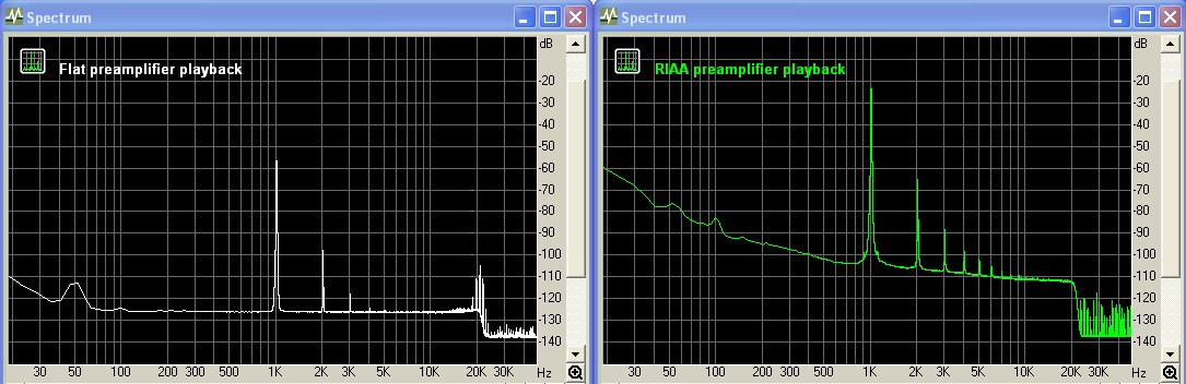

What is printed on the vinyl in this track is flat, no RIAA emphasis. See attachments from flat playback.
George
Regarding Scott’s and Lucky’s comments on distortion measurement as more appropriate way to check for vinyl distress due to repeated playback, I’ll try it with single frequency tracks, although I expect the effects will be really minor compared to the distortion quantities already present on a single play.
I would love to see an FFT from a laser playback system of a single tone test track. This would show us how much distortion is attributed to disk cutting alone.
George
George
Thanks George.Not a specification but this is what they report: "Full range frequency system check (20Hz -20KHz L+R)"
I'm suspicious that your 2 attached thumbnails are both roughly 'flat'. They should differ by the RIAA EQ.
What is the software doing the FFT? ARTA? What size?
I suppose what I'm saying is I don't think you can use a 4096 pt FFT to make sense of a sweep which is 1M8 long
We need to sort this out if we are to use these measurements to dream up a digital EQ ... or decide if "meaningful deformation can exist at all in the dynamic case at hand" Just the practice will do. Theory has to explain practice .. not the other way round 😎

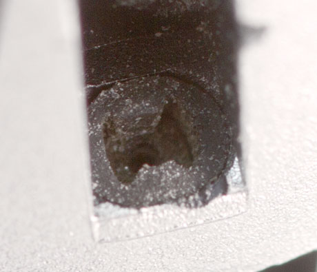

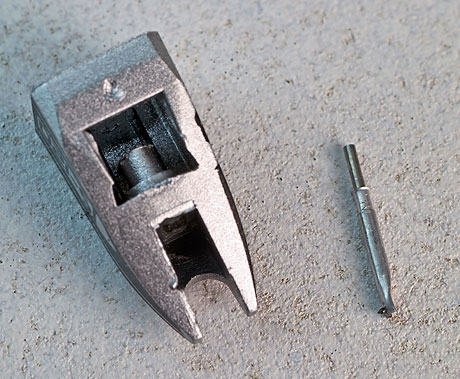

Whilst digesting Bondini's post I was left last night wondering how Ortofon do the damping on their MMs. They have a fancy 'wide range damping' setup on their MCs with a platinum washer and two rubber donuts. So did some googling.
First pic shows one of the DJ stylus assemblies. Second shows a shot into the suspension of this. This nicely shows the asymmetric suspension that LD has mentioned and I want to use as the basis of frankencartridge. Behind that you can see a second rubber ring that the moving iron slides into, which I assume is for the damping. This does mean that, for those who have access to a technical rubber lab you could adjust that to suit...(note not me)
On cartridges without a tie wire ... certainly the ADC XLM/VLM/ZLM variants and apparently the Ortofon MMs ... the hole size in da bung is similar for many of their expensive cantilevers as for their cheapo DF versions. (Please check this. Don't take my word for it before taking your $$$ cartridge apart. )Whilst digesting Bondini's post I was left last night wondering how Ortofon do the damping on their MMs. They have a fancy 'wide range damping' setup on their MCs with a platinum washer and two rubber donuts. So did some googling.
This means us mere mortals can easily do a cantilever swap without damage. If you put a state of the art, low tip mass cantilever, into a stiffer bung (below 20cu), you will find the 'first resonance' moves even higher in frequency (compared to the original low tip mass cartridge) with corresponding improvements in HF trackability .. which was my main concern.
The cartridge will be better suited to other than ultra low mass arms. LF trackability will be reduced but this is always ample in modern cartridges. The lower compliance allows a higher tracking weight too.
BTW, this isn't theoretical pontificating but experimental evidence. The scientific method requires theory to fit evidence .. not the other way round.

If you mean the V15-4 in Fig 10 of Design Considerations of the Vl5 Type IV Phonograph Cartridge - L. R. Happ fromBut the bit I am not sure about is that the shure setup is 2 bungs. so In theory you can mess with compliance and Damping.
High Fidelity Phonograph Cartridge - Technical Seminar | Shure Technical FAQ ..
there isn't actually a 2nd bung.
The 'damping' is actually a lump of rubbery goo stuck on the end of the magnet. The stylised representation is Fig 10 in
