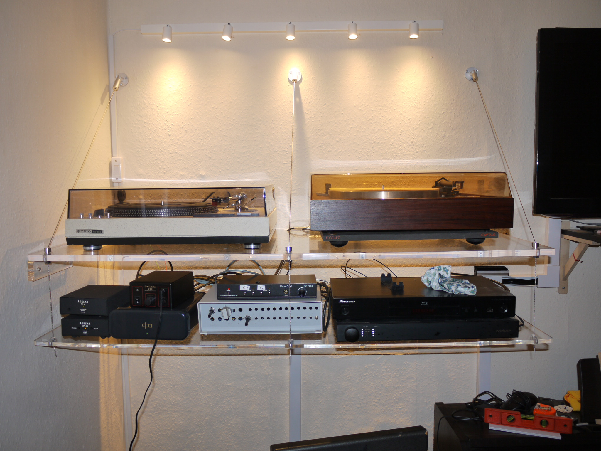

Back on bungs, as they are causing me concern, not least as I'm going to start swapping them. I've started researching MM/MI construction techniques as I've not considered them much until recently and also it's fascinating to look at the trade offs. So far I have divided them into 'front wiggle' and 'rear wiggle' to group them according to where the bit that messes with the coils is. Grado and AT are both front wigglers. Ortofon is a rear wiggler and has 2 rubber donuts, one as the pivot and one as the damper. Now what I can't decide is if this is a genius bit of design, or just something optimised for pumping them off the production line. Or maybe both. Looking at AT who have a steel suspension wire and a teeny 'compliance adjustment screw' that can't be as easy to make?
Also some (slow) progress made and the experimentation turntable is serviced and ready for action. Haven't yet dared tell the wife it's older than her 🙂
