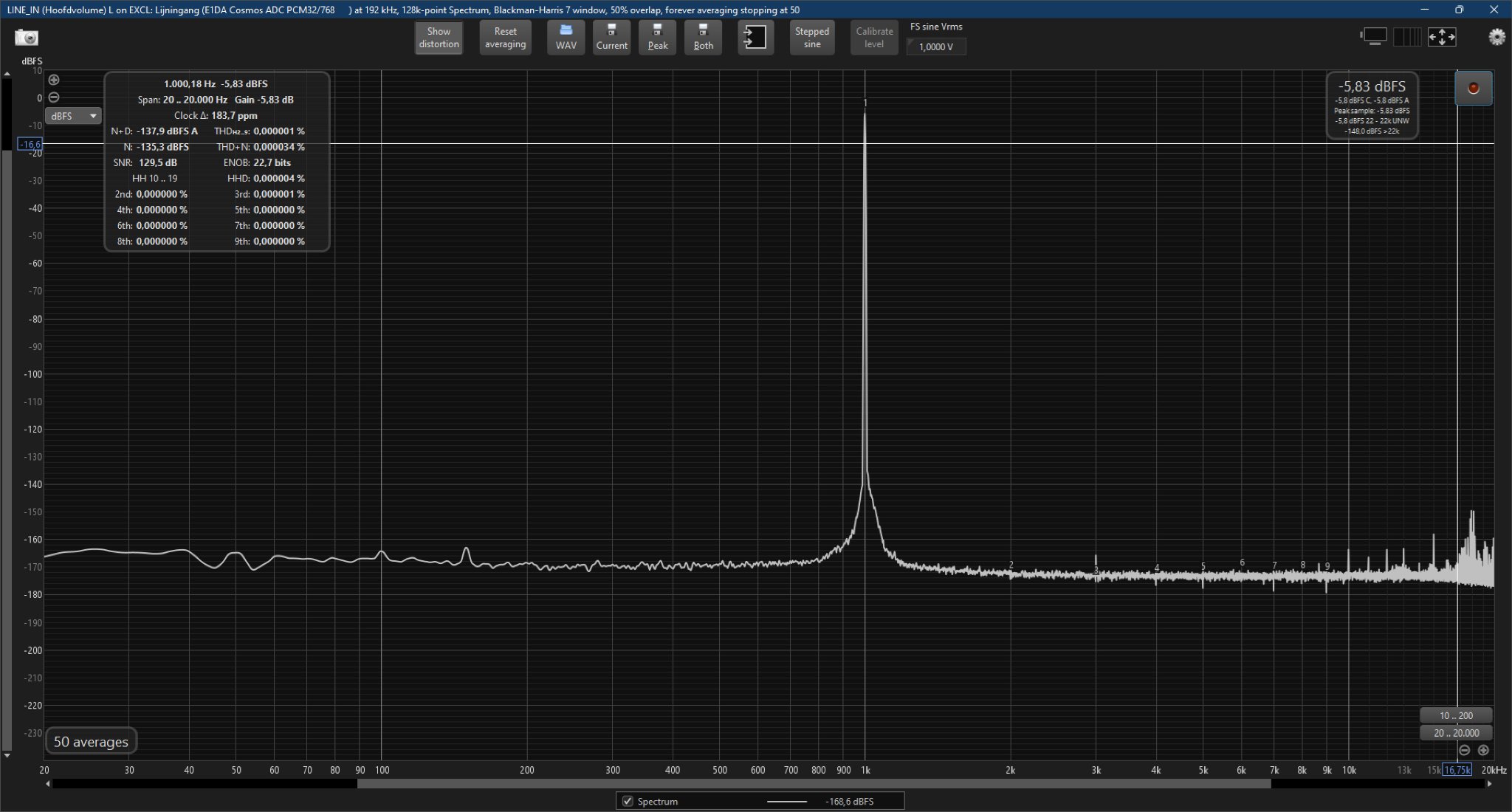

Impressive performance. Do they have a box that has both ADC and DAC where the clock is shared between the two? It's advantageous to have them on the same clock as the FFT is sensitive to clock wander.Tom, any thoughts about cosmos adc. Cost 230 euro.
Tom
The ADC has a firmware option to put out an SPDIF signal on a pin, which then can be used to sync a DAC like ADI-2 Pro.Impressive performance. Do they have a box that has both ADC and DAC where the clock is shared between the two? It's advantageous to have them on the same clock as the FFT is sensitive to clock wander.
Not ideal, but better than nothing for now.
I would think sooner or later @IVX, will offer an integrated DAC+ADC device running from the same internal master clocks, as this is really important for a lot of measurements.

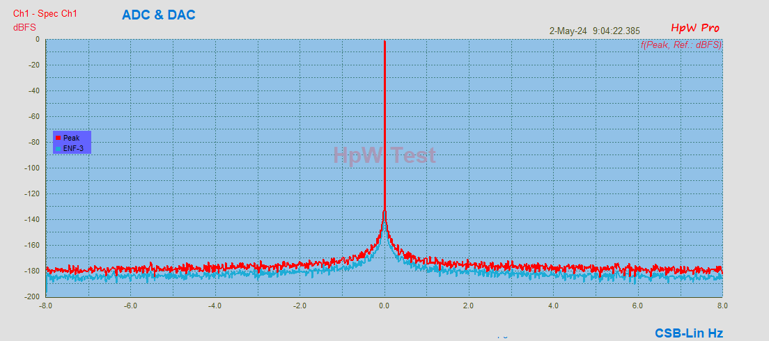

Well,
You mean coherent measurements. Even here the the master clock changes within the sample time and FFT & FFT Window may hide here the issue too.
So it will show the inherited performance of the two (ADC & DAC).
RME showed on an early doc, as on real, where NONE coherent measurements where used as two independent HW as one ADC the other DAC.
Bee just surprised how crappy clocks will perform.... sometimes, for reference purpose, a low performing is used 😀
Attached a later measurements to beet as using costume made ADC AK5572 & DAC AK4493 using coherent MCK clock 😀

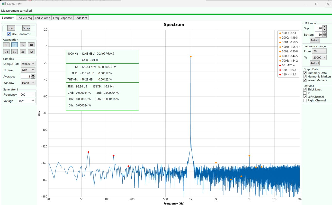

Hey @tomchr
You might take a look at this program I'm working on. Compared to the stock app, well...
See: https://github.com/MZachmann/QA40xPlot
If I had a QA403 I'd take a look. I sent it back to the owner. Below are my comments based on the screen shot.
First impression: Much cleaner than the stock app. Nice work!
I would suggest a single sweep tab where you can select if you want to sweep frequency or amplitude. What's the difference between Freq Response and Bode Plot? As far as I'm aware, Frequency Response = Amplitude Response + Phase Response. A Bode plot is a piece-wise linear approximation for these.
If you prefer to keep it as-is, I suggest capitalizing THD as a minimum. FFT is capitalized as well. It would also be nice with Amp(litude) and Freq(uency) spelled out. I'd also spell out the window functions. Does it add that much to add 'ing' to Hanning? We're not in the 80s where every bit and every pixel counts.
I would rather have a dropdown menu for the attenuation. What does the current format add?
I'd argue it should be Amplitude rather than Voltage for the generator setting. Indicate the units either Frequency (Hz), Amplitude (V) or add the Hz and V after the input field. Why are those drop-down menus?
How about Y-axis Range (dB) instead of "dB range"? Why are the end points for the frequency axis drop-down menus? Shouldn't they be text/number entry fields?
Some may argue that I nitpick, but I think the precision of the instrument should be reflected in the precision of language used in the software.
I think it's a big step in the right direction, though.
Tom
