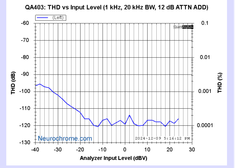

I see in your plot the x-axis is input level. Is there an explanation for why it increases rapidly below about -15 dB? Is this generator or A-S related?
I'm guessing the "it" you're referring to is the THD plotted on the graph. I'm thinking the harmonics are below the noise floor up to a generator level of -15 dBV, so the QA thinks the noise is harmonic distortion.
An unfortunate thing about how the QA measures distortion is that it uses the FFT but does not use averaging, so the noise level can be a bit high in the measurements.

Definitely THD only!
Re the averaging, can you not set it in the PC dialog? I can set it on the 401 from 1 (no averaging) to 50.
