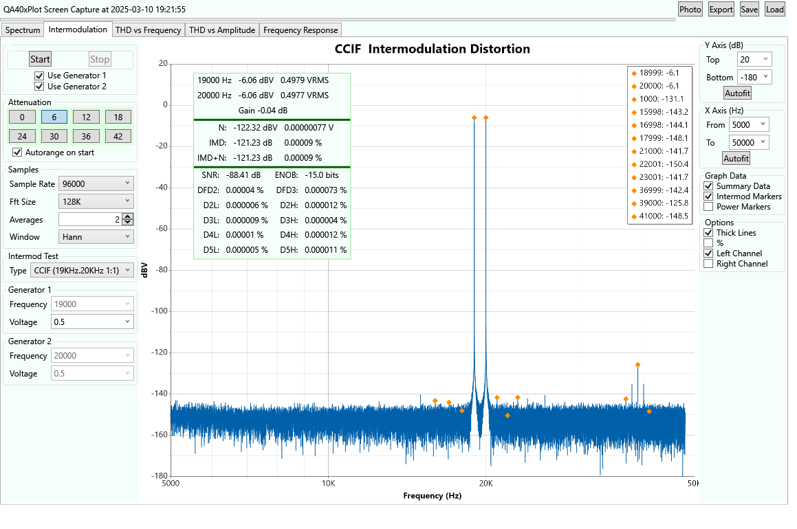

Ah, also, all the frequency entries (and many voltage entries) are currently editable dropdowns. The IMD photo on github (and below) is the only 'current' image and it shows that I totally agree. And I know Hann is a crappy window for IMD but the stock windowing choices are pretty bad.

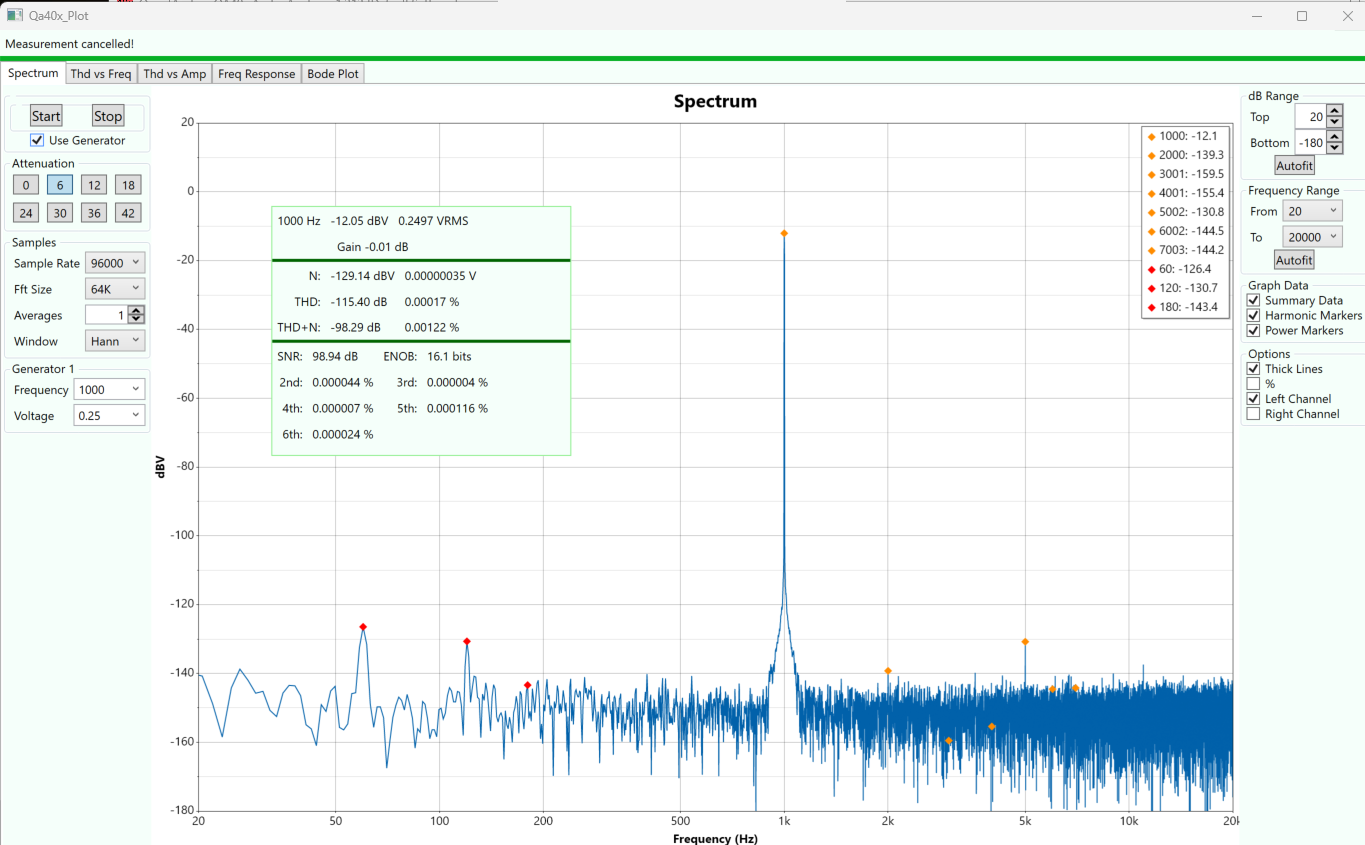

You might take a look at this program I'm working on. Compared to the stock app, well...
See: https://github.com/MZachmann/QA40xPlot

BTW it would be nice to have two modes, line spectrum (dBV) and noise spectral density (i.e. dB(V/√Hz)) - or at least display the conversion factor (which depends on sample rate, FFT points and window function).

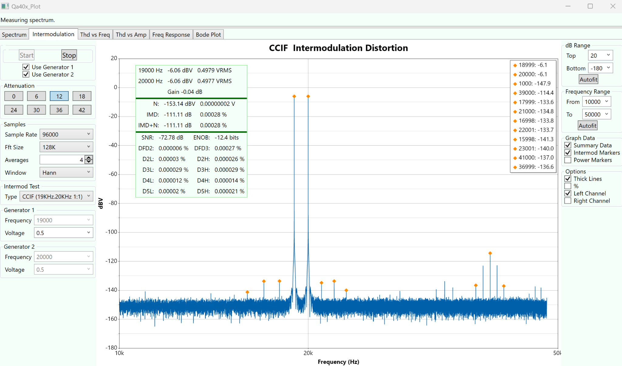

I kind of like having the two tabs because each tab retains its settings while you're working.
That's a really good point, actually. That's actually something the APx500 software does not do. Not in Bench Mode anyway. It's not a major annoyance as it's actually pretty rare that I sweep vs frequency, but if you have to switch back and forth it's annoying to have to reenter the sweep settings.
Also the amplitude sweep does some cool auto-ranging as you run it whereas the frequency sweep doesn't.
Why not? What if you're measuring the amplitude response of a filter? It'd then be rather handy that the analyzer did the auto-ranging so you could get precision even as the filter starts to attenuate.
I thought about a dropdown for the attenuation, but as the only 'dangerous' setting and one you use all the time I don't mind it as a few obvious buttons - especially when the bottom row are voltage attenuated and all my usage is on a touchscreen. I could add a dropdown. Hmmm.

1) "I kind of like having the two tabs because each tab retains its settings while you're working." Yeah, in addition the settings are saved for both tabs when you save settings so it's like a bunch of different test instruments simultaneously.
2) "for the attenuation, but as the only 'dangerous' setting " - it's dangerous because there's a chance of frying the input caps if you set it to 0 (or any top-row attenuation) by mistake with big amps (I was just testing a 200-300WPC class A last week). I've done this twice and luckily it's ok if you react quickly. For serious testing I run on a small tablet with a small display and it's tough to quickly hit a combobox, pull it down, and quickly tap on the right value. Buttons are no issue. I am tomorrow, however, adding an "Automatically set at start" button to the group of radios so in practice it should never get manually set.
3) "be rather handy that the analyzer did the auto-ranging so you could get precision even as the filter starts to attenuate." The frequency sweep does autorange once so it's not "cool" because it's a single voltage value. Having it work correctly for the whole f range is a neat idea. I can do that...
