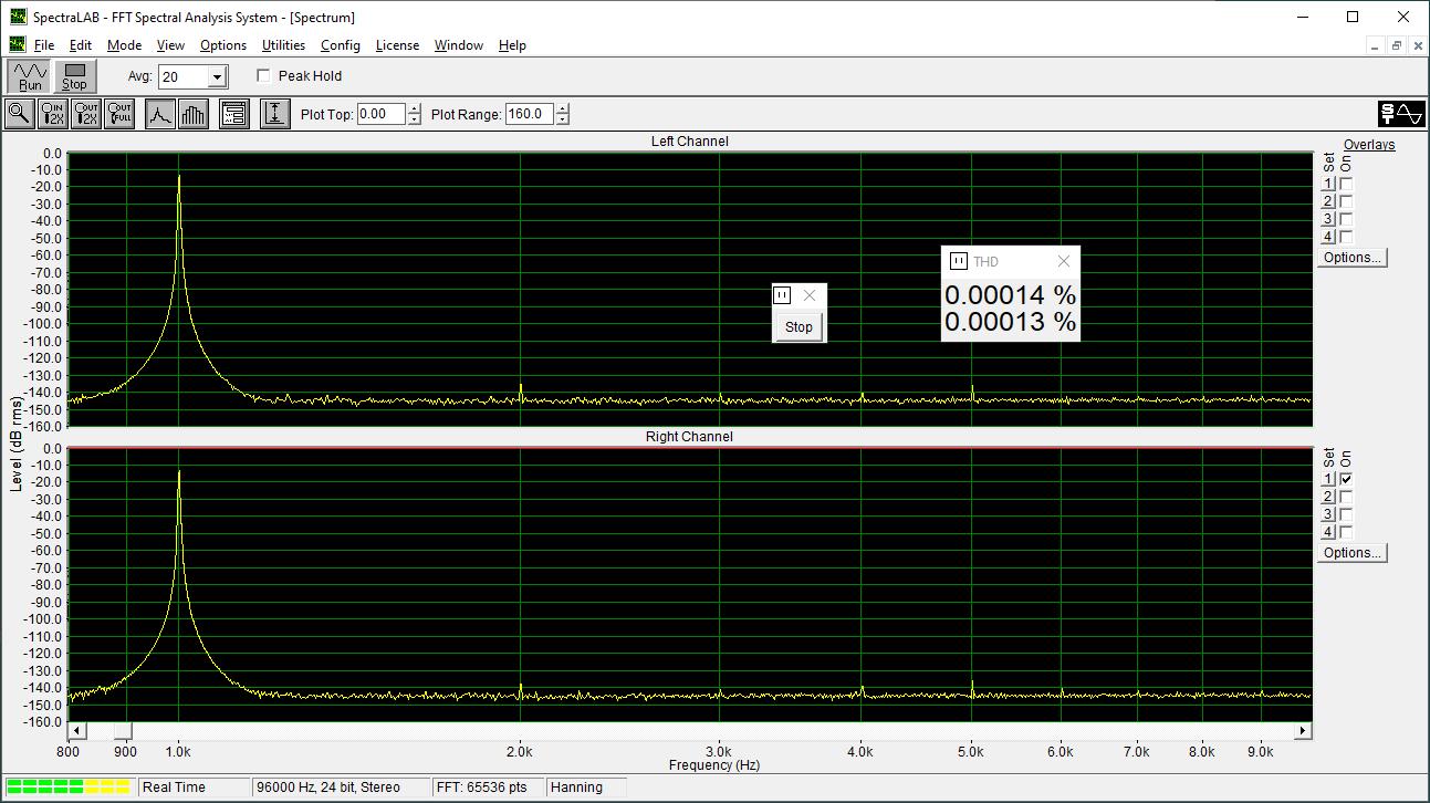

This is my solution for Measuring Distortion on the Cheap:
I modified the Sound Blaster X-Fi HD (SB1240) sound card. Replaced the Cirrus Logic CS5361-KZZ to CS5381-KZZ ADC chip, it is pin compatible. Next I replaced the TI MC33078 dial operational amplifiers in the recording path to OPA1656. I replaced the reference voltage filter capacitor of the ADC to bigger (can't remember the value). Then I bypassed the ISL54405 analog switches from the RCA inputs to the opamp inputs by 33uF/50V capacitors. This way I lost the MIC and Phono input functionality, but I use just the Line input anyway. The optimum input level (lowest THD) was found 200 mV, overload limit 440 mV. Probably I have to build a passive attenuator for measuring higher level signals. See loopback measurement.
