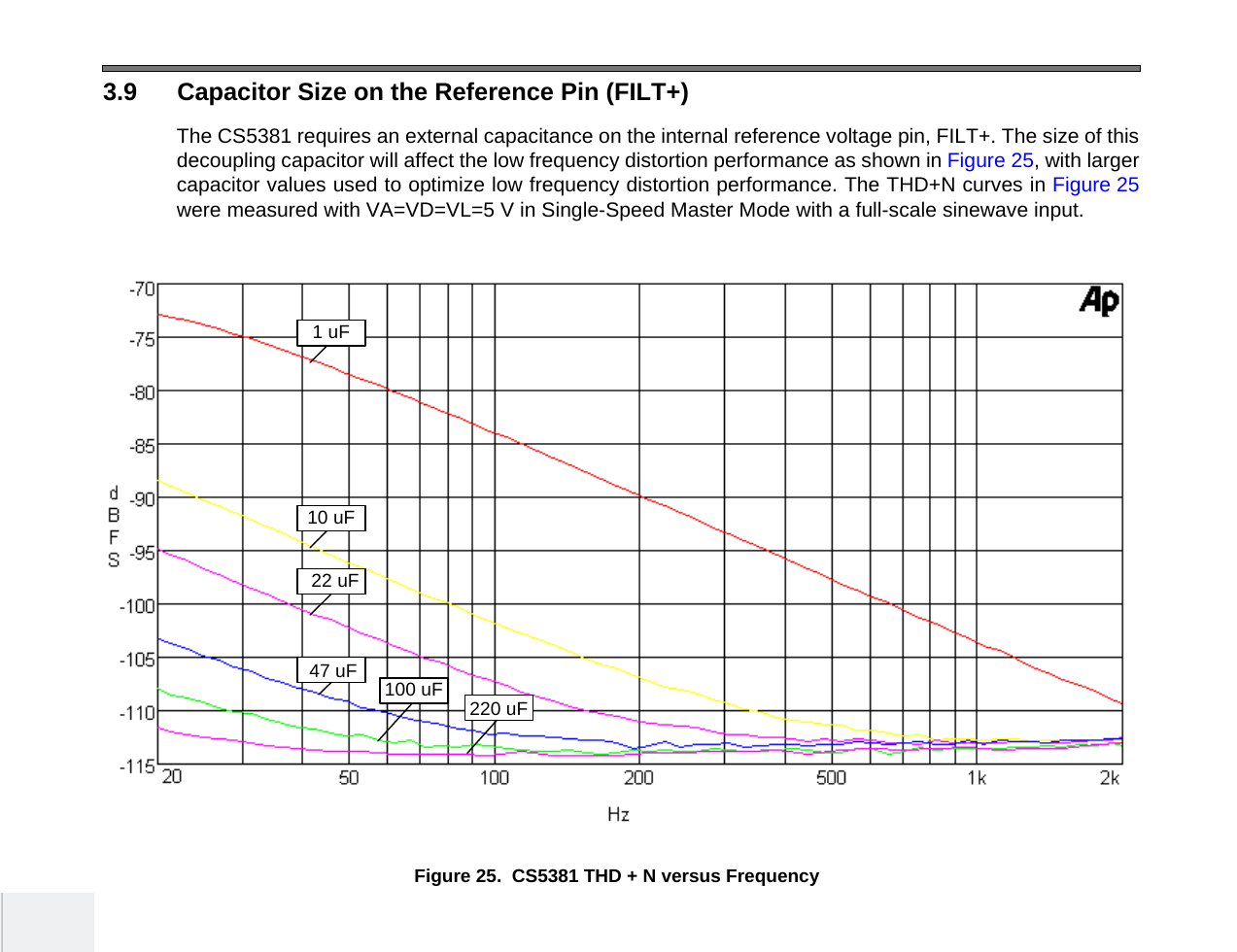

I replaced the reference voltage filter capacitor of the ADC to bigger (can't remember the value).
From datasheet:

This is my solution for Measuring Distortion on the Cheap:
I modified the Sound Blaster X-Fi HD (SB1240) sound card. Replaced the Cirrus Logic CS5361-KZZ to CS5381-KZZ ADC chip, it is pin compatible. Next I replaced the TI MC33078 dial operational amplifiers in the recording path to OPA1656. I replaced the reference voltage filter capacitor of the ADC to bigger (can't remember the value). Then I bypassed the ISL54405 analog switches from the RCA inputs to the opamp inputs by 33uF/50V capacitors. This way I lost the MIC and Phono input functionality, but I use just the Line input anyway. The optimum input level (lowest THD) was found 200 mV, overload limit 440 mV. Probably I have to build a passive attenuator for measuring higher level signals. See loopback measurement

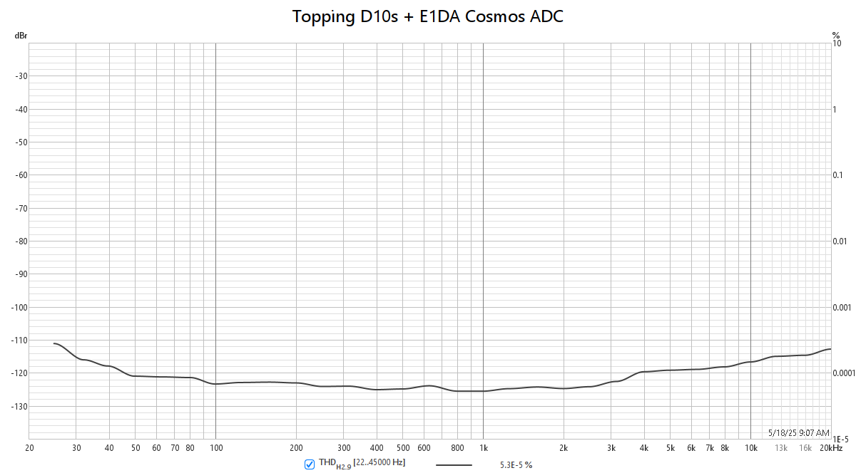

My 12 cents - I am using Topping D10s + E1DA Cosmos ADC as a relatively cheap measuring system, with total cost of about $300. THD vs. frequency measurement limit of the direct loop is shown below:
In case of single-ended output measurements, I use USB-ISO for the D10s, if necessary. I also use a set of balanced dividers to cover output voltage levels of power amplifiers, up to 70V.
THD limit at middle frequencies is about -126dB, THD+N limit is about -112dB (flat 22kHz). Noise level is then estimated by the D10s. I use REW and Arta/STEPS software. In a direct comparison with QA403, E1DA ADC is able to measure lower distortion and lower noise, but it needs qualified operator.
The LF rise of distortion is completely due to distortion in input electrolytic coupling capacitors in the Cosmos. This was proven by bypassing them by a piece of wire, but the resulting input DC shift is then unacceptable.
Cosmos ADC has too low input impedance and for measurements of link level stages it is good to use an additional buffer with a good op-amp and input impedance >= 10k.

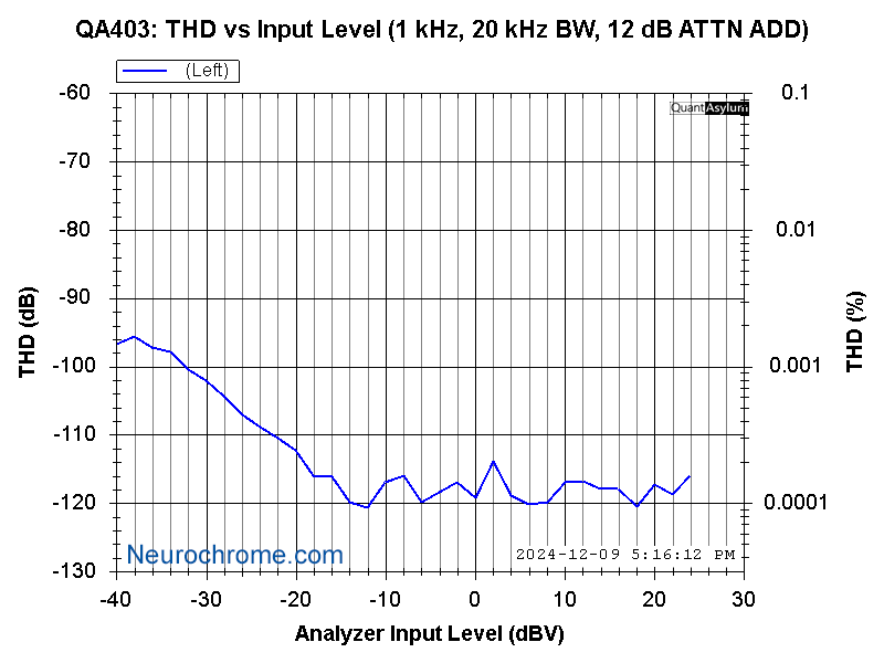

Interesting. I can't find an exactly corresponding plot in Tom's comparison on Neurochrome.com, but this plot
indicates, if I interpret both plots correctly, that at 1kHz the QA403 is at least 6 dB worse than the 1 kHz point from your DAC and ADC combination. Both plots show the integrated distortion, but yours is integrated over 45 kHz bandwidth, and Tom's over 20 kHz, so not apples to apples (besides plotting integrated distortion as function of different variables).

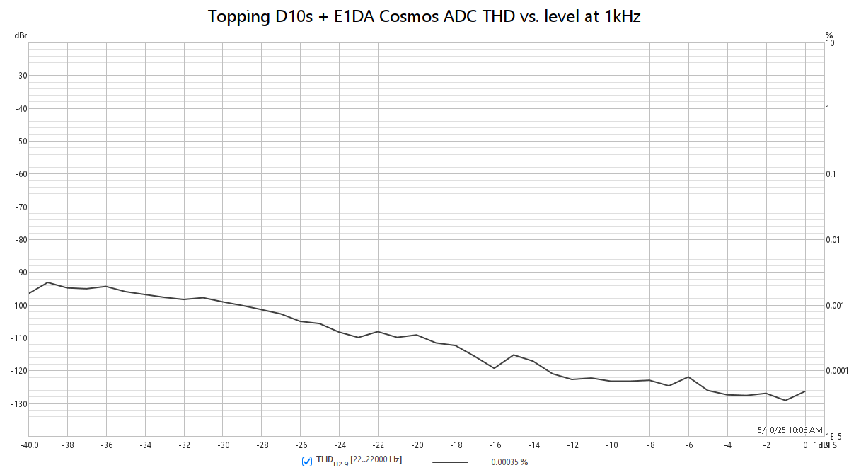

Your observations are correct. Tom's plot shows THD vs. level at 1 kHz (BW20kHz), my plot shows THD vs. frequency (at about -6dBFS /ADCinput/ and with BW45kHz). There is a big advantage of QA403 auto ranging. Cosmos, on the other hand, can get deeper in the low level distortion and noise. If I make similar plot as Tom did, it looks like this (please note I have no auto-ranger):
X-axis in dBFS re DAC output.
P.S.: I also have a Focusrite 2i2 and it can only be used for acoustical measurements. It is in no way able to measure neither preamplifiers, nor low distortion power amplifiers. Noise level is too high and distortion at higher frequencies as well.

Be careful with the units when comparing the graphs. The graphs I show of the QA403 shows THD versus input level (dBV) whereas some of the plots above show THD versus input level in dBFS. Without knowing what voltage 0 dBFS corresponds to we can't compare the graphs directly. That doesn't mean that comparisons are invalid; only that we should be a bit careful when applying them.
The ADC+DAC combo will have one sweet spot, i.e., lowest spot in the THD vs level graph. Dedicated analyzers like the QA403 and APx500 will have multiple sweet spots due to their input and output attenuators.
