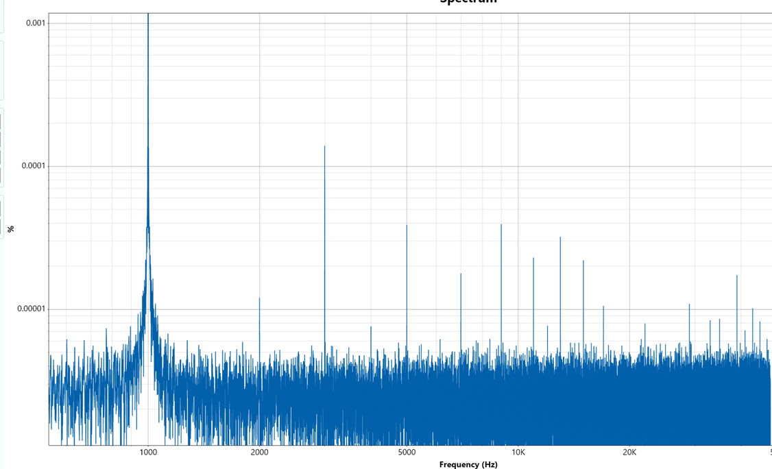

here's what the percent view of spectral plots shows (zoomed in). It's a nice way to validate where your distortion is coming from visually.
I'm still working on the data summary boxes. They're kind of useful placeholders at the moment and they need better formatting (like uV display), ability to show dBV rather than V, and some of the math is just plain wrong. When I finish the last 'urgent' piece (impedance testing) I'm planning to go back and update all the summaries to better usage then put the app dev on napping for a while.

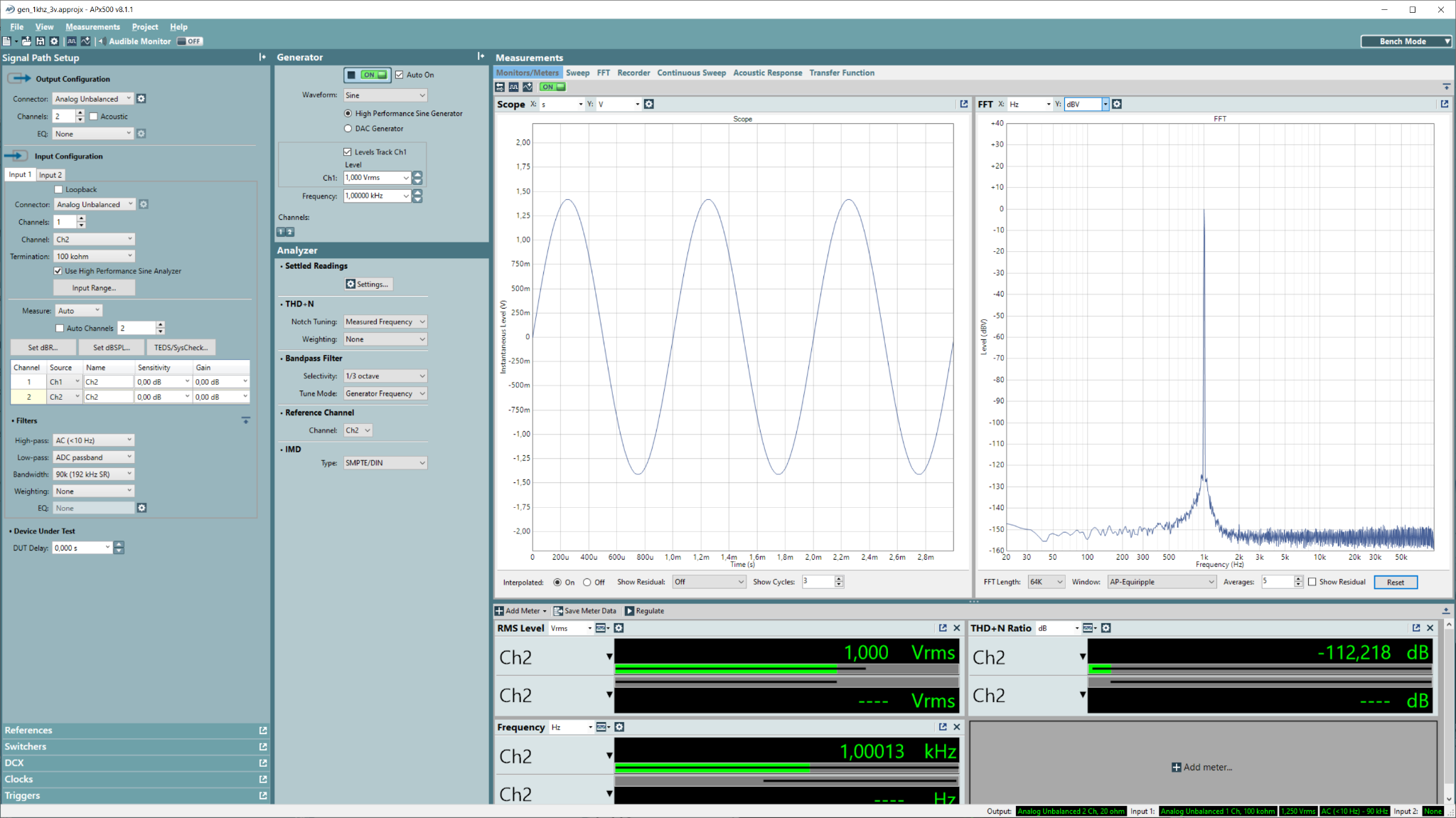

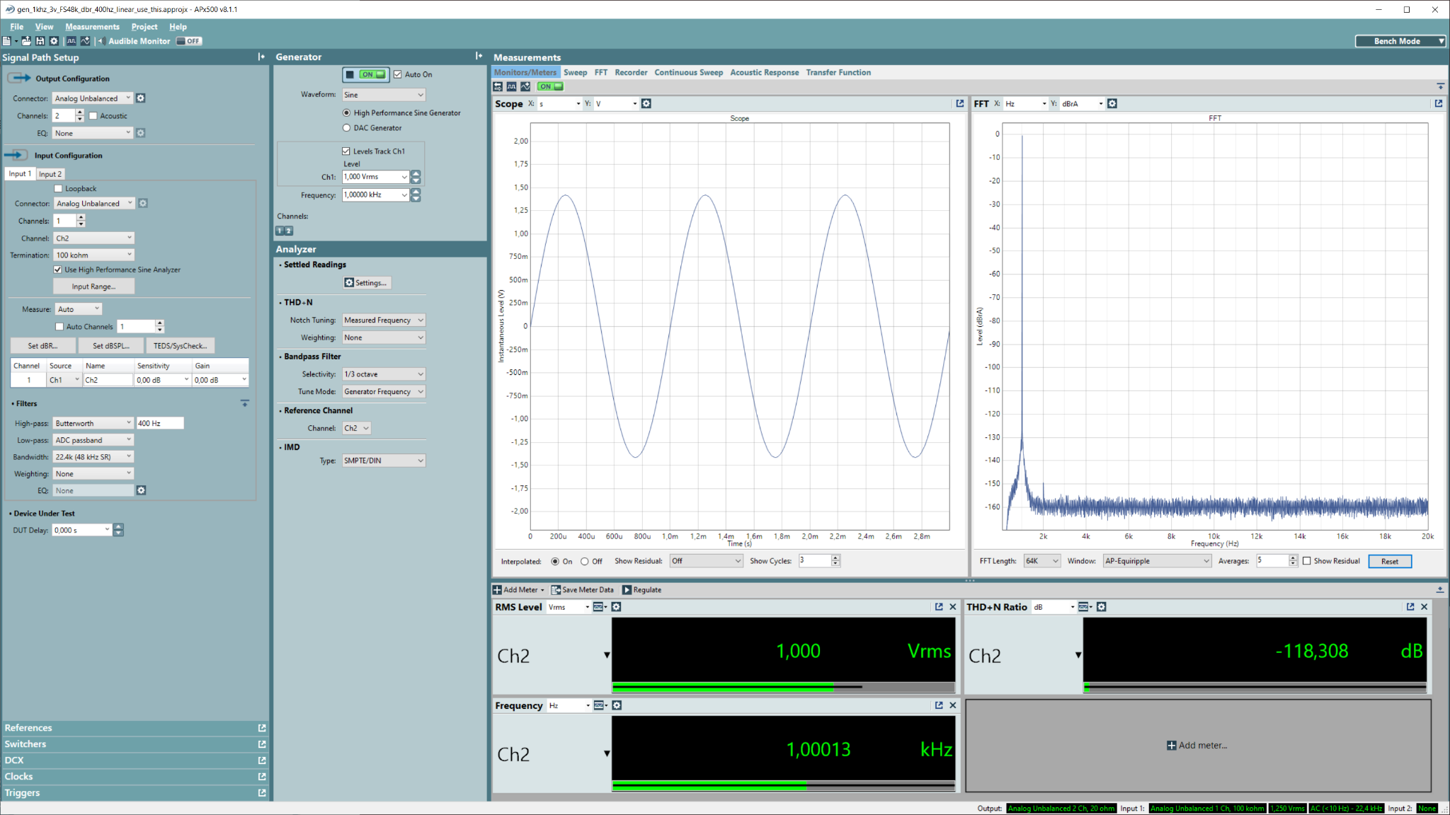

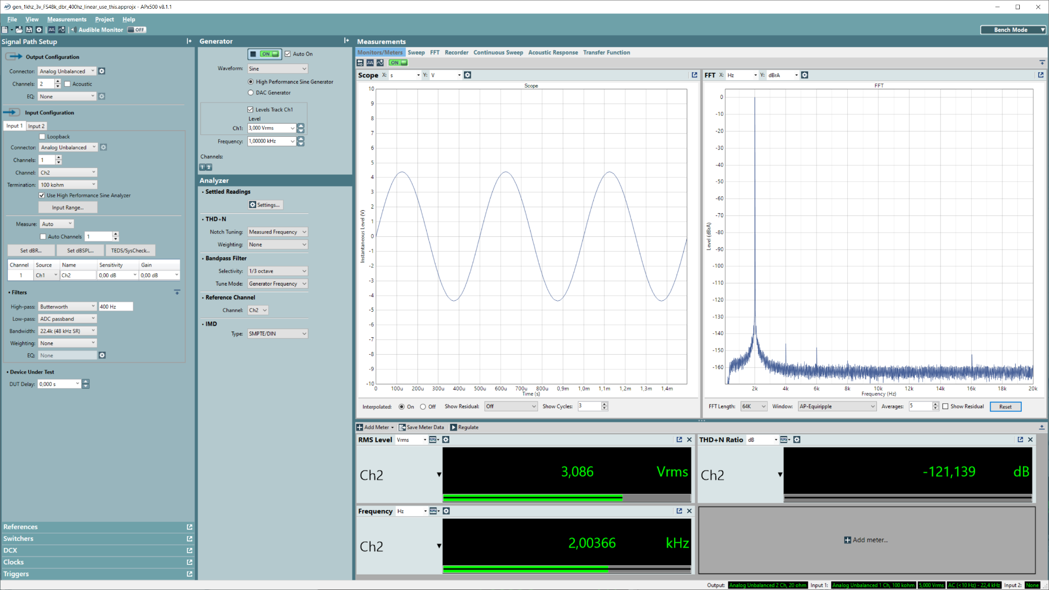

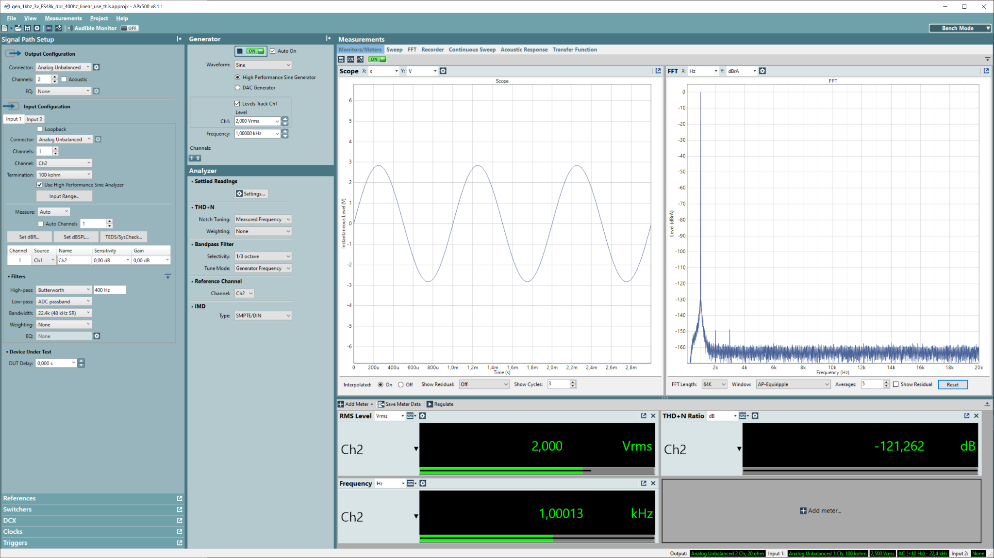

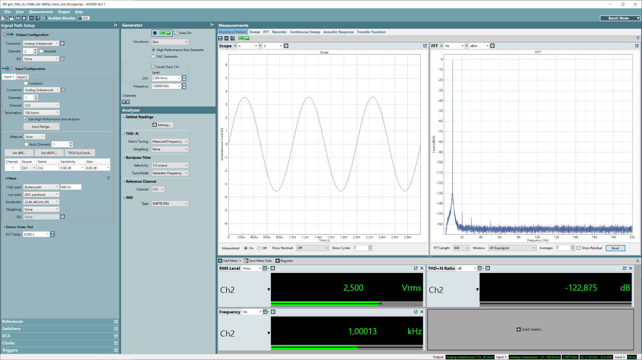

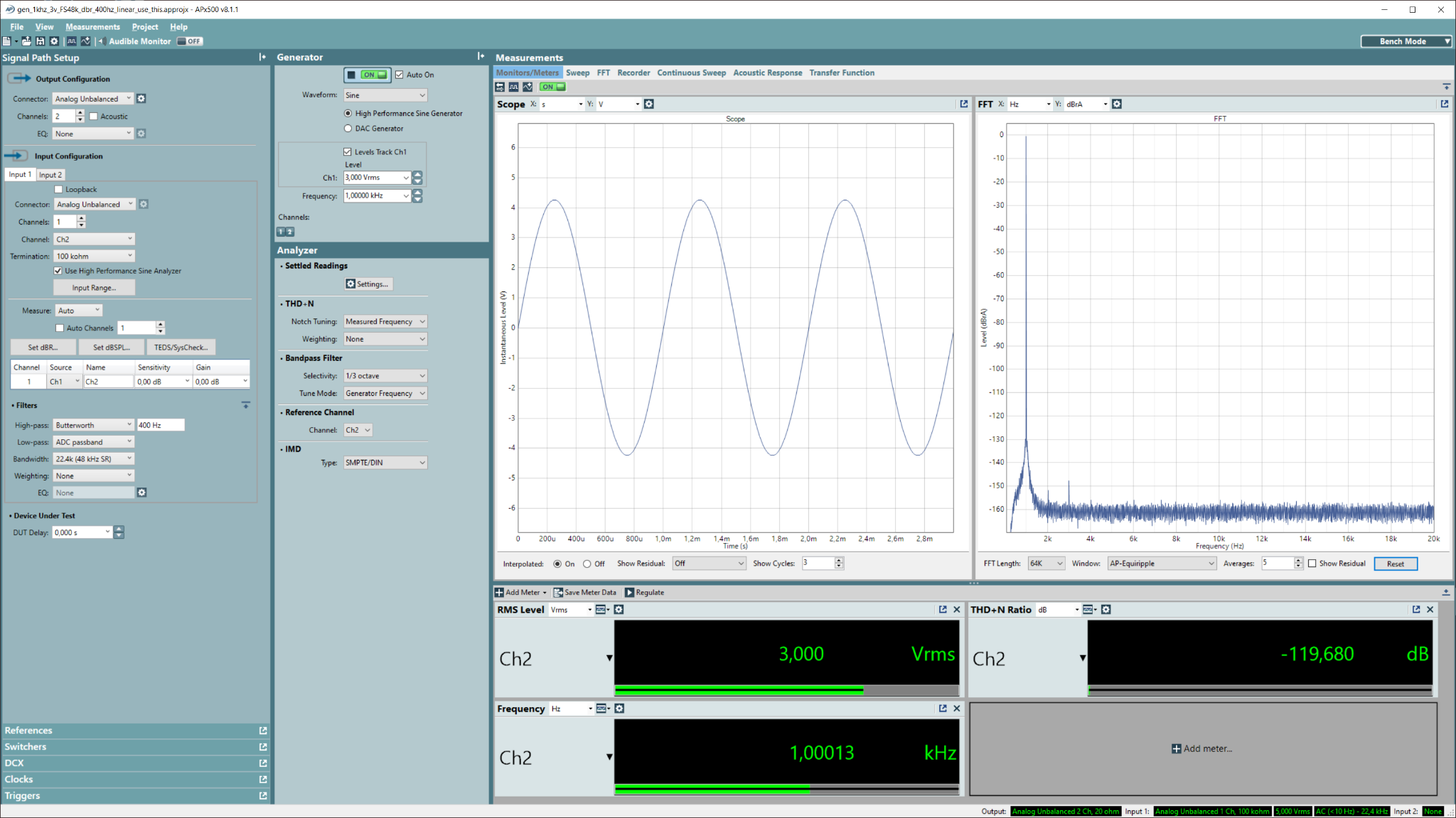

Hello thermionic,
two months ago an oscillator I developed was measured with an APX555. (see thread Low-distortionAudio-range Oscillator page 506ff.) For comparison I have the performance of the APX 555 for 1V, 2V, 2.5V and 3V RMS. (see pictures...)
Best regards
Helmut Sell

I'm trying to guess which post you're referring to and, thus, which oscillator you're referring to. A link to the appropriate post would be more useful. I'm guessing you're talking about Victor's oscillator. It's a good oscillator in spite of its quirks (single supply, long settling time on the amplitude, slight frequency wander). But note that the oscillator in the AP (and the notch filter in the advanced sine analyzer) delivers stellar performance across a very wide range. Not just a single frequency.

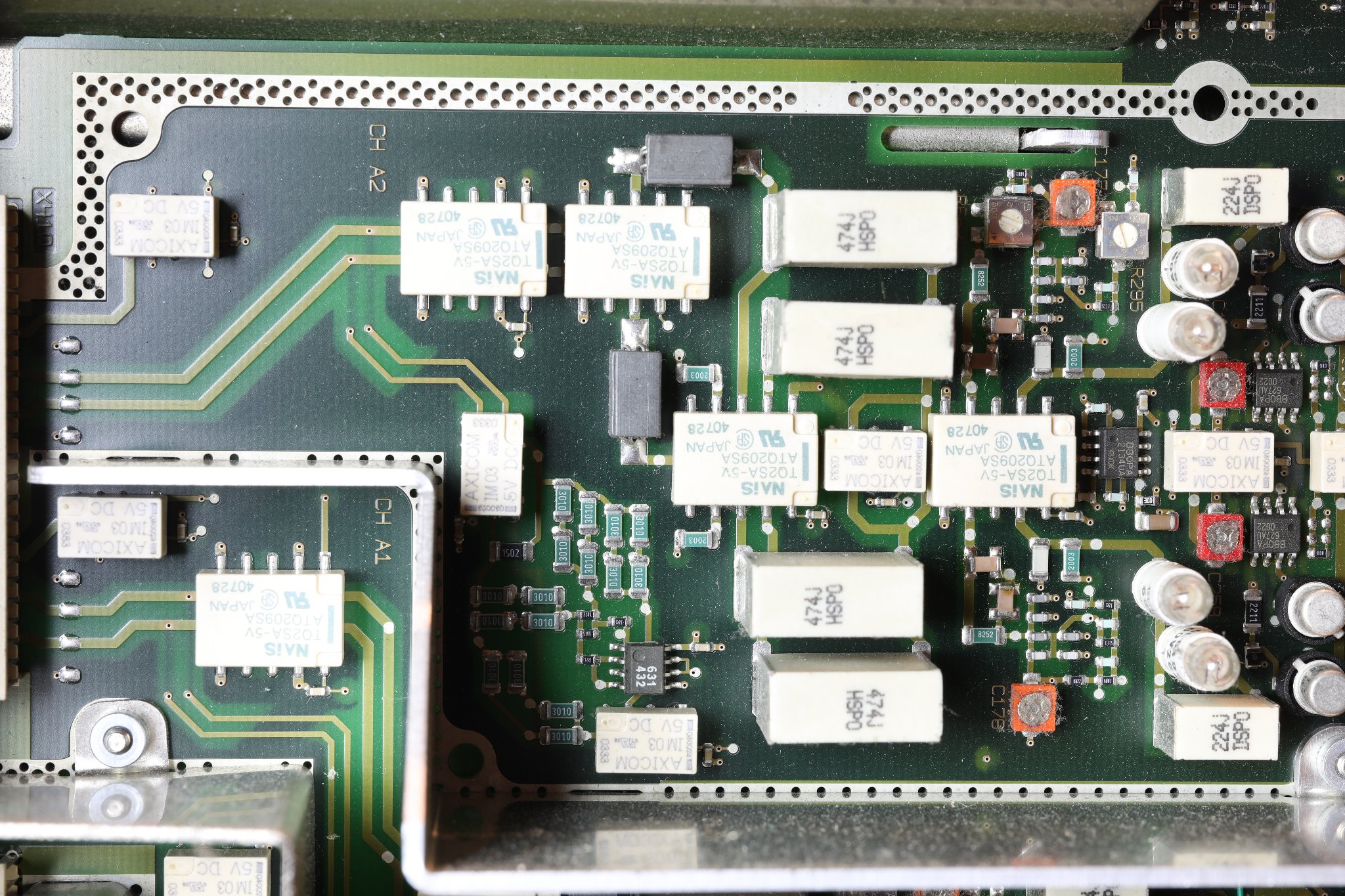

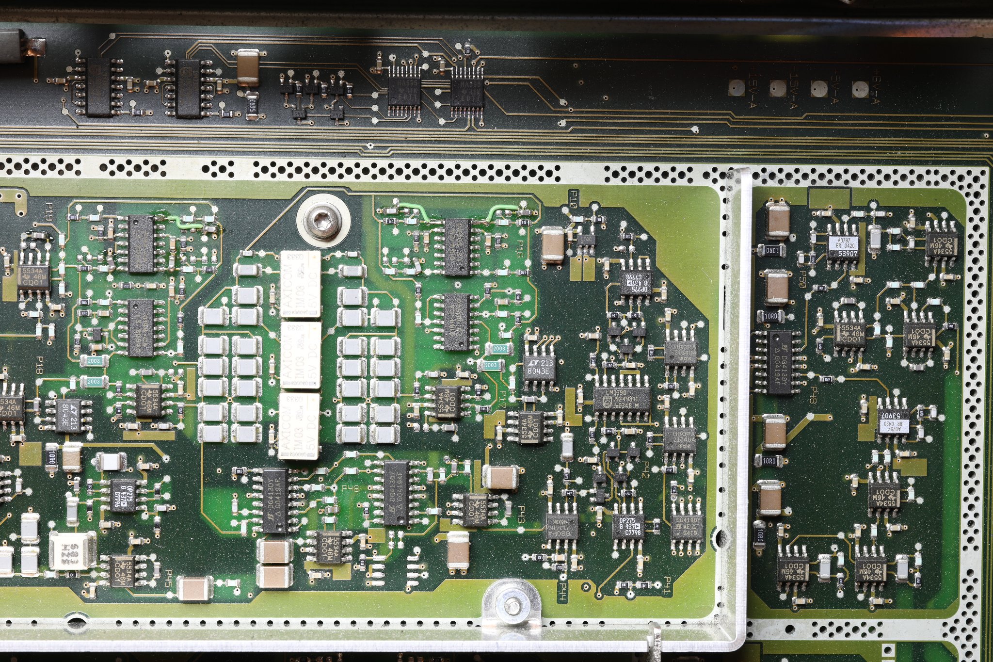

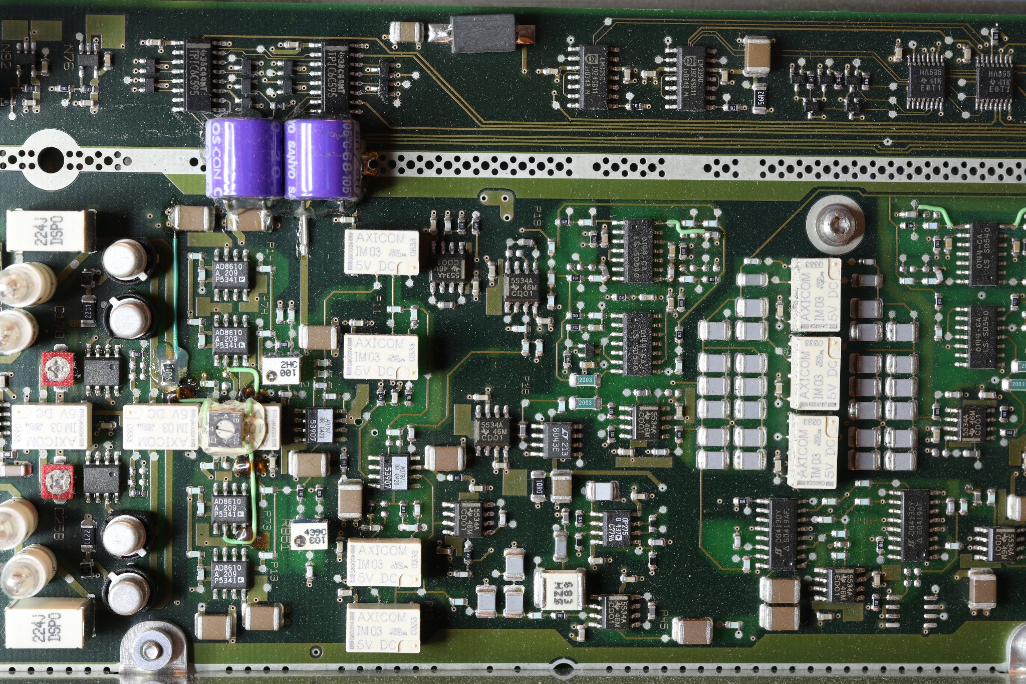

I have taken shots of a - rather dusty, sorry - UPV input channel - see attached. I took them a few moments ago and haven't digested them yet. I see AD797 and OPA627. I would have to trace it out in order to figure out what goes where... I am thinking that the ADC is likely to be the limiting factor in the UPV. You might be able to nibble a dB or so by improving the PSU or PSRR, but for headline THD+N a newer ADC may well be needed. I haven't had a chance to work out where the ADC is yet... I am going to post the photos and see what you think.
(there is an almighty kludge in this UPV that I don't see in others... I don't think this looks 'factory'... I am intrigued, as to my knowledge, no one outside of R+S has schematics. The SM has over 400 pages but no schematics...)
(it's good kludging, no? I'd be proud of that!)

Hello tomchr,
The five images in this thread are loopback measurements of the APX555 from the engineering firm Dr. Jordan Design (Dresden, Germany). Anyone who has developed something can have their device measured there. That's what I did. The measurements in the Low Distortion Oscillator thread therefore refer to an oscillator "I developed myself" with five switchable frequencies: 1, 2, 3, 4, and 5 kHz. I then posted two images there. One is my oscillator at 2 kHz, measured with the APX555, and the other is the loopback of the APX555 at 1 kHz. I've been developing oscillators for over 10 years (as a hobby). The oscillator I measured here, which I developed, is a State Variable Oscillator. It has nothing to do with the Victor Oscillator. Here are the two images again.
Best regards,
Helmut Sell
