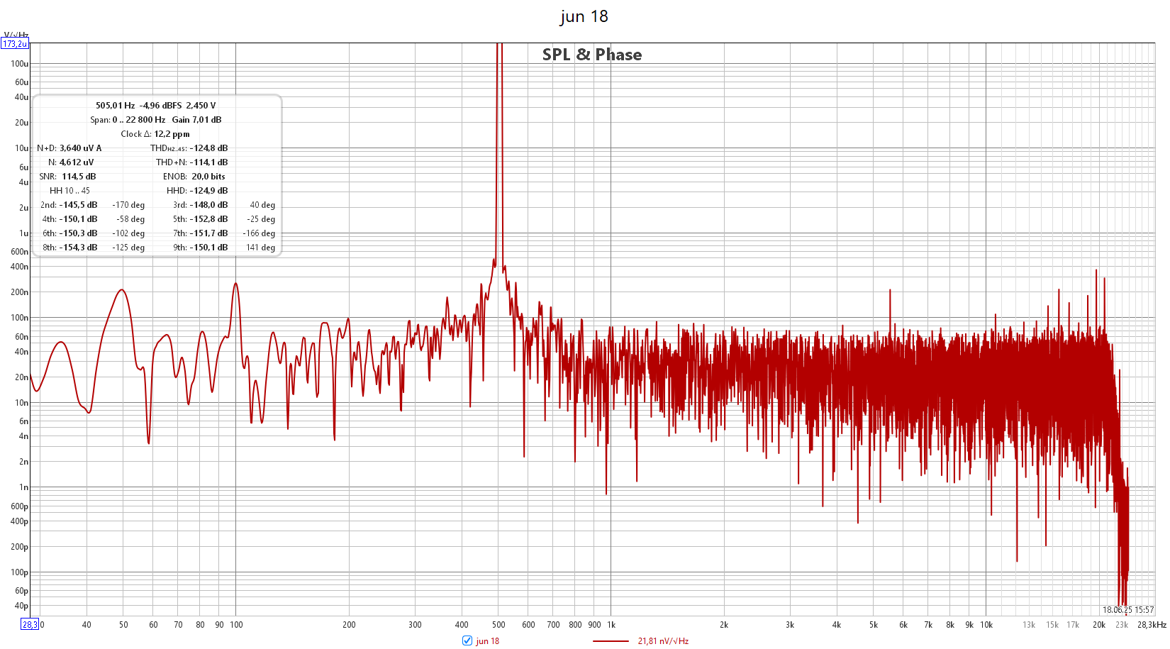

Question: to compare the noise floor in the plots above to other FFT graphs, I need to take into account the FFT bandwidth, the windowing function, and any averaging that might have been done, right?
Longer version of the same question:
According to the REW help file, locking the generator frequencies to the length of the FFT window assures that all the generated signals are periodic in the FFT, so that no signal leakage into neighboring FFT bins occurs (a pure sine will show up at a single frequency in the FFT graph). This also means that you can use a rectangular (= no) window, which is nice for noise calibration, because the 'window factor' is 1.
But I think you might still want to use a non-rectangular FFT window, because distortion products (sums and differences of base frequencies and of harmonics) will not generally be periodic in the FFT length, right?
If you use a (non-uniform) window then you will have to correct the noise floor. I guess you could make two FFT transforms, one with your window function of choice optimized for finding non-frequency-aligned peaks, and the other with no window function (i.e. rectangular window). Or you could just take the noise integral computed by REW, divide it by the square root of the bandwidth, and draw the noise line (assuming it is a flat line, i.e. white noise) by hand.
So, what is the correction factor for the noise floor in the plots above by @CG ?

Regarding noise floor only, switch Y axis scale to V/rt(Hz) - voltage noise density. This setting eliminates all the above mentioned variables and is the only correct one for this purpose. However, can be used only to read noise floor, the noise density. Not the amplitude of harmonics. Remember that total noise would be noise density x root of BW.Question: to compare the noise floor in the plots above to other FFT graphs, I need to take into account the FFT bandwidth, the windowing function, and any averaging that might have been done, right?

I think I know what you're asking, and I think I did that back in post 238 Both REW and Multitone used pretty much the same tone frequencies, at least as close as I could make them, and both had an RMS voltage of 0.71 V.
John Mulcahy - author of REW - has said that crest factor optimization algorithms generally have little effect on these kinds of tone sequences. So, I just tried turning crest factor optimization off in both programs and testing again. The RMS output voltages didn't change, and the stated crest factors in each generator didn't change. Results for Total Distortion + Noise stayed the same and were within a dB between the software applications. I get that much variation at this distortion level between tests run 10 minutes apart, no matter the software. Perhaps Audio Precision results are more stable than that, because I see SINAD ratings competitions separated by tenths of a dB on some web sites. 🤷♂️
Oops! Forgot the tone frequencies. I requested REW to generate a sequence beginning at 20 Hz and stopping at 24 KHz. It gave me a starting frequency of of 20.5 Hz. Using that as a base with the sequence John Mulcahy published, the frequencies I also used in Multitone were:

Both applications were set to use 1 Meg FFT lengths, Blackman-Harris 87.5% filters, and 16 averages.
Please correct anything I am doing wrong. Anybody. I'm not proud. No need to be gentle.

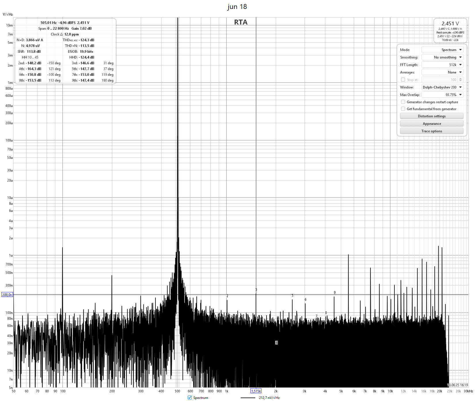

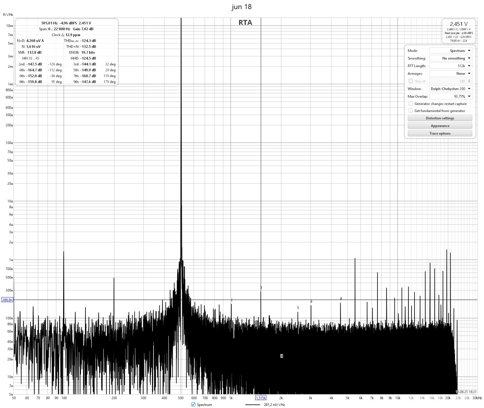

Other aspects, such as for example?Personally, even though I'm a founding member of the THDnut brigade, I think THD much below 100 dB is not a fruitful pursuit. Other aspects may be more important and more rewarding to address.
Thanks, PMA! So you could pick a non-rectangular window and set up some averaging, and the noise floor in V/sqrt(Hz) would still come out correct? I was under the impression you'd have to also pick the rectangular window and either forego or correct for averaging. I got the correct scaling when I did that. I'll have to check whether window and averaging are automatically corrected next time.Regarding noise floor only, switch Y axis scale to V/rt(Hz) - voltage noise density. This setting eliminates all the above mentioned variables and is the only correct one for this purpose. However, can be used only to read noise floor, the noise density. Not the amplitude of harmonics. Remember that total noise would be noise density x root of BW.
My question though is with regard to measurement plots made by other people, where I can't influence the settings used. For example the plots posted by CG in this thread. Assuming he used the same parameters as in post #255, the FFT window length was 1 million, bandwidth 24 kHz, 3-term Blackman-Harris window (I could not find a reference for an 87.5% Blackman-Harris window, so I'm guessing 3-term), and 16 averages, would I take the noise level indicated in the plot, divide it by the FFT bin width in Sqrt(Hz) (in the example sqrt(24,000/1,000,000), divide it by the square root of the noise power bandwidth (from this AP note, Sqrt(1.73) for Blackman-Harris 3-term), and multiply with the square root of the number of averages (4 in this example)? So in this example it would make for -140 dB (from the most recent plot in this thread) - (-16.2 dB) -2.4 dB + 12 dB = -114.2 dB/Sqrt(Hz)?
But, the Multitone plot indicates an integrated noise value of -120 dB (for the same plotted noise floor level of -140 dB as in the REW graph). Adding 43.8 dB (i.e. multiplying the flat noise floor density with sqrt(24 kHz) bandwidth) to either number for the noise floor, this doesn't seem to make any sense at all, with or without the corrections I just listed.
I would really appreciate if somebody could point out where I'm going wrong; no doubt there is some very basic mistake there.
