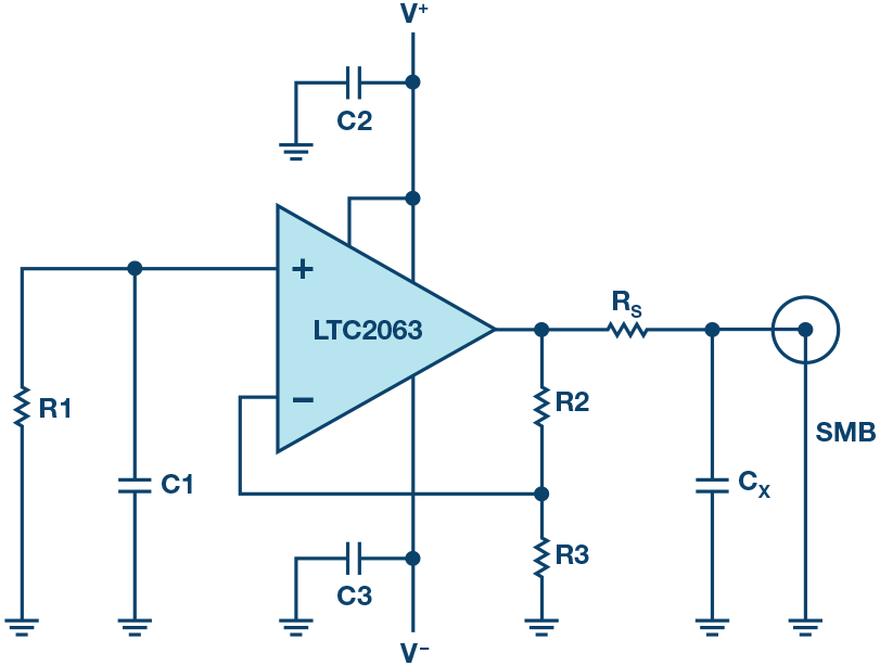

Regarding noise calibration, has anybody used or built an external noise calibrator, e.g. from a resistor and an amplifier for gain and buffering? Analog Devices has a note describing such a thing, but the op-amp they recommend is quite limited in gain bandwidth product, so the device is only good for noise up to a few hundred Hz.
Would maybe a Microchip MCP6V81 work in a similar circuit? It also has much lower input noise (13 nV/Sqrt(Hz) instead of 230 nV/Sqrt(Hz)) than the LTC2063, and requires only a single supply voltage. I have zero experience with these 'zero-drift' op-amps.
Schematic from the Analog Devices note linked above:
I would think that some of the modern low-noise, low-drift opamps could be of interest. The challenge will be to find one with low 1/f noise.

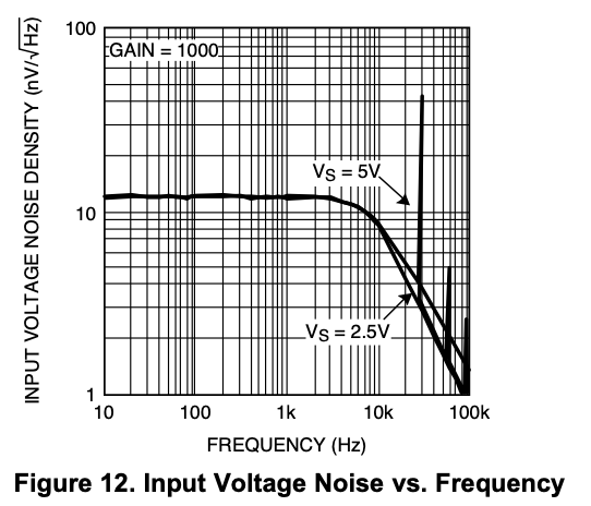

That's where the zero-drift opamps are nice. Zero-drift can be implemented by swapping polarity on the input and output at some rate that's generally above the audio band. Take the LMP2021 for example. There's some switching going on at around 30 kHz as evidenced by the spurs in the noise plot below.
This switching has the advantage that it nulls out the input DC offset, but it also cancels out the 1/f noise so if you build a noise source with an auto-zero amp, you'll get white. The drawback, as you've discovered, is that these amps tend to have limited useful bandwidth.
But as I mentioned, some of the newer low-offset, low-drift opamps also have very low 1/f noise, so they could be useful if a white noise source is what you're after.

Making a calibrated flat noise source is not easy, and then what are you trying to do with it? Assuming the software has the correct math, calibrating the chain with a sine wave is the best starting point. Assuming your DUT has some gain (20 dB) a reasonably low noise input on the analysis chain should not limit your efforts. A noise source can be useful for validating your chain.
A noise diode is the usual starting point for a noise source. You can use a resistor. It should have a significantly higher noise than the input amp of your noise source. And I would recommend a FET input or input noise current will mess with your efforts. Another way is a pseudi-random source using a shift register or software etc. Or get a General Radio 139X noise generator. Around $80 to $130. However they are not calibrated in mV/rtHz. I can help with that if you find you need.
