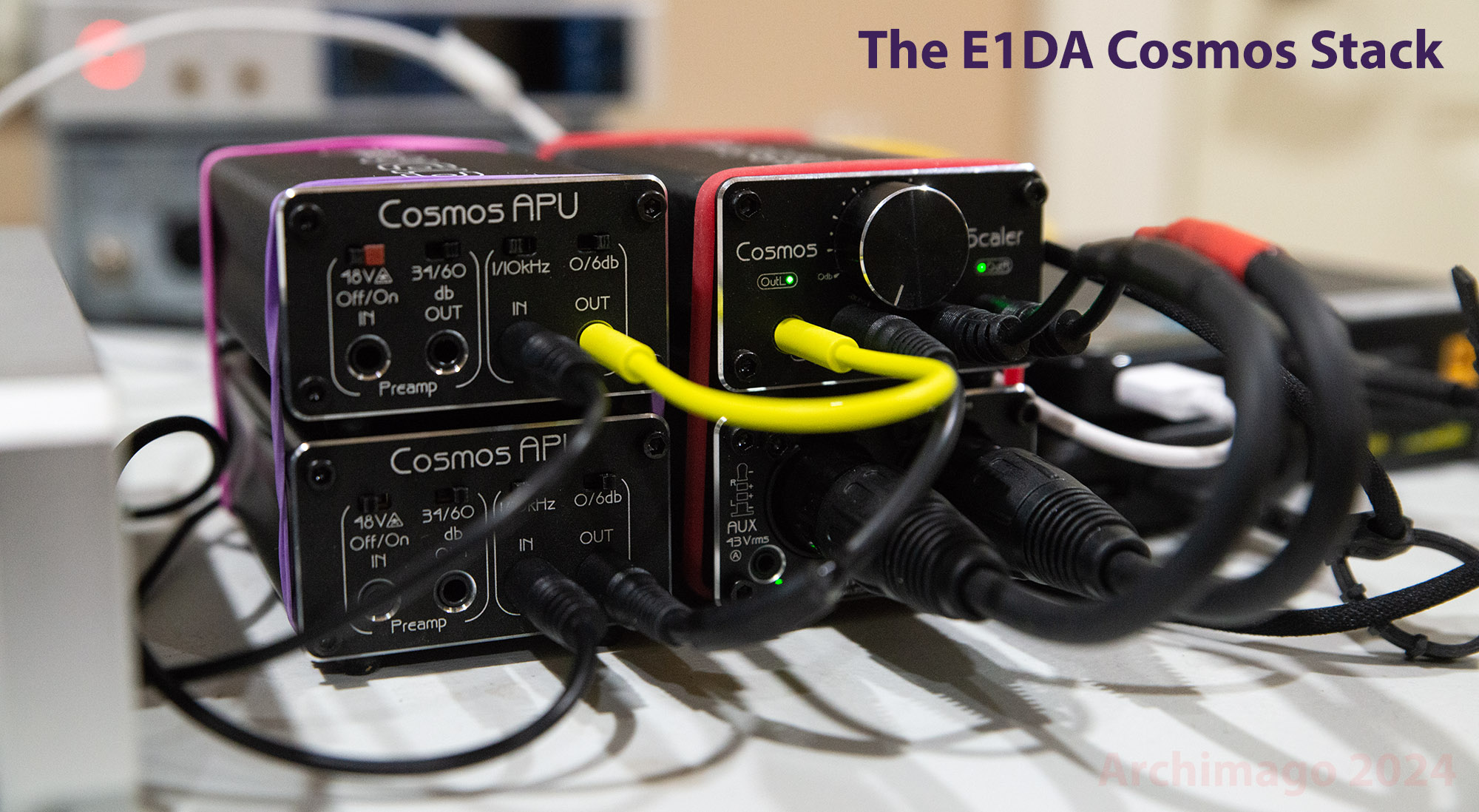

Which Cosmos ADC did you get? The "0 grade" with the lowest THD or one of the other ones? Just curious. It doesn't matter greatly, I don't think, but it would be nice to know for completeness.

Your assumption is incorrect. The DAC used has lowest distortion at 0dBFS output level, and the same applies to ADC input. There is no knee and turning point with distortion rising, up to the clipping. We have made direct comparison with QA403 and QA403 noise and distortion results are inferior. Yes, it has big advantage of autoranging and may be operated by (almost) lay person.The ADC+DAC combo will have one sweet spot, i.e., lowest spot in the THD vs level graph. Dedicated analyzers like the QA403 and APx500 will have multiple sweet spots due to their input and output attenuators
Cosmos ADC noise limit is about -124dBFS (flat 22kHz) with highest sensitivity of 1.7V/0dBFS. This clearly defines the intrinsic noise of the ADC part.

Have you tried Cosmos' own DAC? They have one based on the same ES9039Q2M DAC chip as the Topping D10s. $139 from Cosmos as I recall. So a few bucks more than the Topping.
