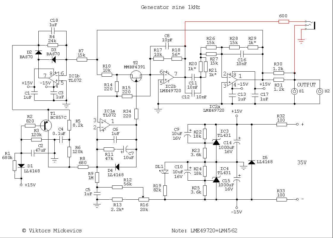

Viktor has an oscillator with a balanced output? The ones I have have only single-ended output. It's also floating at VCC/2 which is a bit inconvenient at times.

Here is a schematic of balanced output in older version.Viktor has an oscillator with a balanced output?

No, the supply needs to float and the two shunt regulators establish a ground between them. A single ended supply, even a stack of 9V batteries works well.Viktor has an oscillator with a balanced output? The ones I have have only single-ended output. It's also floating at VCC/2 which is a bit inconvenient at times.

You remember the schematic better than I do. Either way, not the most convenient. I've used a stack of 9 V batteries. That works well as you point out. As do a couple of power tool batteries.No, the supply needs to float and the two shunt regulators establish a ground between them. A single ended supply, even a stack of 9V batteries works well.
