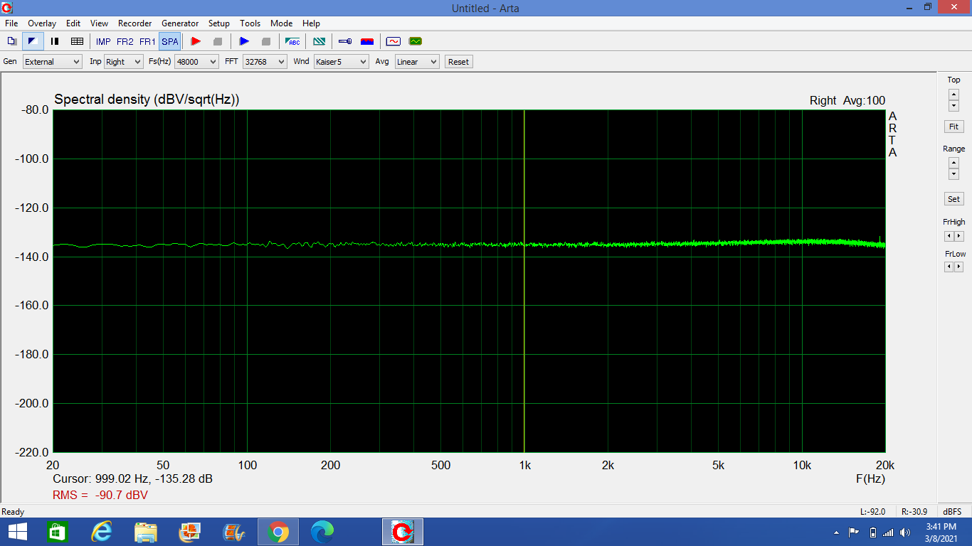

Measurements after changing CRC resistors from 0R39 to 47R
VRDN stock Denoiser disengaged or Cadj. only measurements:
Noise@1kHz = -135.28dBV/sqrtHz or 172.1nV/sqrtHz
PSRR@120Hz = -58.06dB

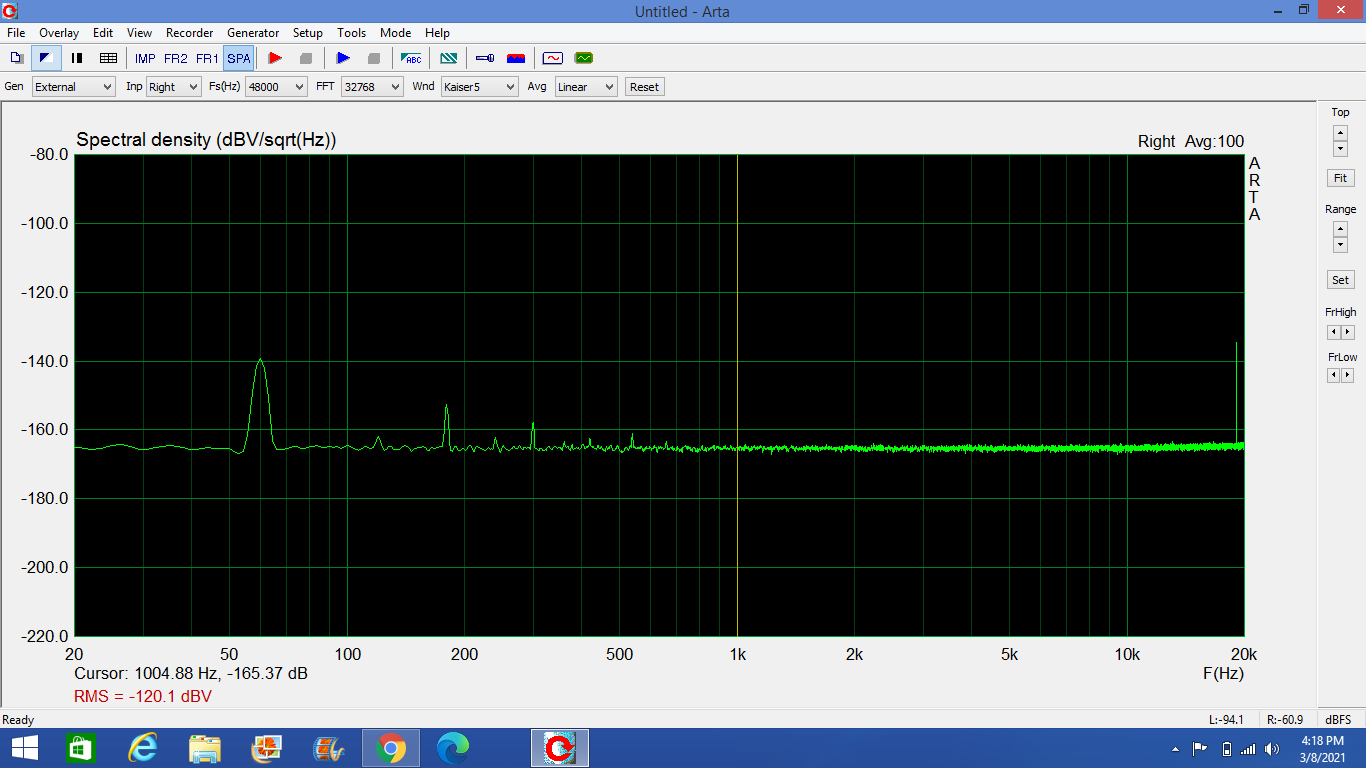

Add-on denoiser implemented, stock denoiser not connected to coupling cap:
Noise@1kHz = -165.37dBV/sqrtHz or 5.3nV/sqrtHz
PSRR@120Hz = -86.32dB

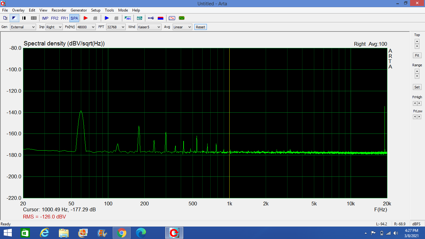

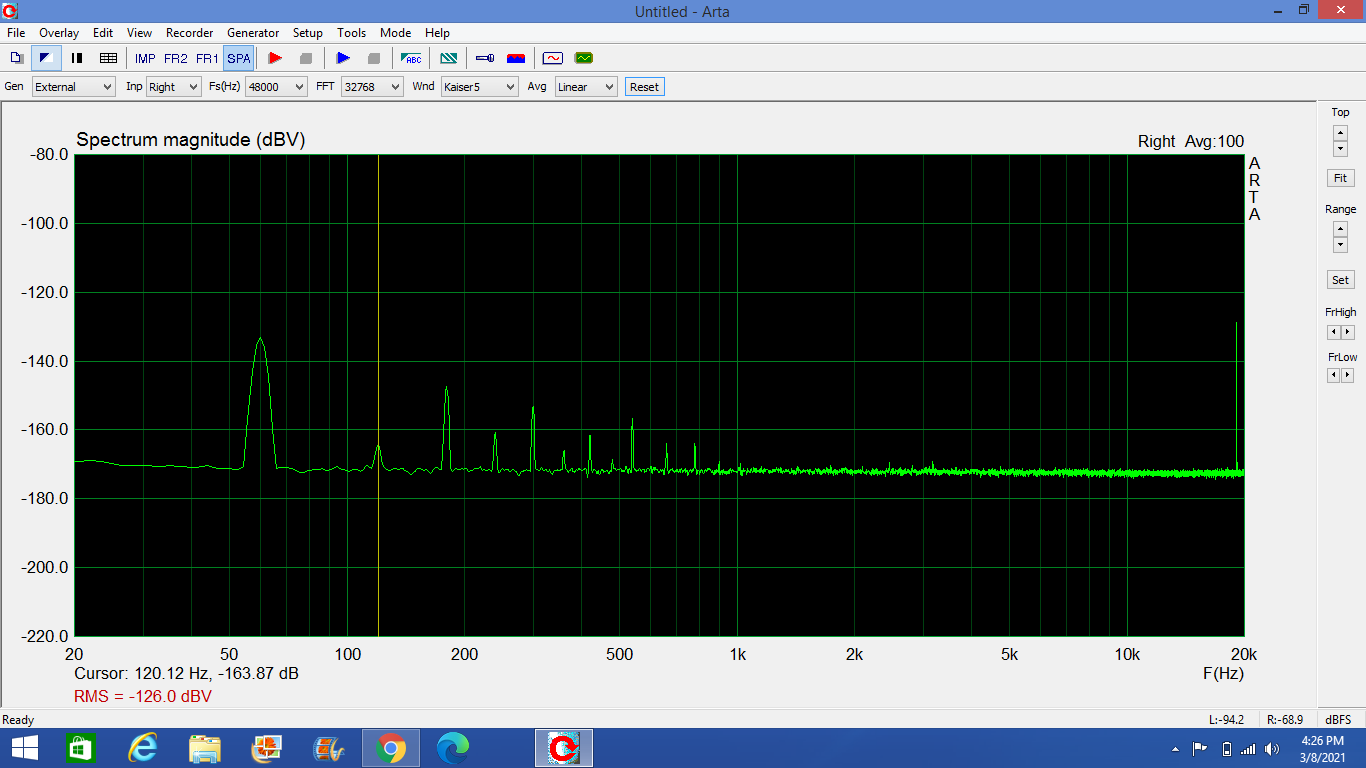

Add-on Dienoiser implemented, stock denoiser not connected to coupling cap:
Noise@1kHz = -177.29dBV/sqrtHz or 1.3nV/sqrtHz
PSRR@120Hz = -93.46dB
The PSRR numbers may look worse, but almost all levels are slightly lower which you will be able to see in the measurements of output ripple.

Positive Rail with stock Cadj. noise
VRDN pos rail stock with output caps changed denoiser disengaged 66mA load noise.PNG

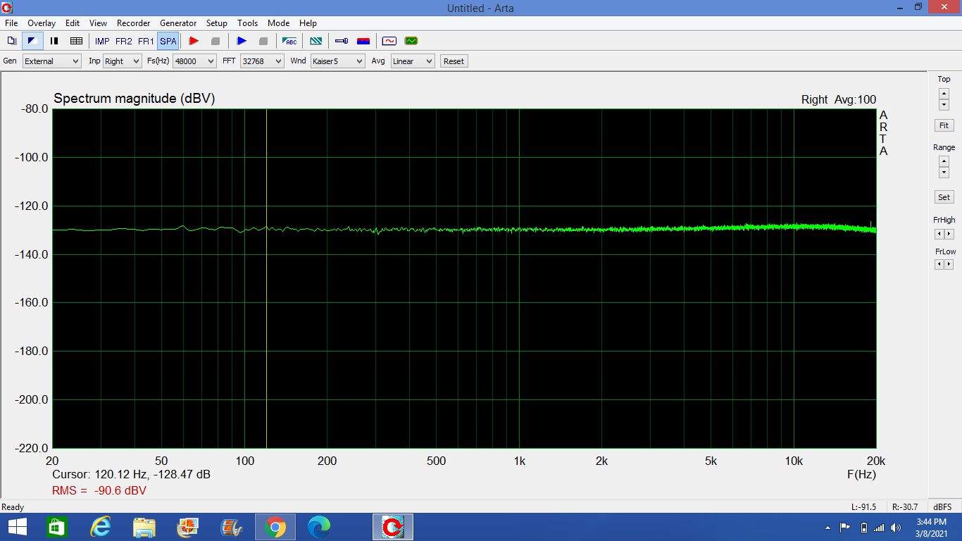

Positive Rail with stock Cadj. output ripple
VRDN pos rail stock with output caps changed denoiser disengaged 66mA load output ripple.PNG

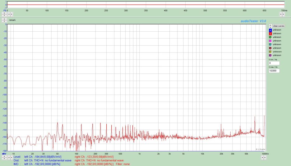

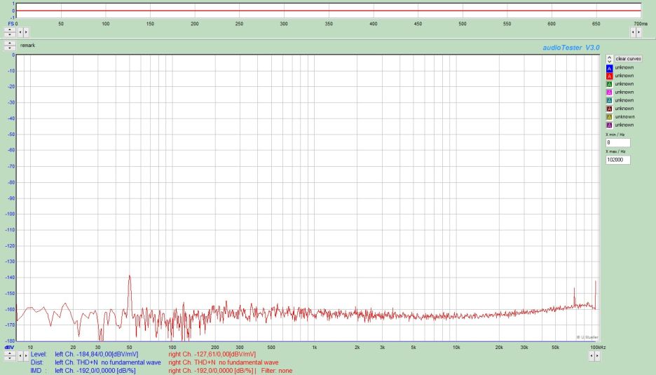

Your graphs remind me of my own tests with denoisers a while back (D-Noizator: a magic active noise canceller to retrofit & upgrade any 317-based V.Reg.). I got similar mains related spikes when I tested a denoiser on a LM317 PS that had ground planes. No spikes using the same add-on denoiser on a quick&dirty LM317 PS without ground planes.
denoiser+LM317 with ground planes
denoiser+LM317 without ground planes

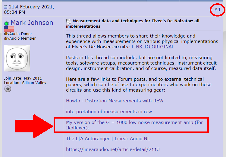

Many interesting links in the first post, thanks for the collection Mark! There seem to be quite a few popular LNA designs which makes it hard to get a good overview in a reasonable amount of time (so many long threads...). Are there any LNAs with published Gerbers apart from the one Samuel Groner designed a while back? I really can't start another design project right now so I am on the lookout for something to just put together and work. Not trying to derail the thread however, I am equally grateful for any PM with a helpful link or hint.

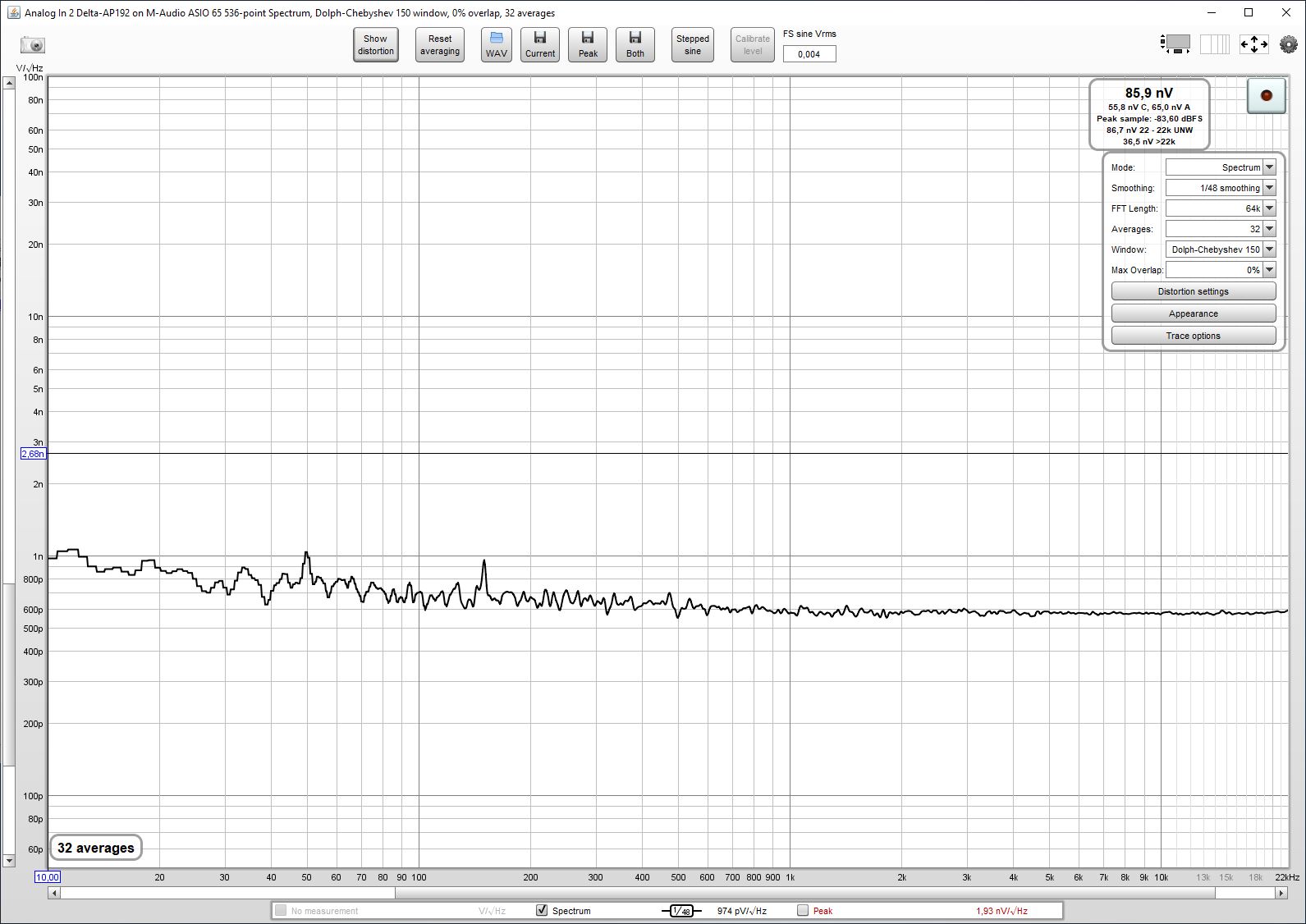

You might consider Scott Wurcer's LNA: My version of the G = 1000 low noise measurement amp (for Ikoflexer). I made a version with 4x 2SK170BL fets (see here). Noise is about 580pV/rtHz@1kHz but the noise profile is almost flat so the low frequency noise is very low (about 1nV/rtHz@10hz). And it runs on a single 9V battery so AC related noise is low if well shielded.

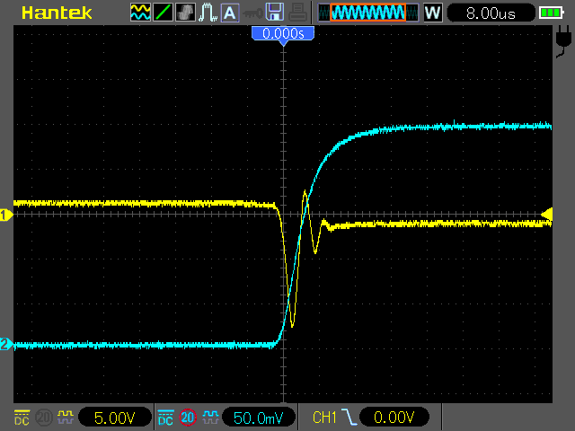

Regulator response on transient load
One of the power supply’s most important properties, for use in the audio circuits, is their transient response. That is occasionally mentioned but almost never measured. So, we are using various power supplies in good faith that their transient response is good enough.
I’m not much into denoiser + LM regulator circuits any more, but as I have several working regulators, and have recently expanded my test bed, I took measurement on the LM317 + ordinary one BJT denoiser.
Voltage dropout on the regulator was 3.5 V, output voltage 11.5 V, load current 0.75 A @ 1 kHz with 50% duty. Blue trace is voltage on the 0.33 Ω resistor at the current sink used as load. Yellow trace is output of the regulator amplified by 1000 x. So, 5 V/div is in fact 5 mV/div.
attachment.php
What I learned from this measurement?
Transient response is good. Real output impedance can’t be as good as predicted by simulations. There are copper traces resistance, solder joints resistance, output connector resistance … in between.
My pcb uses power planes at all available width, and has Kelvin connection, yet measured dynamic output impedance is about 3 mΩ (voltage drop of 2 mV on load / load current). Using higher load current, I got 2 mΩ.
Long story cut short, I hope you will be happy to know that denoiser circuits have good transient response.

That is interesting. Do you think one could look at the output impedance by sensing with the LNA right at the output of the regulator to exclude track resistance, while having the supply feeding an active load? The measured signal would be the result of the output impedance.
Even if not a precise measurement, maybe this would show at least the linearity of the output impedance with frequency sweeps?
