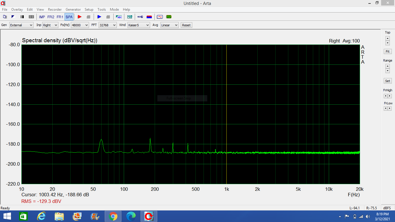

RickRay sent me this picture few days ago. It was a measurement with a shorted LNA input. Do you think this could mean that his noise density could be around 2nV/sqrtHz?
LTSpice sim shows around this (375pV) value, and for me shows around 440pV/sqrtHz.
I think member Calvin mentioned the circuit "should" have around 0.4nV/sqrtHz, here:

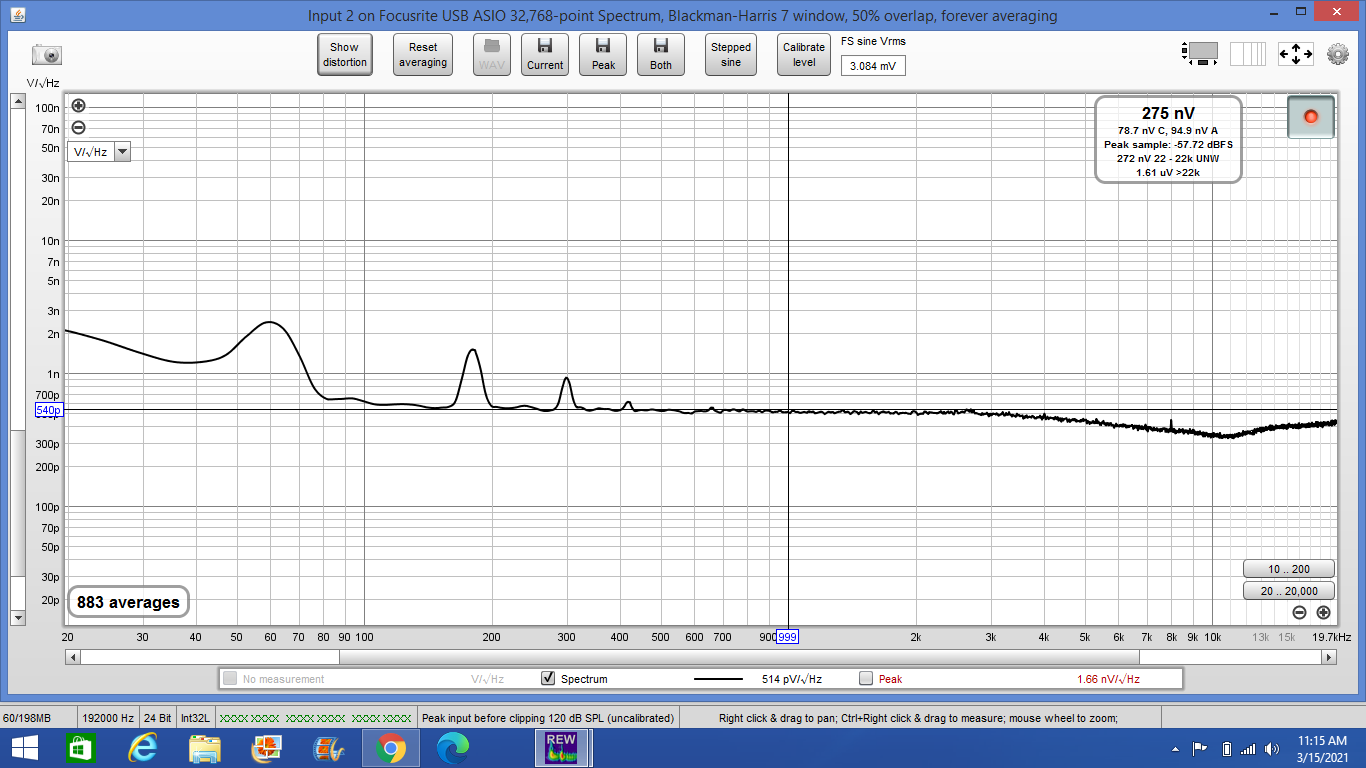

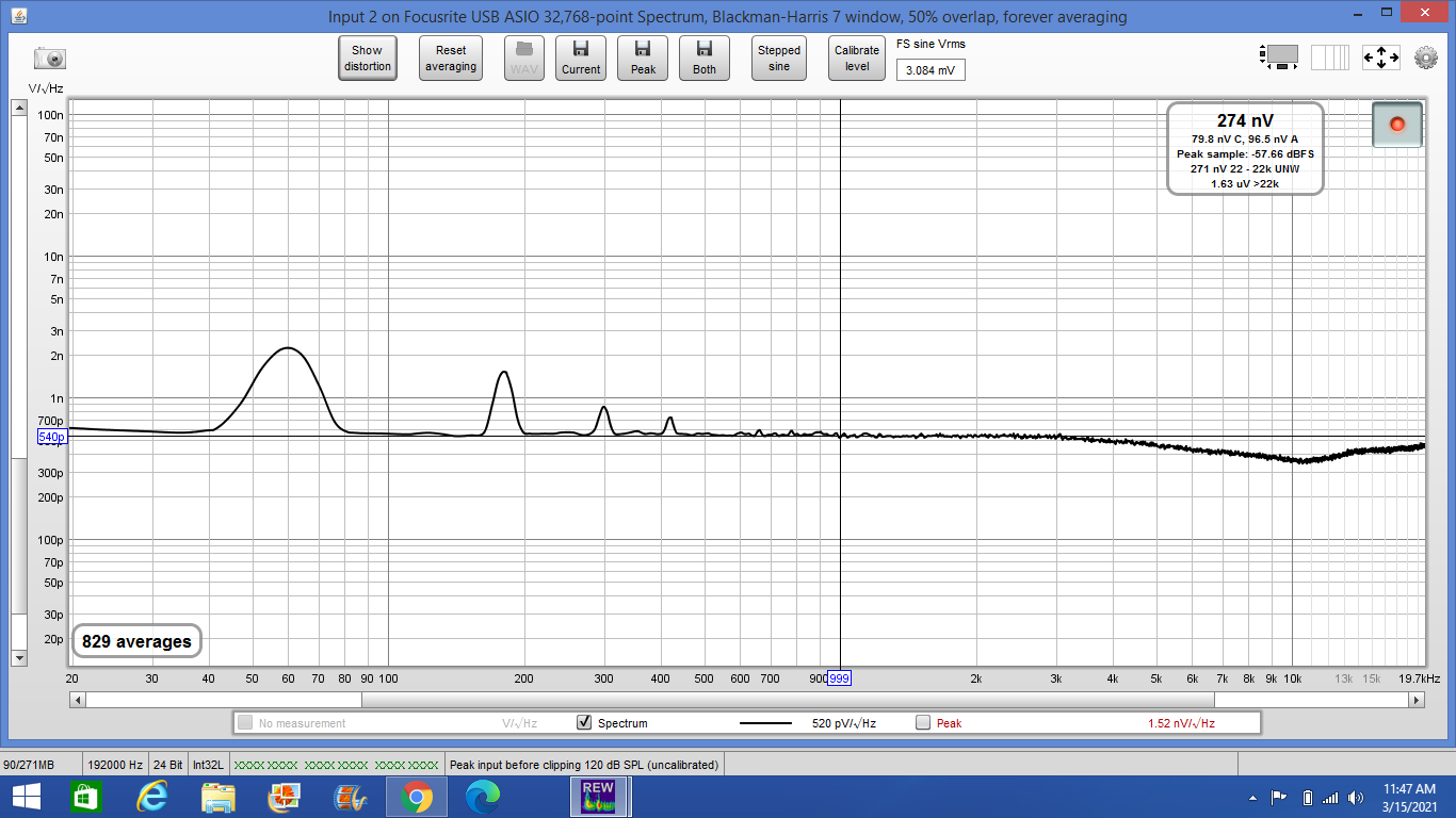

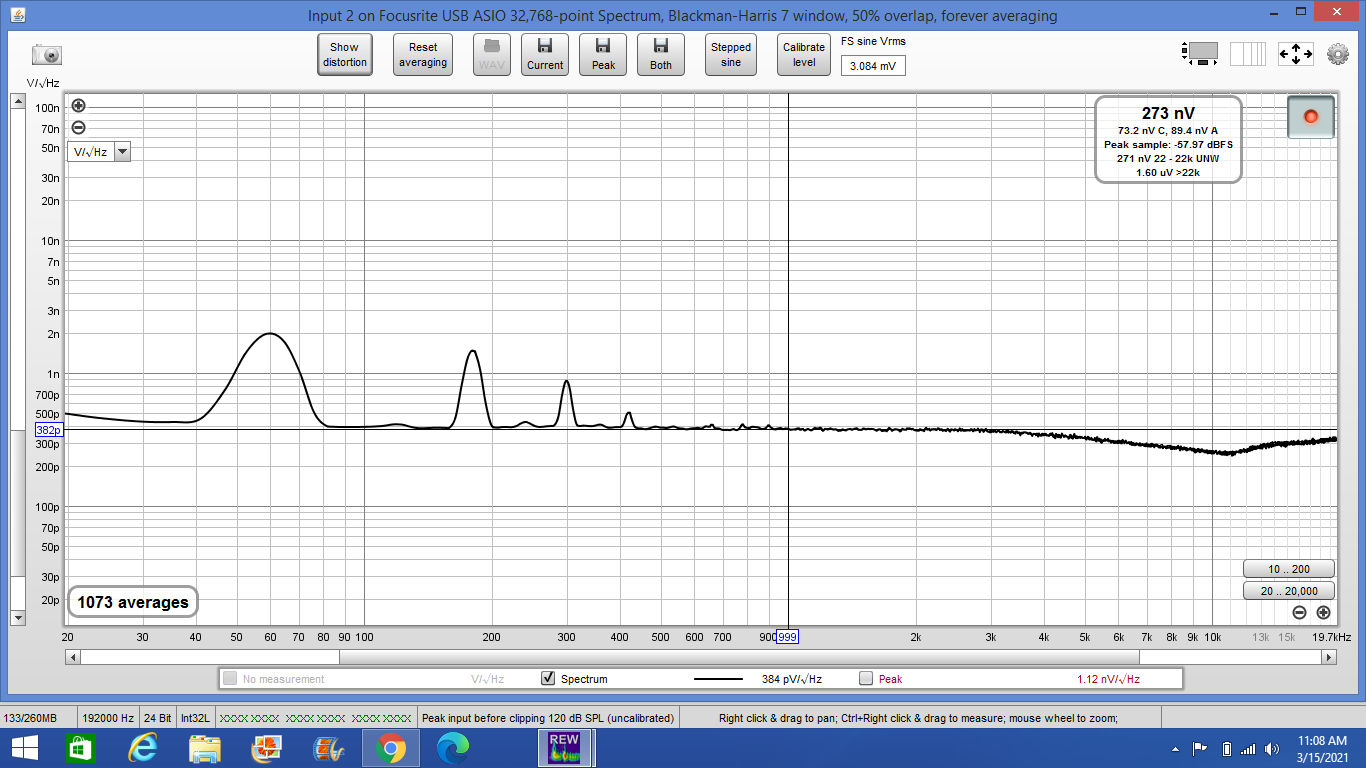

The last graph with potentiometer across the input was a little low. So I went back and played with it until I got what i feel is a good average, just a little high to safe. The resistor value for this graph was 8.855ohms or 378.6nV/sqrtHz. Pretty sure this thing is right at 375pV.

I guess you shouldn't have had me re-measure. The resistance to increase the noise +3dB was 6.84 ohms or 332.8pV/sqrtHz.
Why shouldn’t I do that? See, you got even better measurement.

There is one odd thing on the attached screenshots: total noise voltage over bandwidth is the same for both measurements, about 1.61 - 1.63 uV, although noise levels are 3 dB different.
When I was doing the same +3 dB test on my LNA, voltage level has risen by corresponding +3 dB.
The only thing that could be causing that is bandwidth. I think mine is set at 192k for sample rate and 32K for FTT length. We really shouldn't be sharing measurements without the Spectrum Analyzer settings. That's probably why I couldn't get the total number to work for me.
What is your Analyzer set at?

These are rather strange measurements. First of all the noise dip at 11kHz. But most importantly the total noise from 22hz to 22kHz is 271nV. That is a lot more than 6.84 ohms in that bandwidth (50nV) and more than 3 times what my LNA measures (shown here, 86.7nV). The mains related low frequency hash does not explain all of this so what might be the cause for this total noise?
My guess is that there is actually a lot more hash which the lengthy averaging hides. Could you repeat the "input shorted" measurement with Tombo56's settings (see next post).

I agree, I think this setup has considerable noise at higher frequencies. But I should still be able to use the area between 400Hz and 3kHz for measurements. Just can't rely on it for higher frequency measurements.
I'm not sure, but I'm betting if I went to battery power, I could clean up the higher frequency noise.
Problem is it ate 4 9-volt batteries in about 8 hours, can't afford that many 9-volt batteries. Need to look for another bigger battery source.
