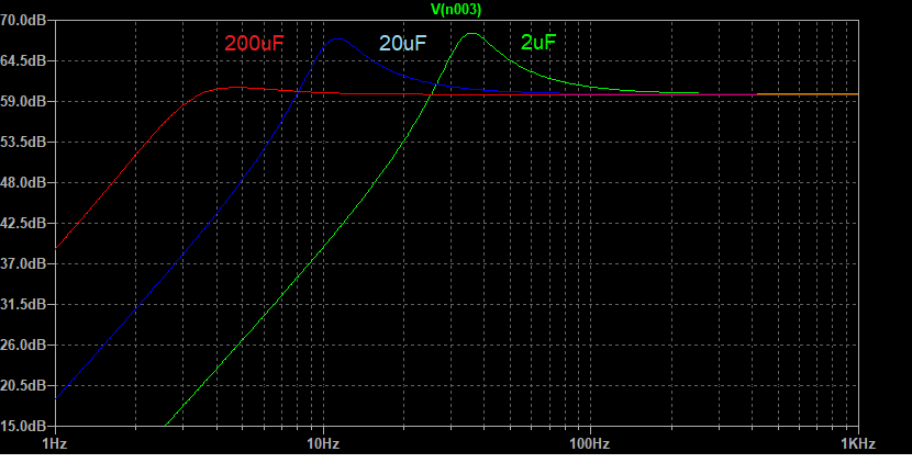

As I played with the circuit, trying to get around using a big electrolytic, I observed the same subsonic effect as Scott's 1000x LNA. I stepped the input cap from 2uF to 200uF.
When I was playing around with it I found that as you go higher than 220uF it goes back to having the rising gain, so there is a sweet a sweet spot, I thought 560uF was the sweet spot, but I really don't know enough to verify that.

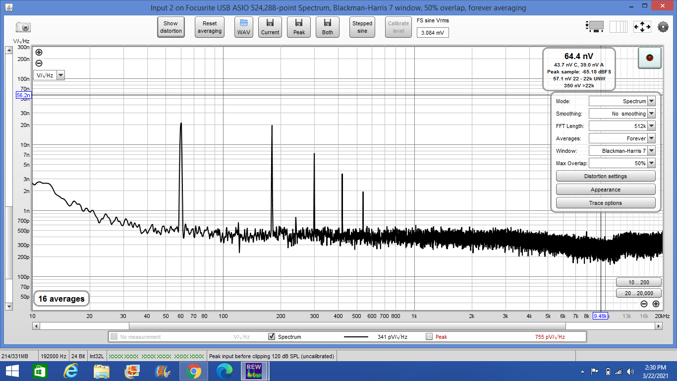

1. JAVA produces the measurement above, ASIO produces the measurement below, at least on my system.
2. The total noise, in the upper righthand corner, is now lower, I changed the transistors in the dienoiser to BC8*7 and was able to get them stable. I don't think the transistors I had in there before were stable.

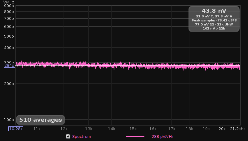

I was wondering, would I also need to subtract the ADC noise from the noise measurements I make? Shorting the ADC I get about 0.28nV/√Hz. Of-course this is with the x1000 multiplier, so it's a sort of virtual noise level. The actual noise is 280nV/√Hz, but doesn't it still get added to the LNA+DUT noise?
That puts the LNA around the 0.4nV/sqrtHz in the 10kHz-20kHz area where I looked.
I'm curious to see if I can reliably extract the LNA noise in the LF range where the ADC adds extra noise.
edit: no I can't, the ADC noise is too high to extract any meaningful value.
