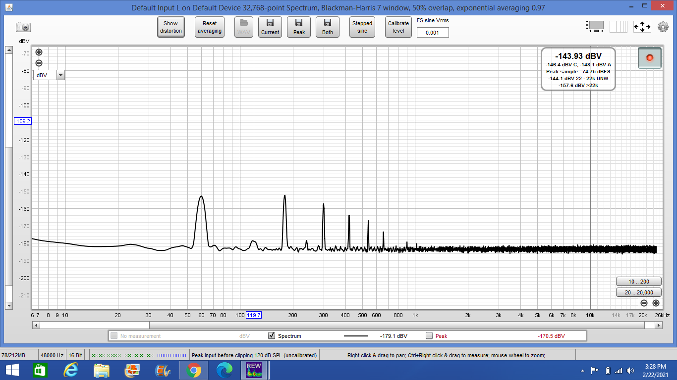

Was calibration right for test with transformer on and VRDN disconnected? If I do the similar, under the desk transformer will show at -130 dBV at 50 Hz, and -160 dBV for the 100 Hz from the nearby rectifier, but fft “grass” is at – 175 dBV.
If everything was right, it is clear that you can’t get real PSRR results due to very strong EMI. Your LNA is picking environment noise at -120 to -130 dBV. Powered on VRDN regulator will shunt most of that but some effect will remain.

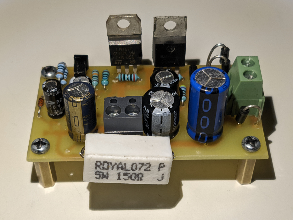

If you want to try something fun you could add those denoiser add-on boards to the VRDN. Remove Cadj and tap the ADJ connection for LM3x7. You also can configure it for dienoiser for better performance. Might be a worthwhile upgrade to the VRDN. Since it's an add-on you can place it such that you get the max performance out of it. For the dienoiser I strongly suggest you install the Panasonic FC for positive and FR for negative output caps.

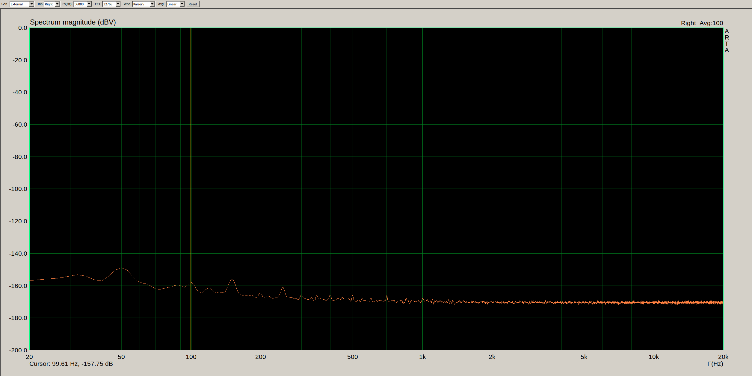

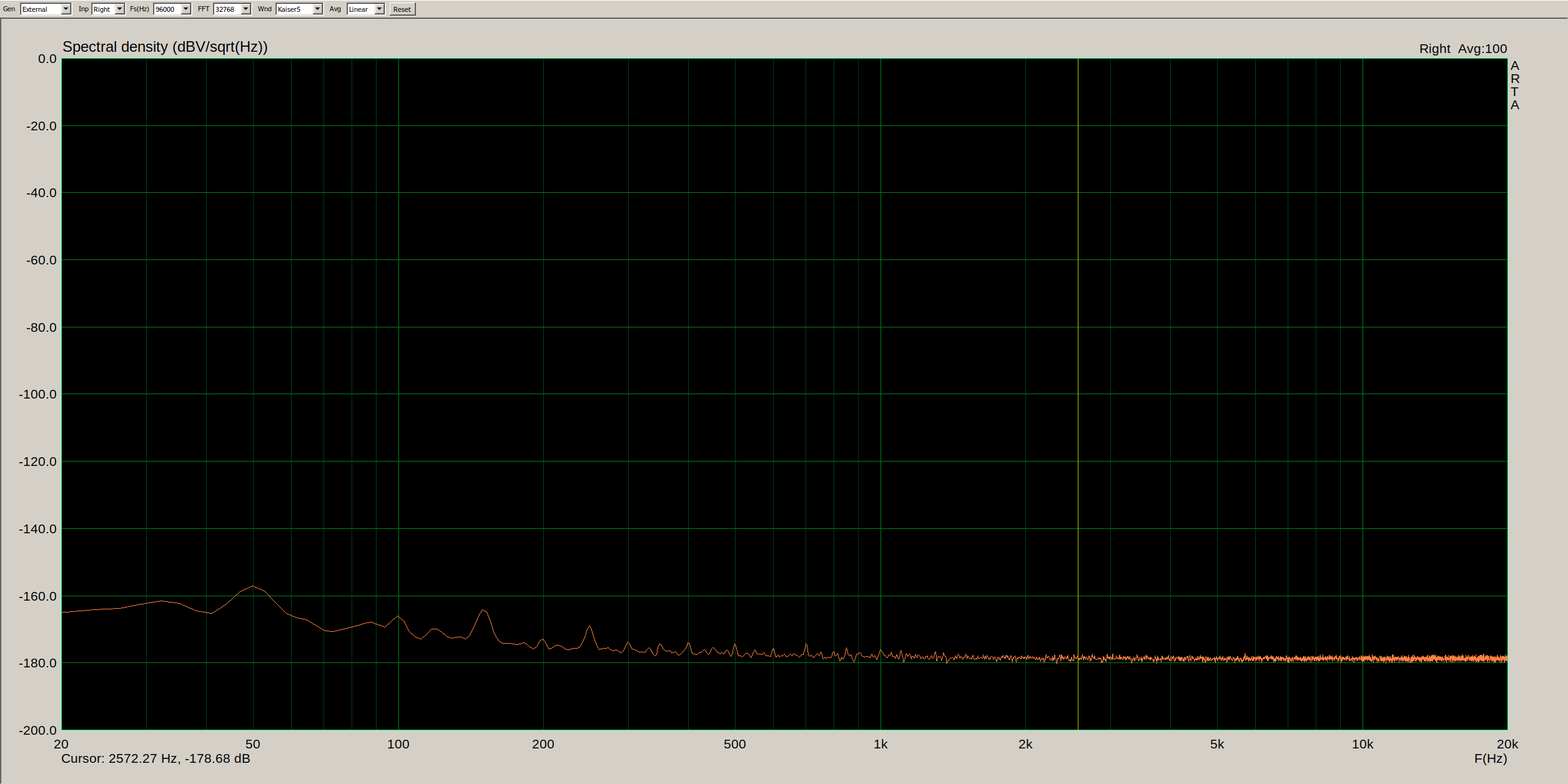

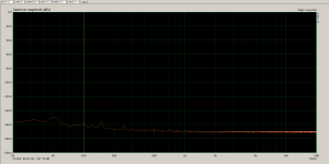

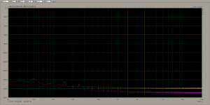

I measured my LM317 board with the capacitance multiplier installed. I measured the denoiser and also the dienoiser. 11.4Vout with 150R load.
As can be seen, the ripple is under the noisefloor. For dienoiser at 100Hz measures -157.75dB with 1.3V for 0dB.
I had my LNA transformer on the desk about 50cm away from the pcb. No shielding for the pcb, it sat on the desk as you see it in the picture.
RickRay has his 0dB set at 2.16V in ARTA, which means a difference of around 4.4dB vs my 0dB point. So he should be able to go at least to -162dB for ripple measurement, on his graph.
Now, the VRDN is larger and I think it theoretically may pick up some noise that could theoretically interfere with the measurement. I'm not sure how much, I had a powered transformer 50cm away from the pcb. The transformer was naked on the desk, no case or shielding.
1st photo is measurement of dienoiser with capacitance multiplier in circuit, second is the noise for the dienoiser. I used a ST LM317.
So ok, I'll give the VRDN that, it could theoretically work in spec for denoiser but it might be too complicated to test with the high input capacitance.

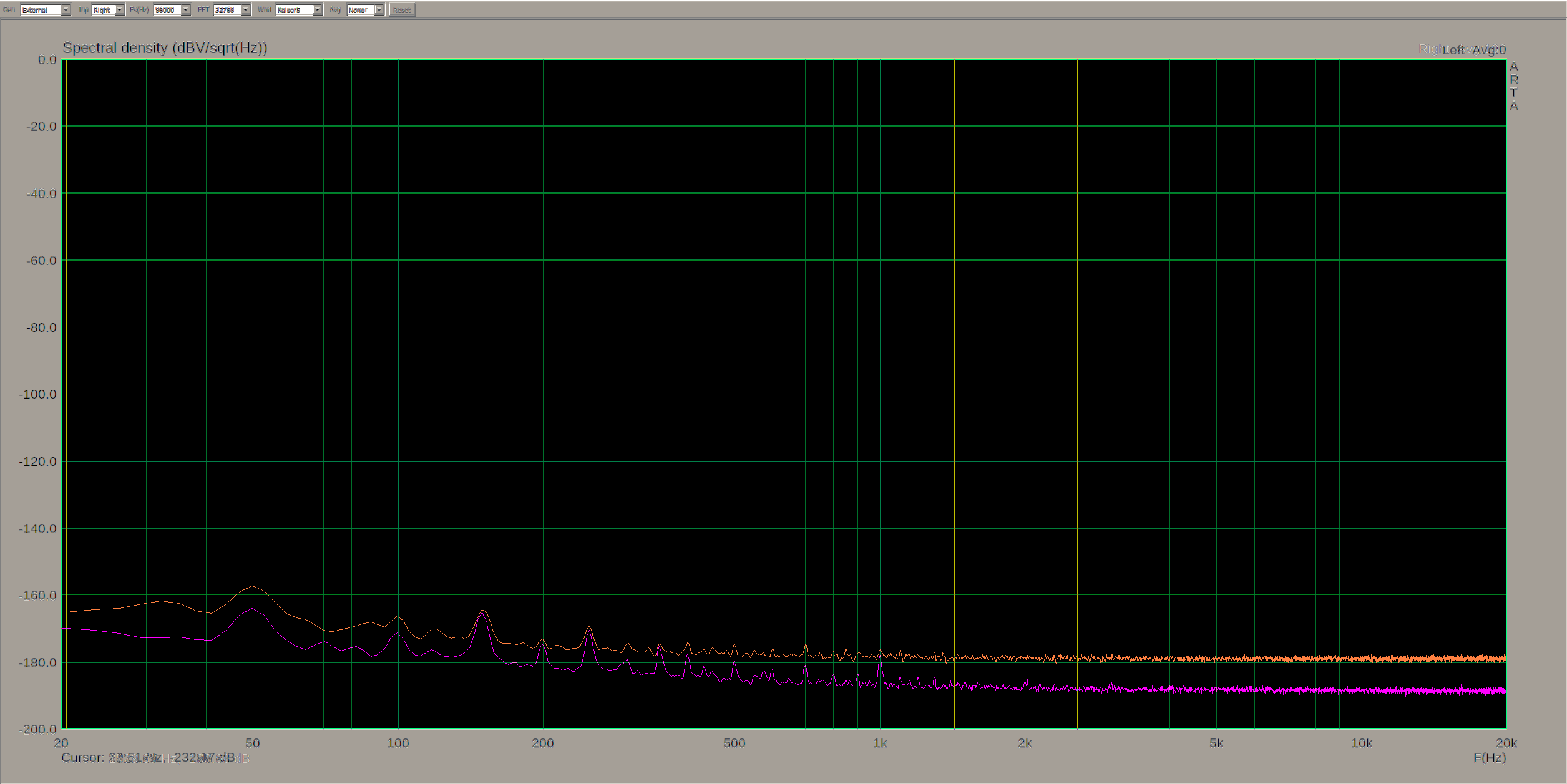

edit: also added a comparison between the LNA noisefloor vs dienoiser noisefloor, for the last picture.
