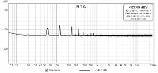

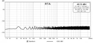

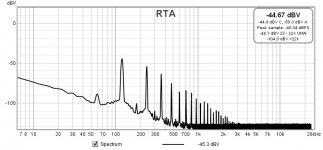

I changed my LNA to be powered by 4 9V batteries. I measured just the positive rail.
Positive rail noise density
Positive rail input ripple
Positive rail output ripple
Tombo suggestion - transformer powered but not hooked to VRDN board
PSRR @120Hz still measures -94.8dBV
Noise density improved more than likely because of changing to battery powered LNA.

This still set to 12V with 66mA load. BTW the noise density didn't improve, measured almost the same, 4.87nV before 5.0nV9 this time.
My LNA's noise came out at around 0.6nV/sqrtHz and if I remember right yours came out at around 0.46nV/sqrtHz as you're using those low noise ZTX BJTs for the LNA circuit. I don't think it affects the noise of the regulator board output, which seems around the 8nV/sqrtHz value on most of the spectrum.
Agree and I'm not seeing any real improvement with measurements from line powered to battery powered.
