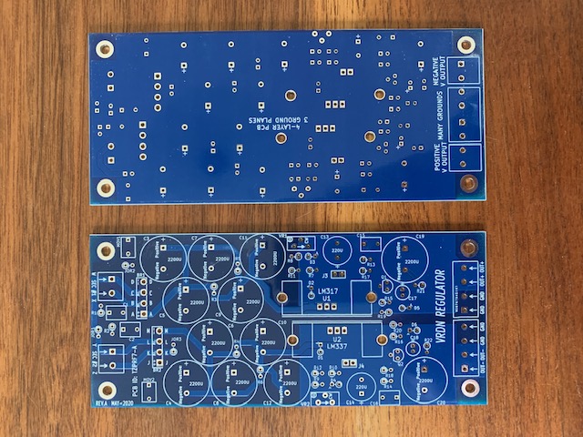

PCP traces, grounds
Hi my friends
I just had a peek at the PCB-layers to see if I'd be able to understand if... the ground-plane is one for all or if they are one per channel...
One for all is correct, isn't it, and this it is sufficient to have just one connection per channel of the line-stage? (and not VRDN-neg, VRDN-pos per channel)
thank you!
david

Low voltage output VRDN
Hi Mark,
as you said repeatedly, this VRDN is based on a straight forward LM317/337 circuit. Why then is the voltage at low end limited to +/-11V? I cannot see a Zener or other ref voltage which in other regulators is a limitation for the output voltage range. Do I need to do changes of the components to go to +/-5V (others than the usual ones) ? Other reasons why you wouldn't use the 317/337 for low voltage?
Hi Mark,
It's your PCB, you own it. Please feel free to stuff and solder it with whatever components you wish. If you use the components and component values shown in post #1 you'll get an output voltage of ±11V to ±20V as you turn the trimmer potentiometer knob from full anti-clockwise to full clockwise. That was my guess about what 98% of all line level circuits would probably want: 12V up to 18V, with a little cushion on both ends of the range. If I guessed wrong for your line level audio circuits, I'm sorry.
If you need regulated voltages less than 11V you can either use a different PCB, one which has been designed and tested and characterized for 5V outputs; or you can calculate new resistor values and new trimpot values for the regulator ICs on this board, plus new resistor values & capacitor values for the Denoiser. The Denoiser can be a source of instability, there are scope photos in this thread of it oscillating(!). That means you'll want to run a lot of checks with a scope and a high current pulse generator, to make sure that your 5V Denoisers (plus and minus) are performing acceptably.
edit- Whoops, I forgot to mention a third option: You can disable the Denoisers using the provided jumpers, which completely removes them from the active circuit. Then you only need to redesign the resistors & trimpots surrounding the regulator ICs.
Thanks Mark,
thats the comment I was looking for. So of course, it's more than just adapting R7/R8/R11. Your last comment certainly is not an option others than using J3 for testing purpose. I will need both, +/-15V and +/-5V so I will play and if I cannot get the 5V output quiet you still can change to lower noise regulators.
Thanks Mark,
