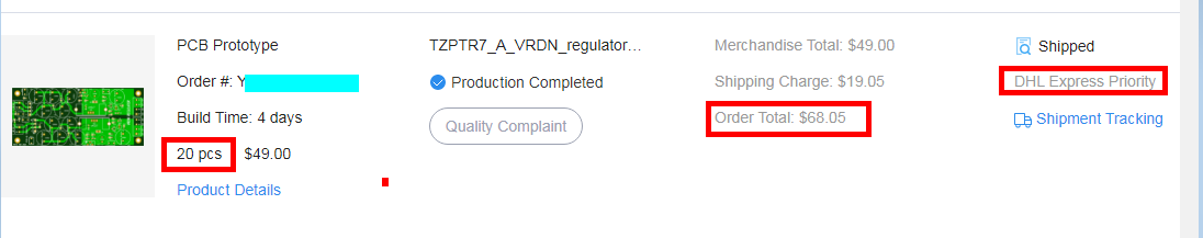

My most recent VRDN order is shown below. I bought 20 PCBs and selected the very fastest shipping option they offered, "DHL Express Priority", which is 3 days from Shenzhen China to my front door in the San Francisco bay area. Total cost was $68.05 for 20 boards, which works out to $3.43 per board. The fab was JLCPCB.

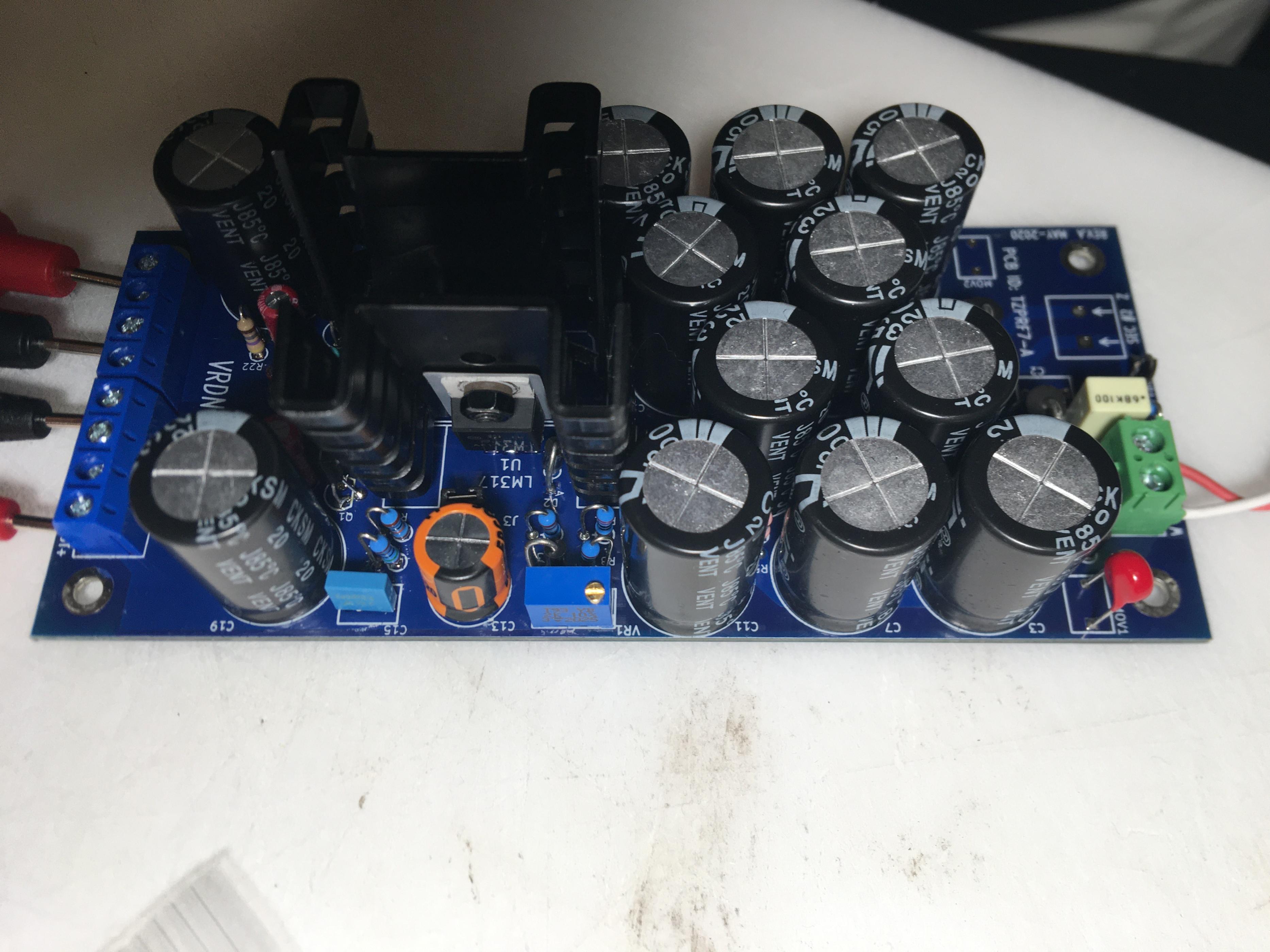

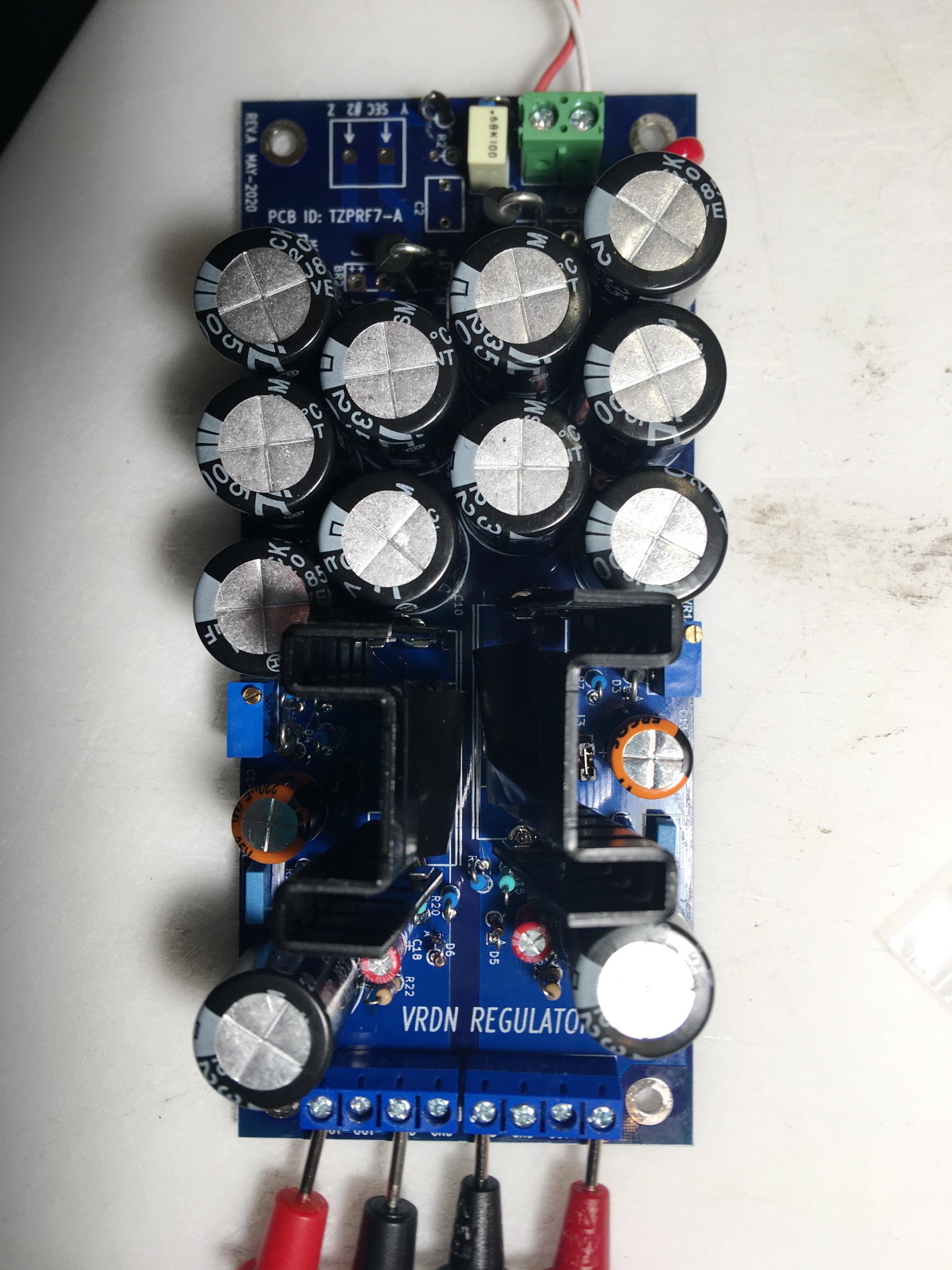

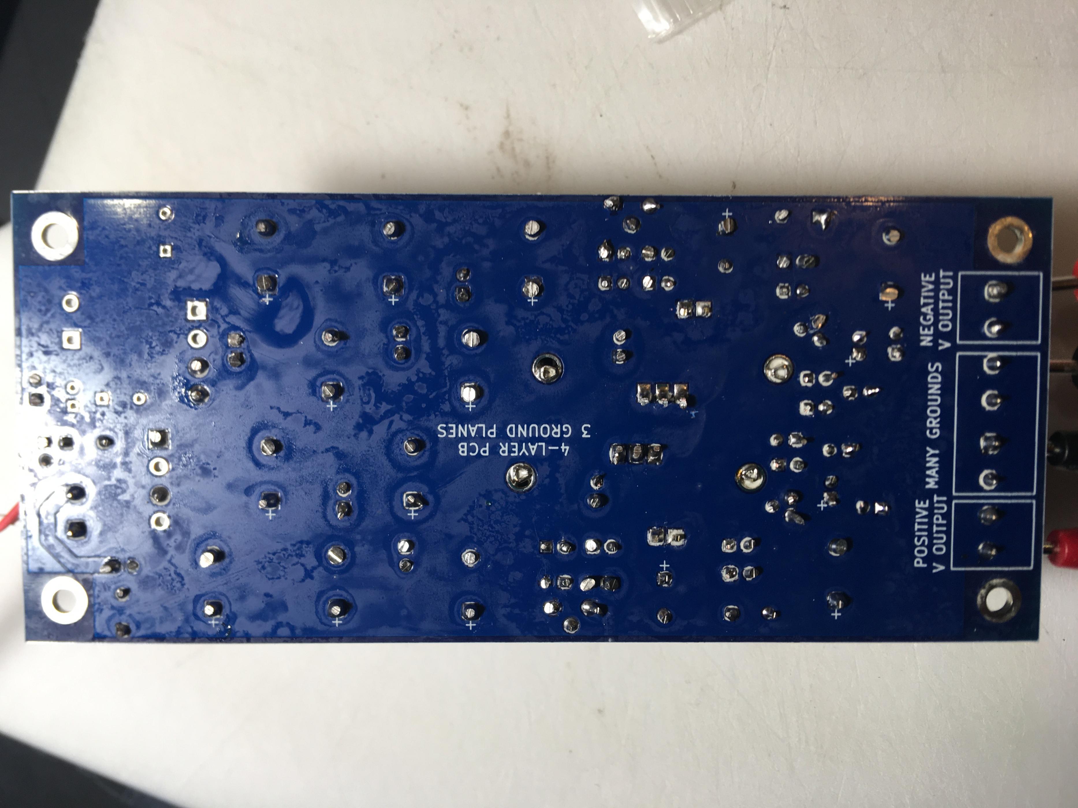

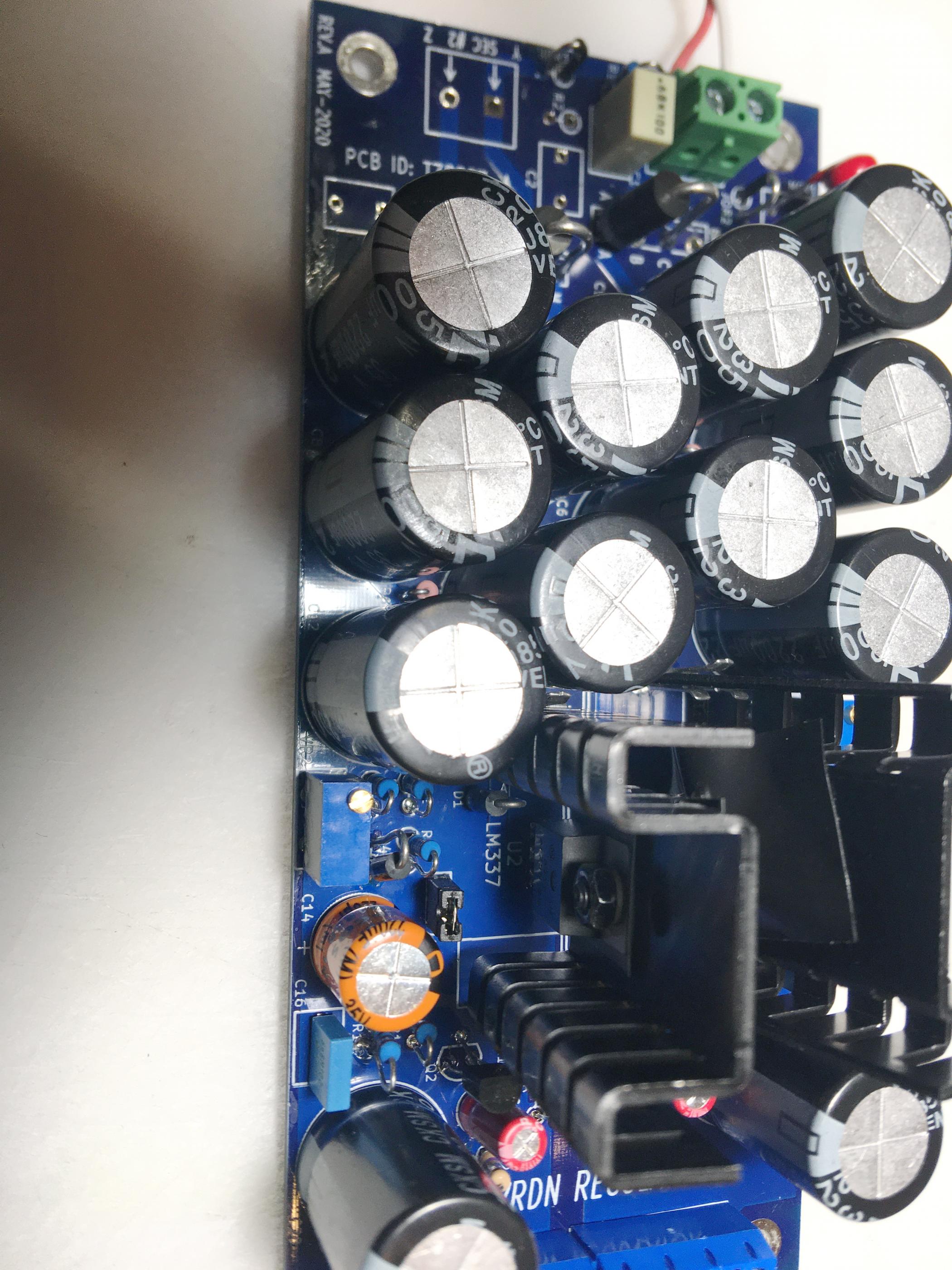

I build a VRDN using a 16VAC Wall Wart. V+ out works perfectly. V- out is dead with no voltage output at all. I have tried it with and without the denoiser jumpers and that makes no difference. I've looked at the boards closely and I don't see any problems with the soldering or with shorts. I'm not quite sure what I should check/replace that would be most likely to cause a total failure of the V- Rail. Any suggestions? Pictures attached.

Please take a photo from an angle like this one, so the three jumper wires (arrows) are clearly visible. Also, please make sure that your photo shows the "bands" on the cathode ends of the diodes. This picture doesn't show them very well.

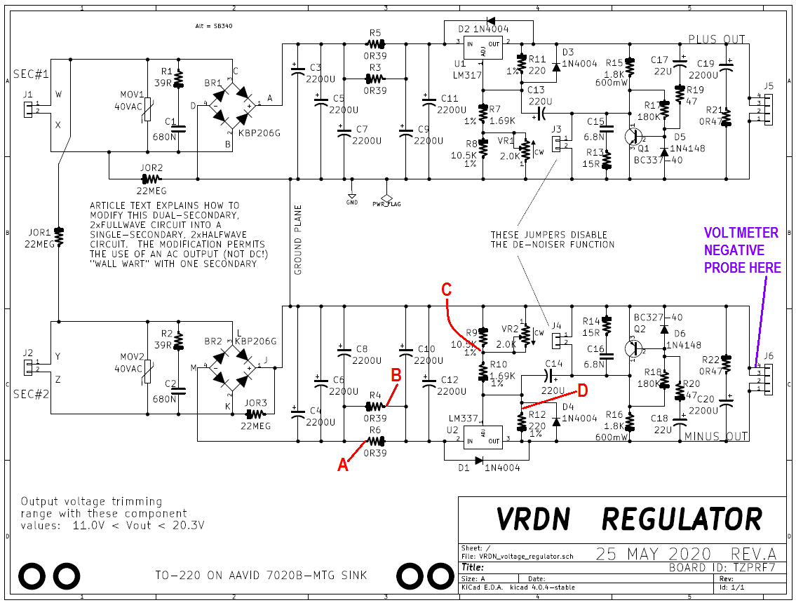

Next, if you stuffed the vertical mount resistors exactly as indicated on the PCB silkscreen graphics, you'll have access to several important circuit nodes via the flying wireloops on the vertical resistors. Please measure the voltages at nodes A, B, C, D and write your measured voltages on the schematic. The fat end of the schematic symbol for vertical resistor, is the abutted end -- the non-flying-wireloop end -- on the PCB. The normal end of the resistor symbol is the wireloop end.

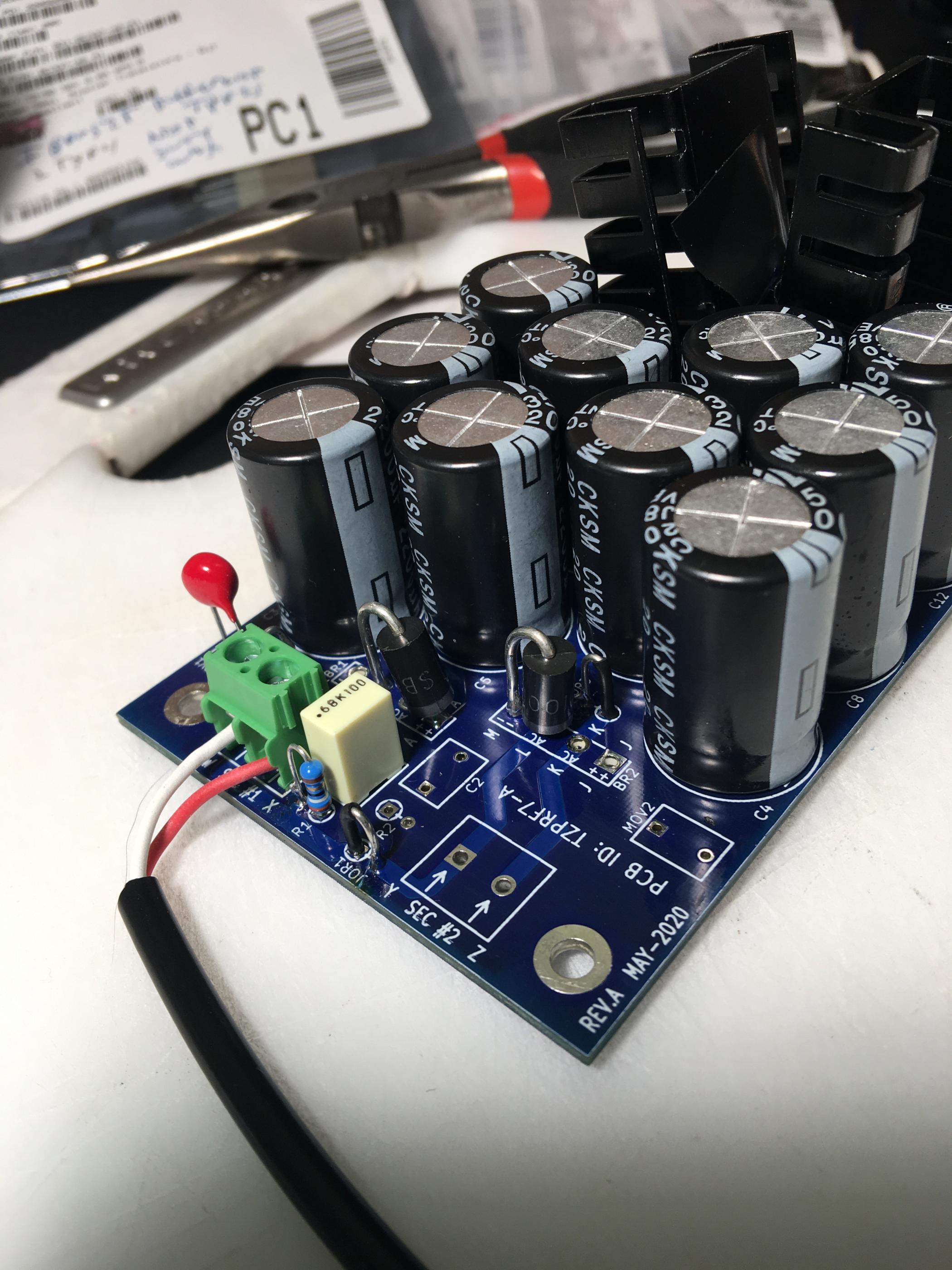

Here are photos of that end of the board. Even though the butt end of one of the diodes is different from your picture the cathode still goes into L.
So a little more information. The first time I tried to test the board I kludged up a connection to the wall wart and the positive still tested 16V but nothing on the negative rail and then the wall wart got friend which I attributed to my moving the board around and causing a short where I was attaching to the wall wart. Then with the second wall wart and the proper female plug and I used a dim bulb tester and that was when I got readings on the positive rail but nothing on the negative rail and no fried wall wart.
To try and measure your voltages I removed the dim bulb tester and after a few minutes the wall wart got fried again. Before it died I was able to measure 190mv at R6. Also, weirdly, even though the wall wart was putting out 19 volts not connected to anything it only read 13 volts at the incoming terminal blocks. J1. Positive rail read 16.5 volts before everything died.
I must have a short somewhere on the negative rail that is causing the wall wart to fail when it isn't connected to a dim bulb tester. Might still fail but maybe it takes longer to over heat?
This is getting expensive in wall warts and it will take a couple of weeks to get more. Is there a way of locating the short that doesn't fry wall warts every time?

Your 3 jumper wires are installed correctly and your two diodes are also installed correctly.
The fact that the wall wart's output is 19VAC with no load, but drops to 13VAC when connected to the VRDN input terminals, means that VRDN is drawing an abnormally large, erroneously large, current from the wall wart. This could be caused by a short on your PCB.
The first thing I would do, is check to see whether the two diodes behave the same. If they don't, if their behavior is wildly different, then it's likely that the diode on the negative side has probably failed. Since the positive supply seems to work, it's likely that the diode on the positive side is okay.
I'd set my DVM to the lowest range of Ohms measurement (not continuity "beep" testing, Ohms measurement) and attempt to measure the resistance of the diode on the positive side. Do this once (red probe to cathode, black probe to anode) then swap the probes and do it again (black probe to cathode, red probe to anode). Write down the results. Now measure the diode on the negative side with the same procedure. Write down the results. Did the two diodes behave the same, or not?
To avoid destroying more wall warts, you could install a 3 watt, approx 100 ohm resistor in series with one of the wall wart wires; it doesn't matter which one. Now even if VRDN is a total dead short, your wart only provides (16.5 / 100) = 0.165 amperes; 2.8 watts. That is unlikely to burn out your wart.
You can create a 3W 100R resistor by connecting twelve 1.2K, 1/4 watt resistors in parallel. Or whatever you have in your parts box, do series/parallel calculations to get 100 ohms and >3 watts.
If you happen to own a variable voltage "lab" DC power supply with variable current limiting, it's pretty likely that you can use that instead of a wall wart, to troubleshoot your faulty VRDN. The power supply protects itself, while you protect the VRDN. You pick a current-limit number low enough (suggestion: 40mA) to ensure you don't accidentally melt your VRDN. More info on that after you post a photo of your DC power supply.
Finally: please verify that the IC voltage regulator on the negative side is part number LM337, middle digit is "3". Maybe there is a parts stuffing mistake?

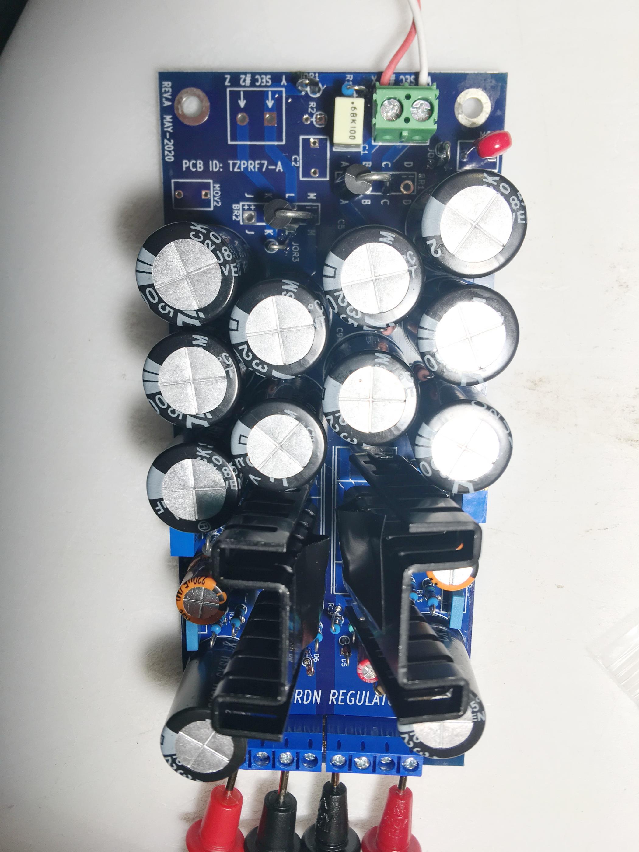

Thanks for the suggestions Mark. I have an auto ranging multimeter which hopefully doesn't make a difference. Both diodes measure the same. Positive to Anode 3.14K Ohms. Positive to Cathode 9 M Ohms.
Voltage Regulators are on the correct sides.
I am going to have to put this on hold for a couple of weeks but I will give your suggestion with resistors a try.
