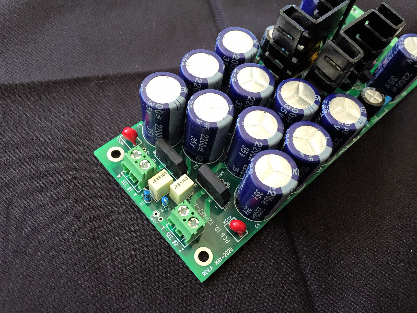

It sounds to me like there's probably a short circuit between the negative unregulated supply and ground. Either in one of the negative filter capacitors C4, C6, C8, C10, C12, or else in the negative regulator IC LM337 itself.
If you've got a way to run the board for minutes at a time without destroying another AC-to-AC wall wart, I suggest you unsolder and remove those caps one by one. Power up after each unsoldering and determine: did the short disappear? Leave C12 for last. If there's still a short with only C12 and the LM337, remove the LM337 (leaving C12 installed) and test. You can do this by cutting the pins of the TO-220 and then unbolting it from the heatsink. Next unsolder the remaining stumps of the cut-off pins.
If you don't have a way to electrically test the board without possibly damaging your wall wart, I suggest you unsolder all five caps and also remove the LM337. Check with your ohmmeter to see if there's still a short. Reverse the probes and check again. You won't know which component went bad, but you will know the failed part is in the trash can and not on your PCB.
All of this unsoldering work is potentially risky, you might accidentally lift off a copper pad, or cut a trace, or burn up an adjacent component. There is a chance you might be forced to start over with a fresh bare board and brand new components. If that happens I recommend you build the complete negative regulator half of the board first and verify that it works. Sweet Victory! Persistence, hard work, and stubbornness have carried the day. Then build the positive half and enjoy the music.

I can attest to the difficulty of unsoldering on this board. Solder wick works very well and I found sometimes it works better to add more solder to the joint, then hit is with the wick. I also turned my iron up to about 400C, that increases the risk of lift and burning.
Thanks Mark. I hadn't thought about that approach to troubleshooting the problem and I am going to give that a try.

Thanks to all of you for the suggestions. I followed Mark's advice and got lucky because the first capacitor I pulled was C10 and that turned out to be the cause of the short in the board. As soon as C10 was removed I was able to measure -15 V at the output. After replacing C10 and removing the Dim Bulb Tester and 100 Ohm resistor (better safe than sorry) I was able to adjust the pots to give me exactly 18 volts on both the positive and negative rails! Now my next step will be to see if I can get the VRDN working with the Wayne's BA2018 boards I have built.

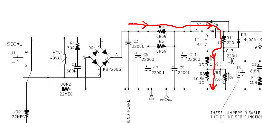

VRDN converts AC into DC -- a typical configuration would be 18V AC input and ±15V DC output. The AC comes from the secondary winding(s) of a transformer, which might be an AC wall wart if the builder chooses that option.
There's no line level voltage anywhere on VRDN ... which is why it uses filter capacitors rated for "only" 35 volts, see attached photo.
When the mains AC applied to the transformer is switched off, VRDN's filter capacitors are discharged through R11-R7-R8, plus the (much smaller) discharge current through R15-Q1. These current paths (a) discharge the output DC voltage all the way to zero; and (b) they also discharge all of the 2200uF/35V electrolytic capacitors to {very roughly} ~~ 2V, before the regulator ICs cease conducting. If you don't want those capacitors sitting around at 2V for a few hours, feel free to add a bleeder resistor in parallel with C11, on the back side of the PCB. A conservative choice would be Rbleeder >= 5.6K with 600mW rating. That way, during normal operation, even if the caps were operating at 34.999 volts, just about ready to explode from overvoltage, the power dissipated in the bleeder resistor would be only (35 * 35 / 5600) = 0.22 watts. Comfortably below the max rated power of the bleeder resistor. You can calculate the timeconstant of the discharge event ... it's a lot quicker than "a few hours".
