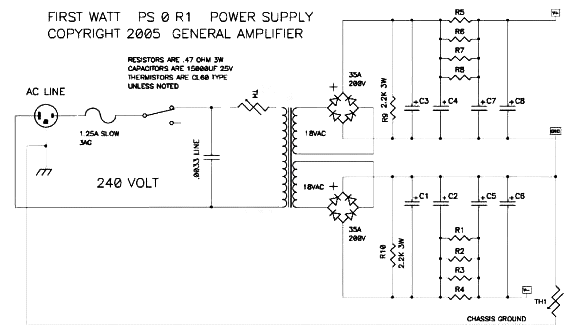

But I don't understand how to connect the primaries to the power inlet. The Toroidy has only two wires for the primary. I'm looking at the diagram for the First Watt F5. This seems to have 4 wires for the primary.
My best guess is the "load" wire from the mains input runs through once CL60 thermistor to one of the primary windings, and the "neutral" wire runs to the other primary wire (just straight connection).
Do I need two CL60s? If I trace the F5 diagram, and assuming the C9 is an open circuit/air gap (i.e. not installed), then I see two circuits (main - transformer - main) and each circuit has a single CL60 on it.
And what do I do with the safety cap (C9 in the diagram)? That works to isolate the two primary transformer windings from each other (once it is charged). I only have one primary winding.

The 4-wire connection is for choice of 120V or 240V supply.
That transformer is 240V-ONLY. I hope that what you have in your wall.
Putting the TH part between the two windings is a neat way to keep the builder out of trouble from extra wires. Since you don't have extra wires, you simply put the TH part in series with the one winding.
Thanks, PRR, that clarifies it perfectly. I'm EU, so the odds are good that I have 240 in the wall 🙂.

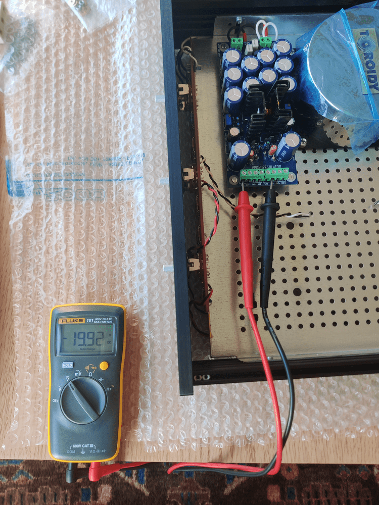

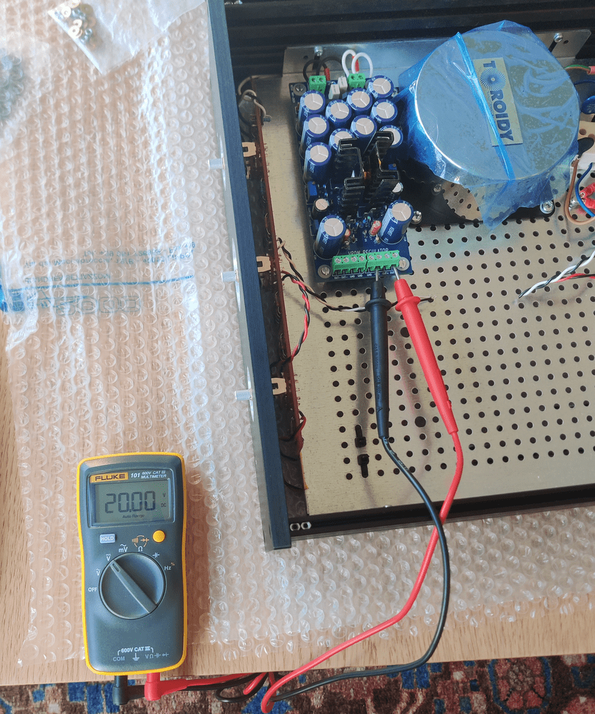

Success!
Except for a ground fault with an RCA jack (now fixed, but can I talk with the person who designed these? Like that little plastic collar is really the best way to insulate??) it works flawlessly.
Many many thanks to all the forum members who helped me with this project, directly or indirectly. This never would have happened without you.
Also a quick shout-out to Gianluca at Modushop, who made the case for me (and who generally provide a lot of support for DIY Audio). The case was a joy to work with; it has so many well-thought out and helpful little features, and Gianluca was very helpful with some of the design of the cutouts (and machined them).

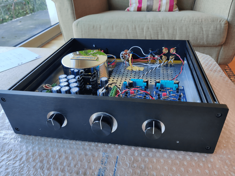

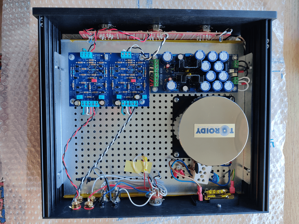

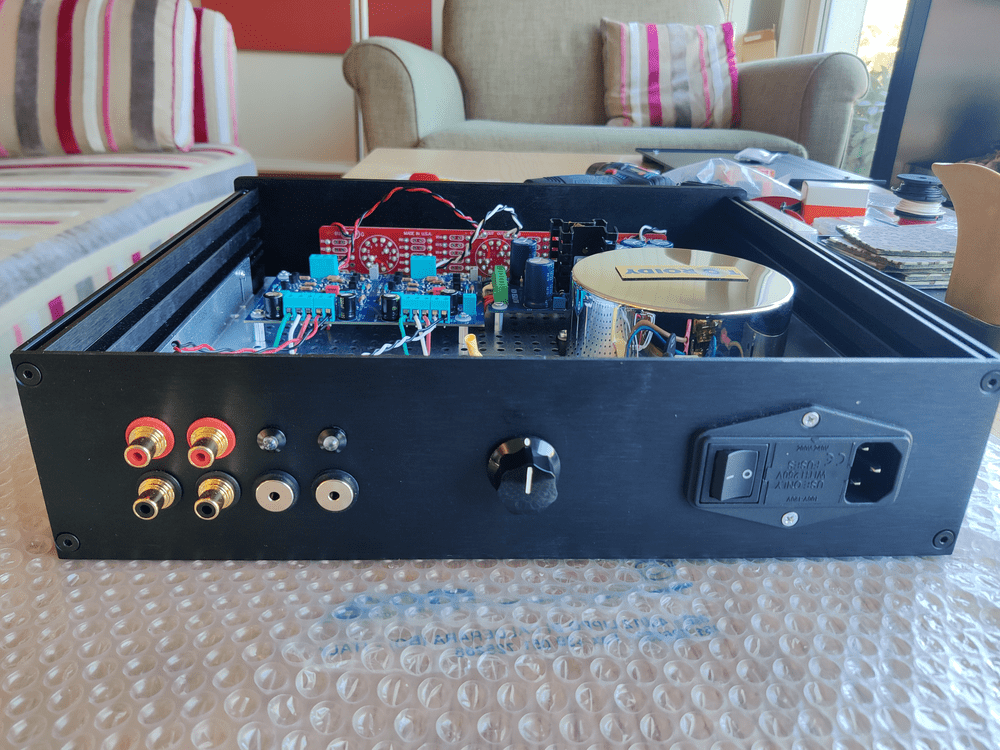

Yes, select switch is in the back to keep the face clean. Also, I don't have much audio equipment-- the shame of my setup is the main input is my cell phone playing spotify or my synth. I doubt I will use the RCA inputs, they are "just in case" -- so I don't have a lot of use for the switch.
The two inputs you ask about are 3.5mm jacks, one for each of these inputs. The synth wants a dedicated input because it outputs +/- 10V, and I need to dump some of that to ground before it hits the preamp circuit. Cell phone is (probably?) closer to +/- 1V.
I have two LEDs above them, one blue and one white. This lets me code 3 indicators of what input is on. You see the blue spot on the radiator in the badger photo? Blue LED, middle 3.5mm jack.

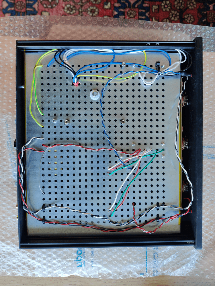

Thanks. Had to do something with all of those little holes! here is the view underneath, inside the bottom cover.Congratulations, @hbadger! I really like the way you've used the perforated steel "floor plate" to keep mains wiring tidy.

I don't want to be critical, but that's potentially dangerous, since the holes are likely not smooth and could, over time, erode the insulation, and then you get a short. When you do mains wiring with metal boxes, electrical codes usually require the use of some kind of relief around the entry and exit points for this reason.Congratulations, @hbadger! I really like the way you've used the perforated steel "floor plate" to keep mains wiring tidy.

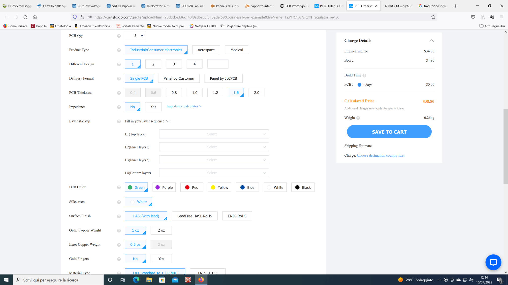

Hello folks, I would like to build the VRDN and first step was ti get board from jlpcb. After upload of gerber files get the message :
Detected 4 layer board of 62x142mm(2.44x5.59 inches) .
Your upload has finished processing. Enter the project details below and we'll move on to checking all the individual layers to make sure that they're correct.
asking to fill a layer sequence as show below :
where appear 4 dropdown menu ( TopLayer, InnerLayer1,InnerLayer2,BottomLayer) . Since I'not expert about gerber composition is it possible to have a suggestion on the correct selections to insert?? Thanks in advance
I had the same question and I think the answer was to forget about it, all shall turn out fine. JLCPCB are good at getting back to you if there are issues.
