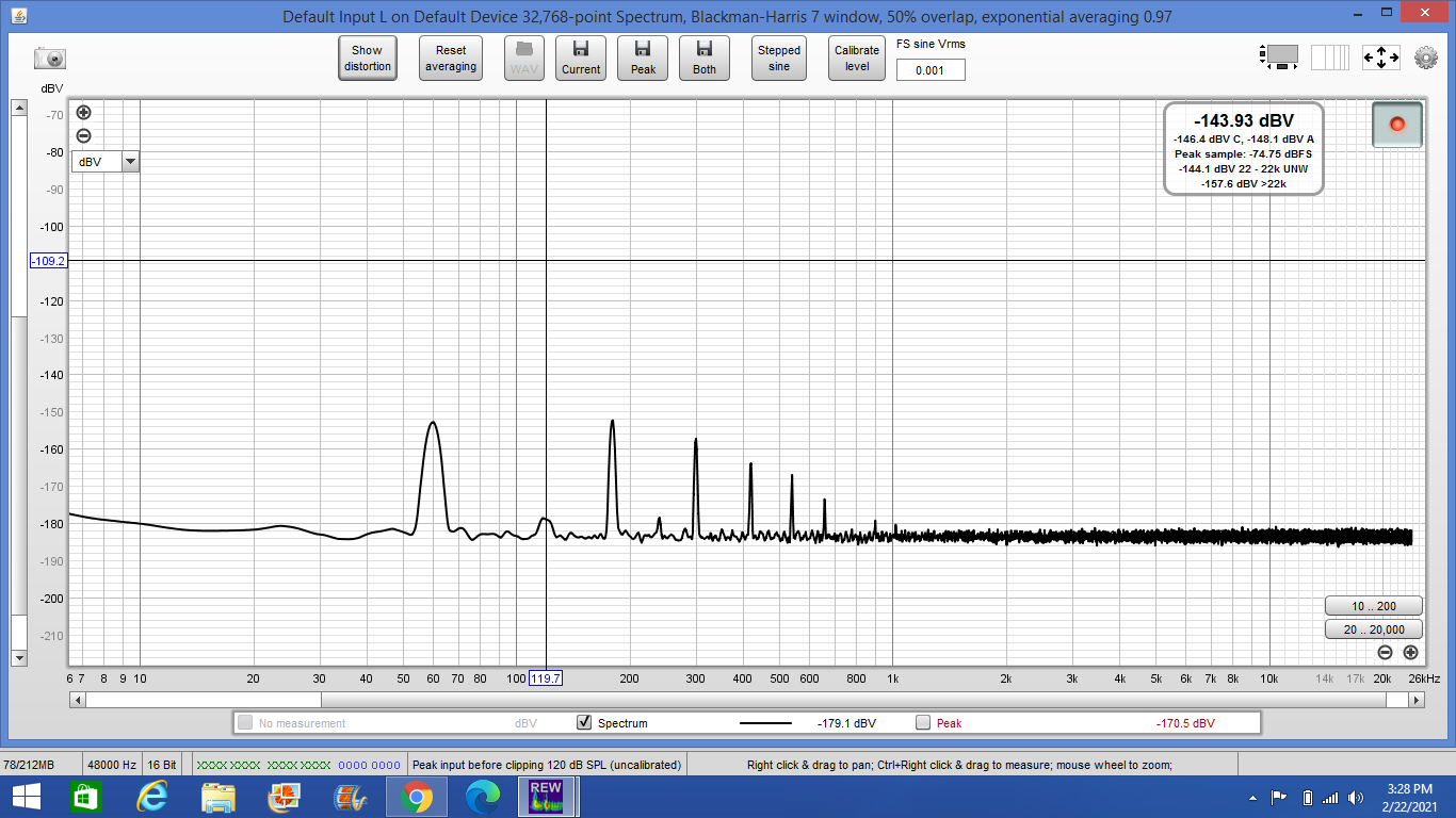

Another thing for the consideration is S/N ratio we can obtain in our amateurish conditions. This was clearly demonstrated on the VRDN measurement case.
Using adequate for the task LNA, RickRay was able to get clean fft graph with no 60 Hz or 120 Hz voltage, of resistor connected directly to the LNA input, at 4 nV/rtHz.
https://www.diyaudio.com/forums/att...el-ckts-11v-20v-1-5a-de-noiser-calibrated-jpg
So, we can reliably measure at least to that low level, right?
No, we can’t. Attaching measurement cables and connecting them to the DUT, changes situation. This is illustrated here:
https://www.diyaudio.com/forums/att...lvees-de-noizator-implementations-capture-png
For this, VRDN board was not connected to the transformer, otherwise 120 Hz ripple would be much higher. On that picture we see 60 Hz voltage to be at cca. -150 dBV (about 33 nV) as environment electromagnetic noise was inducing noise voltages in cables and DUT.

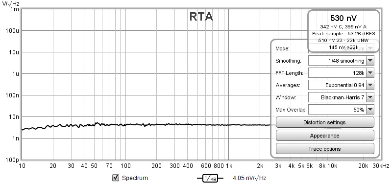

He also measured a 1k resistor for noise and is around 4.1nV/sqrtHz at 2-3kHz zone. And the noise of his LNA came out at around 0.46nV/sqrtHz at the same 2-3kHz.

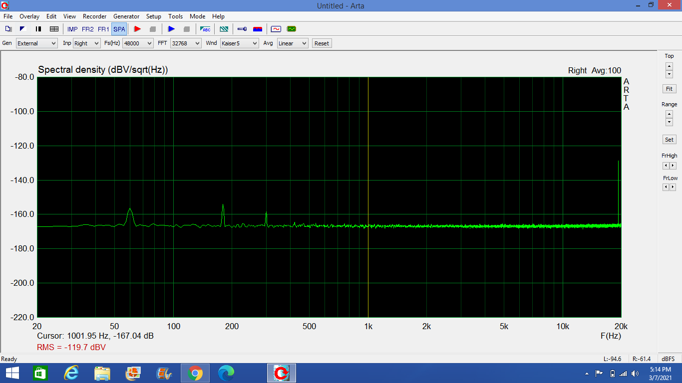

Calibration in ARTA
Anyone here familiar with the calibration procedure in ARTA? I have a signal generator and am able to input 1vrms into the correct channel and perform the calibration process. When I do this, the graphs produced by ARTA directly display the correct values, for example a 1k resistor connected to the input of an LNA measure approx. -168dBV/sqrtHz and a 1 volt rms signal displays as 0dbV. What does the input sensitivity number that ARTA represent? ARTA calculated 4369.21mV when I input 1Vrms. I do not know if the number determined by ARTA is peak or p-p.
Would like to understand this as well. So far I've used a value for input_sensitivity which when measuring the noise of a 1k resistor, the value in dBV/sqrtHz that it shows translates correctly applied to the input_sensitivity value (which I consider 0dB point) I have in ARTA.
ARTA manual shows that the dBV values are calculated based on the input_sensitivity value and preamp gain setting.
Yes, RickRay is right, ARTA calibration value works as it does in REW, you calibrate and then read the dBV values relative to 0dB=1V, regardless of the calibration value in mV that it found.
I did manage to install REW in linux (forgot about java 8), and calibration spits out 1.47Vrms. But there's one issue in REW. If I add the LNA gain and I write 0.00147 and press enter, the 47 bit disappears and only 0.001 is left in the box. With a 1k resistor the noise is still around 4.02nV, just that if I alt-tab into another window, and come back, the noise drops to 2.8nV, so it does a kind of "refresh" and only reads the 0.001V value for calibration, and moves the graph down a bit.
So not really usable with adding the 60dB from the LNA, which is really a shame. Hope they fix this issue.
On another note, I used the value REW found, in ARTA, and seems to be working fine, as RickRay correctly was trying. The 1k resistor noise measures at -167.86dBV which with 0dB=1V is about right. With 1Vrms input signal ARTA shows it at around -1dB so that seems pretty good to me. I'll keep using ARTA, I don't like that gain thing in REW.
Because I used that different method of reading the measurements, the low level signals I measured lately should be in the same area.
My LNA noisefloor measured at -185.68dBV/sqrtHz at 2.5kHz which is around 0.52nV/sqrtHz.

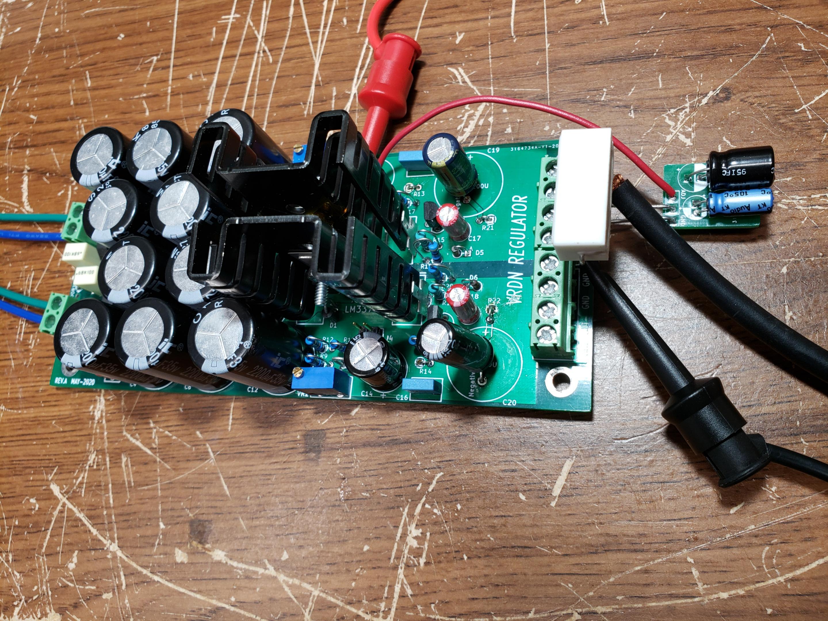

VRDN Measurements
I have learned so much working with all these different boards, but have a lot more to learn I know.
I decided to implement an add-on board to the VRDN to see if I could increase the PSRR. The answer is yes. I believe the ground planes are picking up EMI that is out-of-phase with actual EMI and the out-of-phase EMI gets amplified and sent out.
By implementing an add-on board at the output of the VRDN I was able to gain 13dB of PSRR with a denoiser add-on board. The Dienoiser board added 17dB of PSRR and of course lowered the noise level.
I added the add-on board by connecting the V+/GND connections right at the output connectors. I removed the 220uF coupling capacitor and connected the adj. connection at the add-on board to the adj. pin of the LM317 where the capacitor was.
1kohm resistor noise measurement
VRDN stock Denoiser disengaged or Cadj. only measurements:
Noise@1kHz = -135.31dB or 171.5nV/sqrtHz
PSRR@120Hz = -83.6dB
Stock denoiser engaged measurements:
Noise@1kHz =-164.93dB or 5.6nV/sqrtHz
PSRR@120Hz = -100.99dB
Add-on denoiser implemented, stock denoiser not connected to coupling cap:
Noise@1kHz = -164.54dB or 5.9nV/sqrtHz
PSRR@120Hz = -114.08dB
Add-on Dienoiser implemented, stock denoiser not connected to coupling cap:
Noise@1kHz = -176.36 or 1.5nV/sqrtHz
PSRR@120Hz = -118.08dB
Measurement graphs in next posting.
