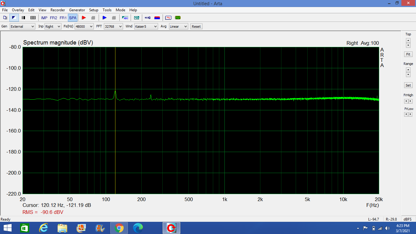

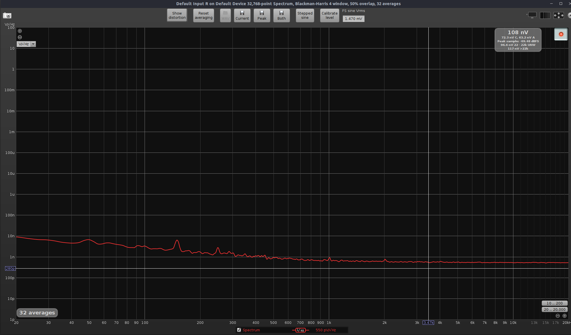

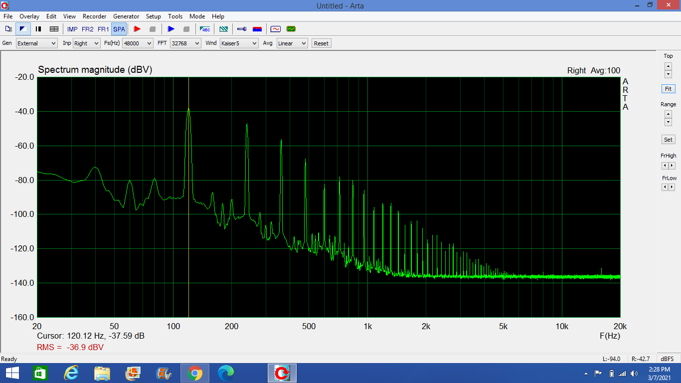

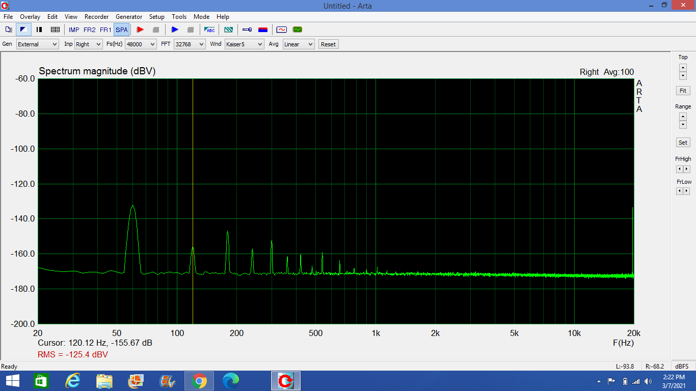

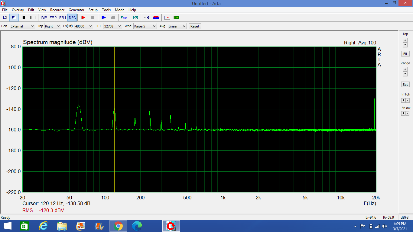

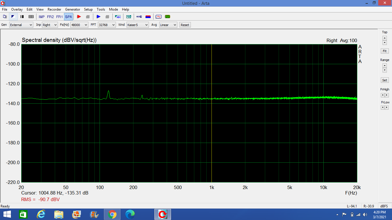

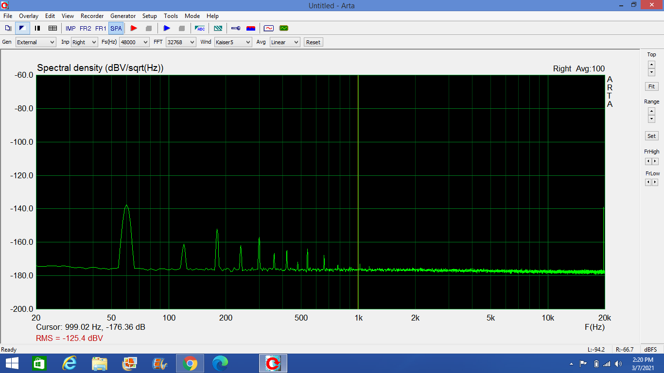

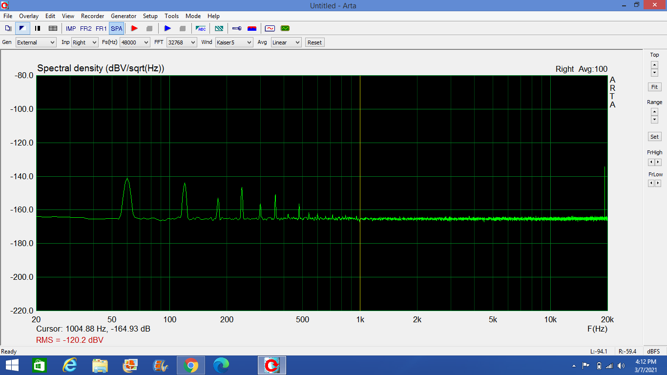

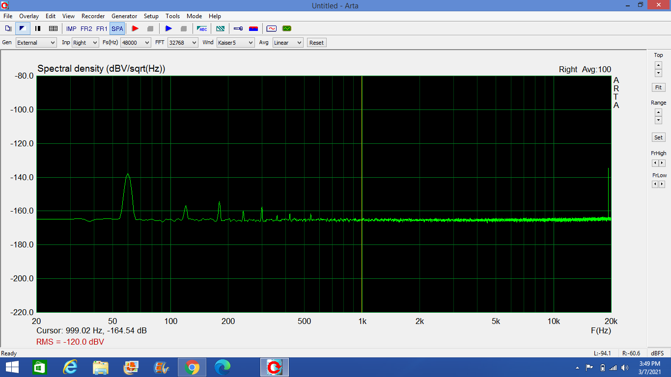

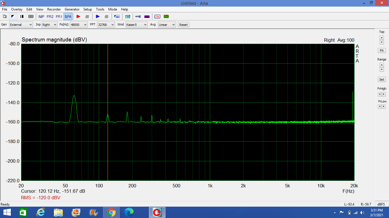

All measurements taken on positive rail at 12volt output, 66mA load, boards upgraded to Rev. A2 except output capacitor changed to Panasonic FC 100uF/63V.
VRDN Positive Rail input Ripple
Positive Rail with stock denoiser disengage noise
Positive Rail with denoiser disengaged output ripple
Positive Rail with stock denoiser engaged noise
Positive Rail with stock denoiser engaged output ripple
Positive Rail Add-on denoiser implemented noise

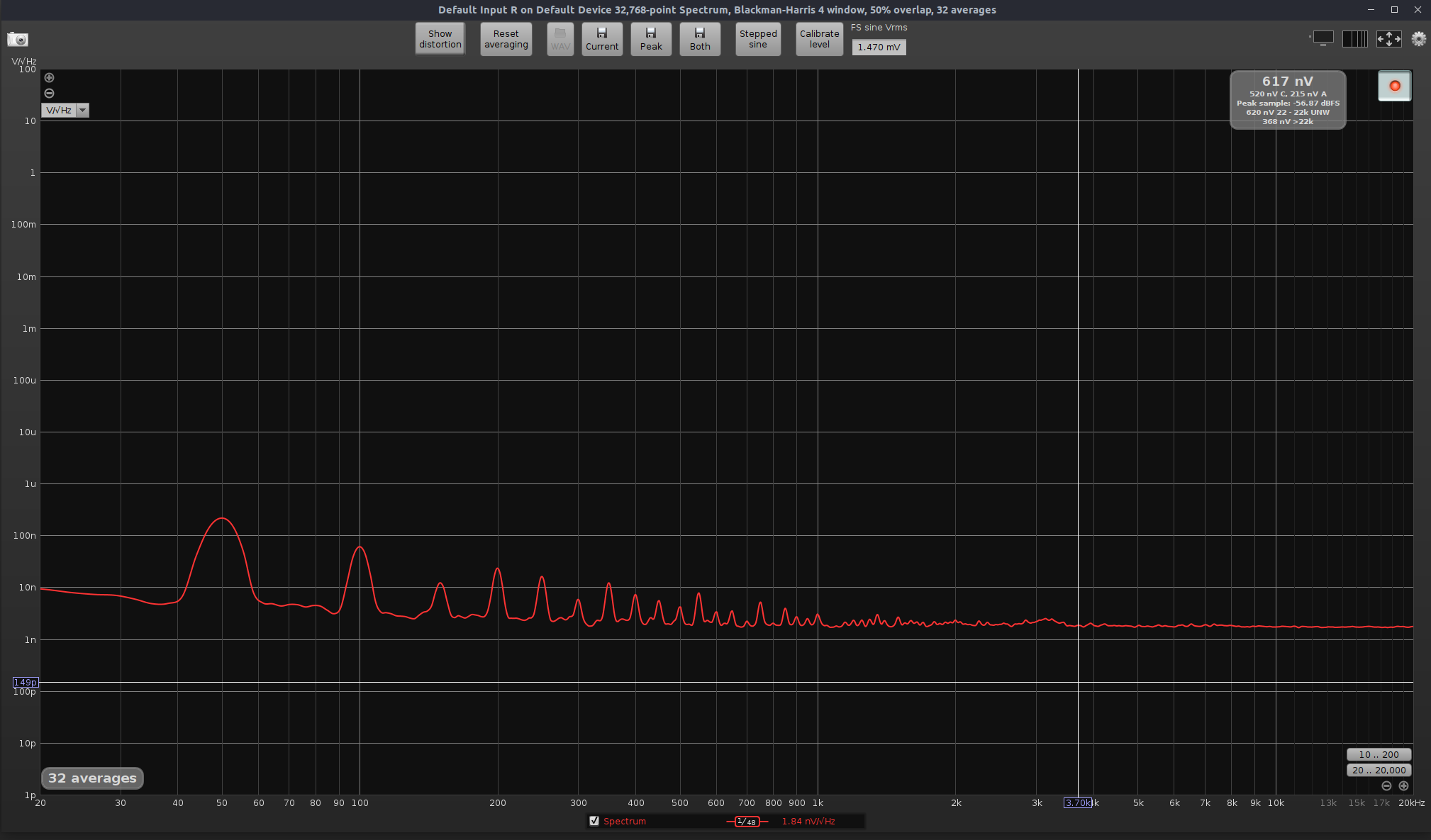

Is your measurement setup arranged in a better way as now you measure 100 dB PSRR on stock VRDN board using only 10 mV (-40 dBV) input ripple levels?
What is the difference between noise and PSRR measurement data? On all measurements, noise floor should be at the same level, but it is 5 dB higher on all measurements labeled as ripple, while on both noise and ripple level measurements, 120 Hz ripple is by same value above the noise floor, meaning that in both cases there was load on the output??
In fact, the same measurement can be used to assess both noise and PSRR levels, but which one is right?

I think in ARTA while measuring PSRR the noisefloor is not to be trusted as shown value. That can vary depending on the FFT resolution. Some others have mentioned this. But the noise should be correct while measuring in the noise density graph. His 1k resistor noise seems to be right as well.
And of-course there's the thing about the differential measurement between the onboard denoiser and the add-on denoiser which should be pretty clear. I think he used the same conditions for these tests, same Vout and load.
Unless you think that he as well is manipulating the data?

@Tombo56 - I have an adequate de-soldering solution, I don't think there is such a thing as aa good de-soldering solution. Anyway, I haven't lifted any pads yet. The best way I have found for this board is 375 degree Celsius heat for soldering iron and fine solder braid.
For these measurements I made sure everything on the bench was turned off and everything on the same power circuit turned-off. That was for all measurements in this batch. Other than that, that is what was measured that day.
I mislabeled the noise, it is either dBV/sqrtHz or nV/sqrtHz. That is a noise density measurement that takes into account bandwidth.
Ripple was measured using the dBV scale and if you notice in ARTA, the result at the bottom is labeled as dB.
Of course, these aren't the same scales, so of course they measure differently.
Yes the load was identical in all the tests, 180ohm resistor across the output connector at 12 volts for a 66mA load on all tests. All these tests where ran in the same time period.
You can verify my findings very easily, breadboard a denoiser and connect it to the output of the VRDN. I'm confident that even a breadboard implementation will show an improvement in PSRR. It won't show an improvement in noise. If the denoiser is working, the noise will be at denoiser level. Notice that the noise level between on-board denosier and add-on denoiser are pretty much the same. You've taken enough of these measurements, I think, that you can see those two readings are basically the same because they do drift up and down slightly.

@Tombo56 I believe you are comparing the measurements posted in the VRDN thread when you say I can now measure better. The measurements in the VRDN thread were taken with the wrong calibration. Someone told me to enter 1Volt or .001V if using the LNA, that is completely wrong. You have to calibrate ARTA using a known signal source. After I did that, the correct calibration for my set-up is 3.080V.
When this is used, if I input 1Vrms the dBV scale reads 0dBV, if I place a 1kohm resistor across the input of the LNA, I read approximately 168dBV/sqrtHz or 4nV/sqrtHz.
In other words, I got some bad advice on how to calibrate ARTA.
