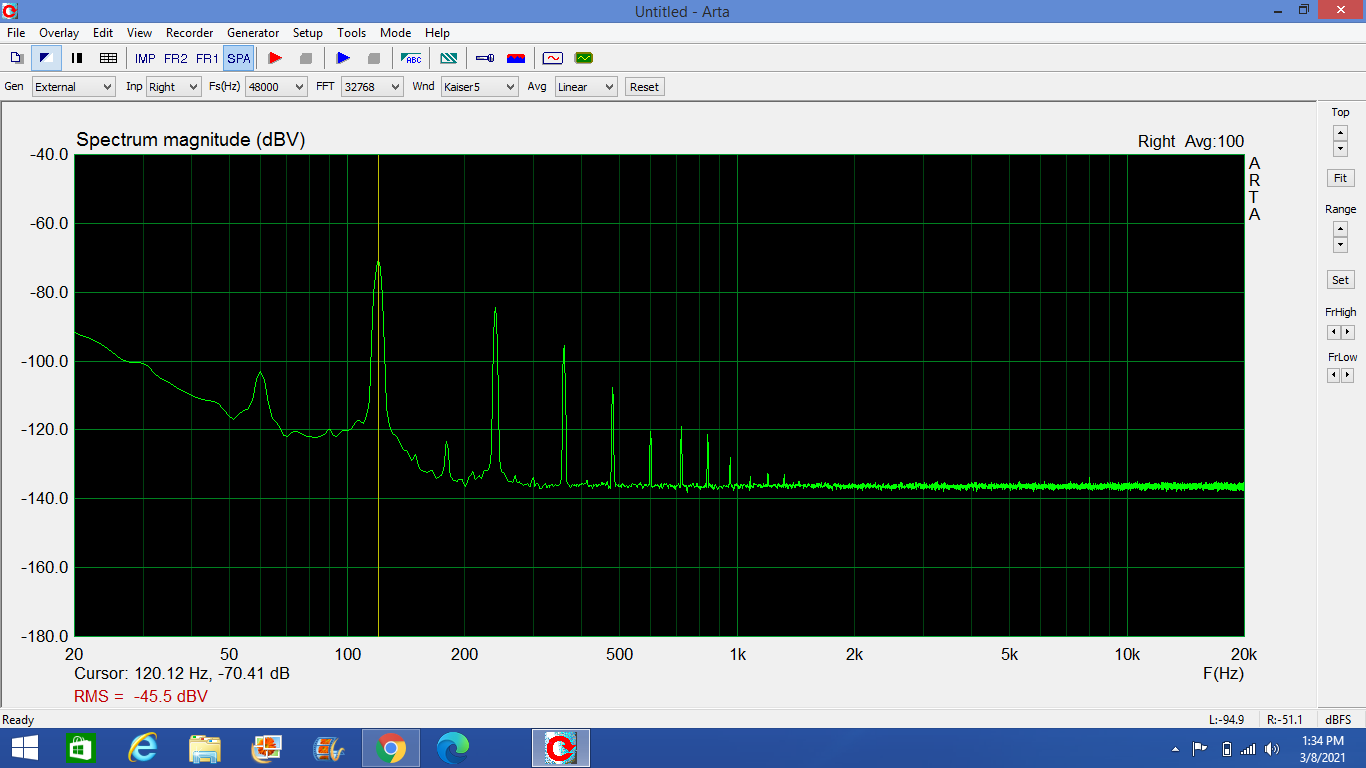

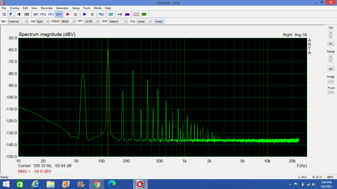

The input ripple graphs of RickRay's VRDN (Measurement data and techniques for Elvee's De-Noizator: all implementations) and Hafler preamp (D-Noizator: a magic active noise canceller to retrofit & upgrade any 317-based V.Reg.) may indicate that there is some issue with VRDN.
VRDN input ripple
Hafler preamp input ripple
VRDN input ripple
VRDN input ripple
No issue with VRDN measurement, I think there is an issue with the Hafler measurement. It is a simple LM3*7 with 1000uF filter caps before the regulators. No way it can be -60dB. I'll bet I forgot to change the multiplier for not using the LNA. So the real reading of input ripple for Hafler is more than likely 0dB, that would make way more sense in a lot of ways.
For one thing it would explain why I wasn't getting that much PSSR from the add-on board in that application.
I will re-measure the Hafler input ripple.

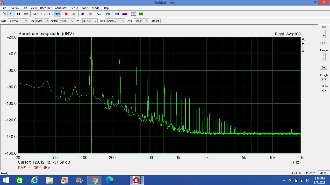

I replaced the two 0R39 resistors with 47R resistors. This moves the low-pass cut-off frequency from 185Hz to 1.5Hz. Of course there are trade-offs, the two new resistors now drop about 2 volts, so you would need a transformer with more voltage to reach +/-21 volts. It did decrease the input ripple from -40dB to -70dB which is more in line with the amount of caps on the front end of the VRDN.
Positive Rail input ripple with RC values changed
I see what you are talking about. I went back and re-measured the Hafler and let it average 100 times. I get about -110dB@20Hz and the VRDN is at about -90dB@20Hz.
No idea what is causing that, like I said the Hafler has no extra filtering in the front end. Must be a mixture of components and implementation that created the nice low-pass response.
I don't know, it is 3 times better than the Hafler, but that's a lot capacitors for 10dB.
Haffler has smaller load current.
