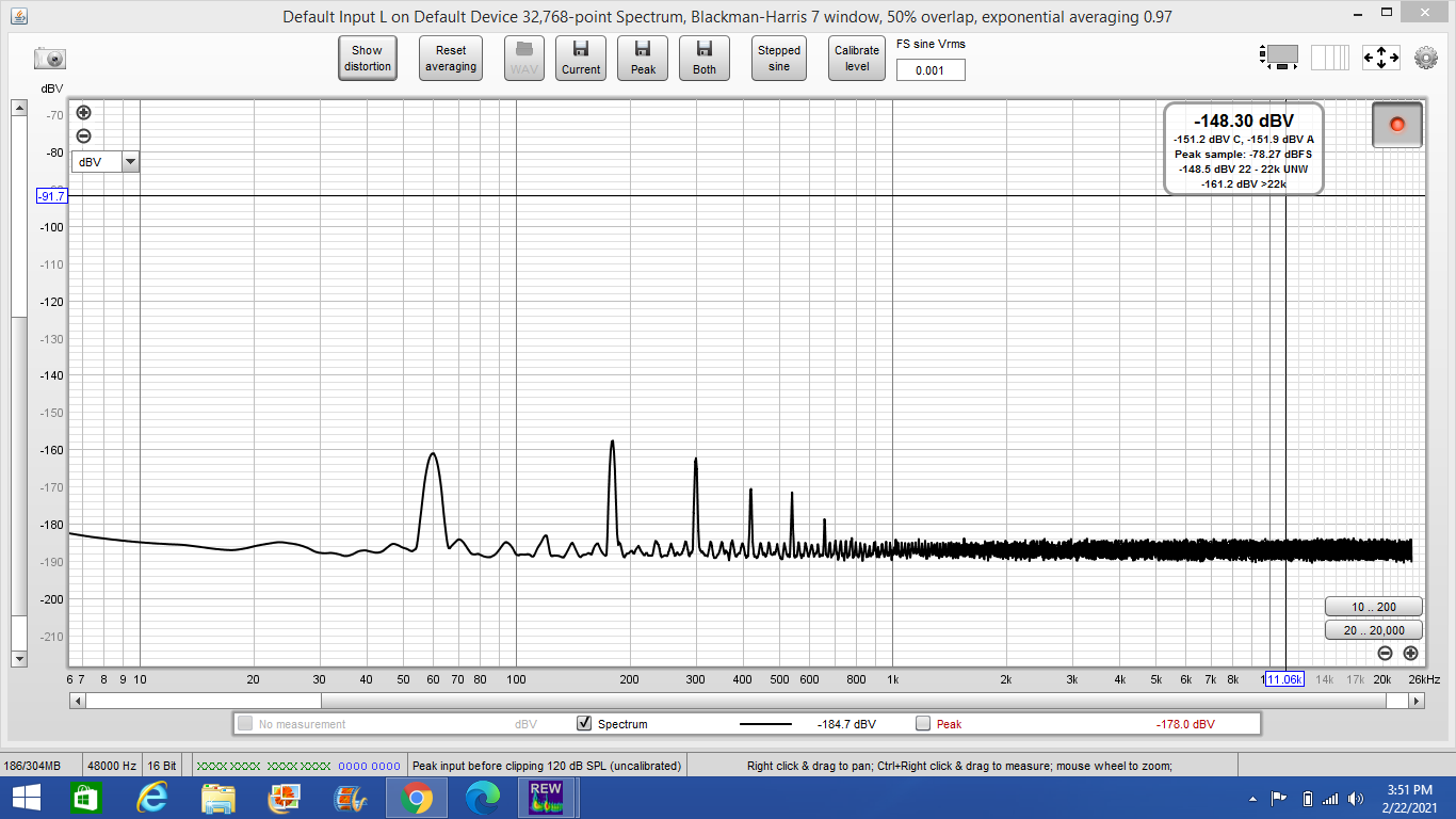

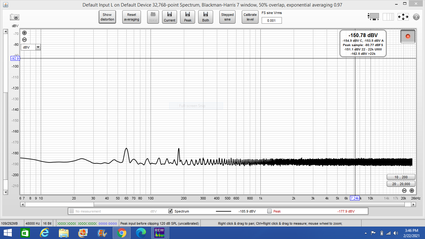

Here is another measurement of the same thing with the soldering iron turned off. The cord was right over the low input coaxial.
LNA input cable shorted
The LNA should be able to measure the denoiser on VRDN. I think they argue that the VRDN board itself picks up noise from the transformer 1 meter away or something like that. I'm not sure if that also is good or not for the VRDN.

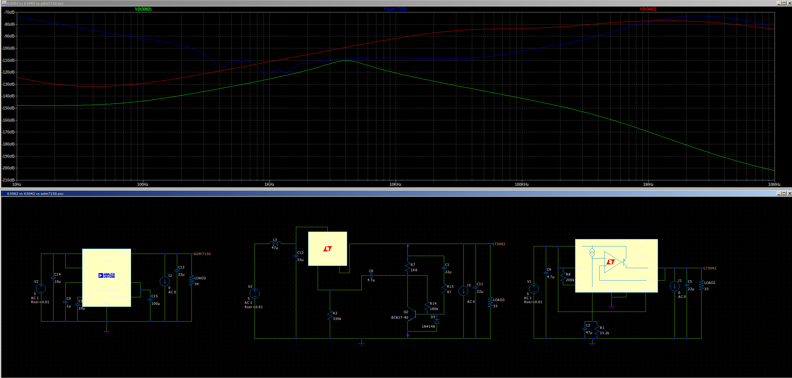

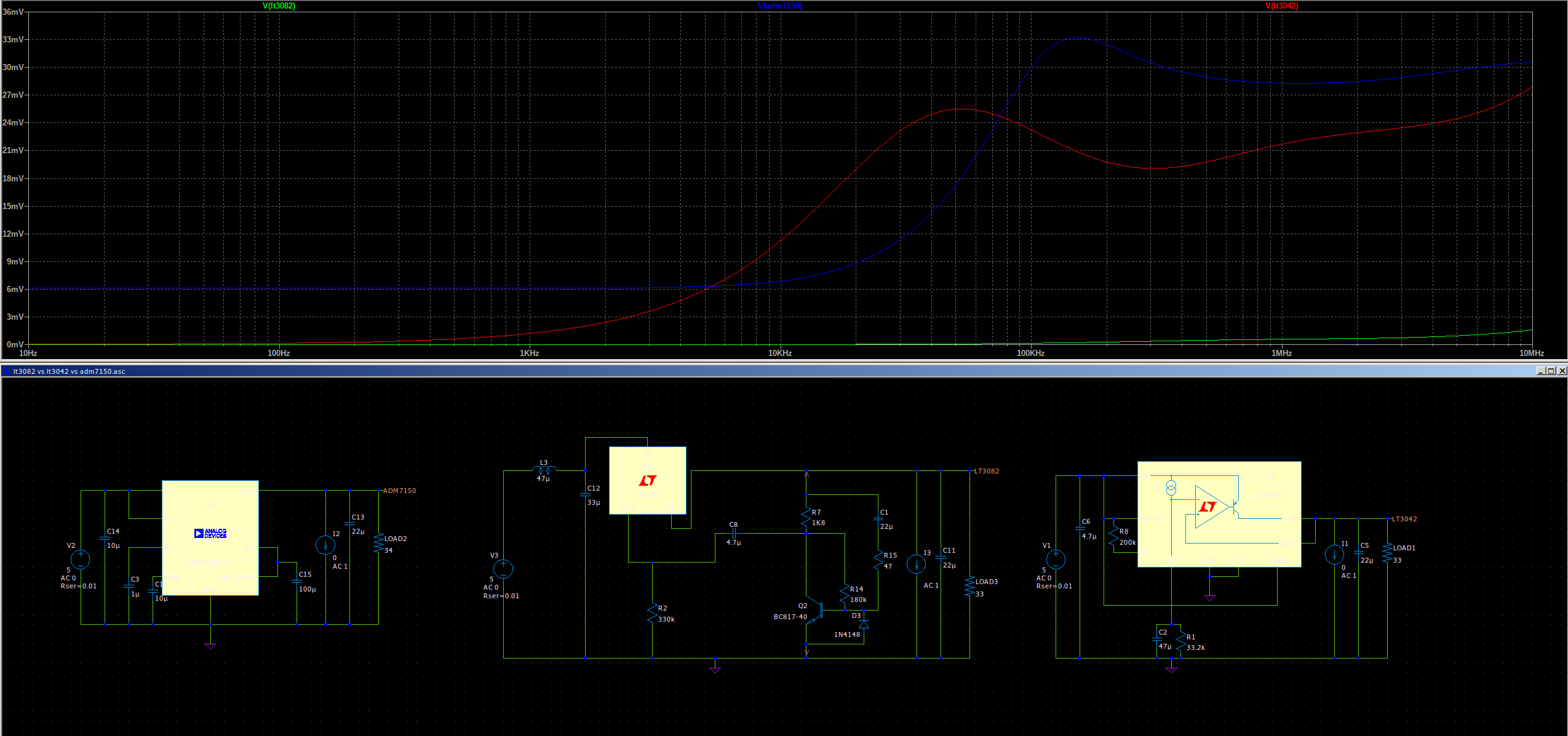

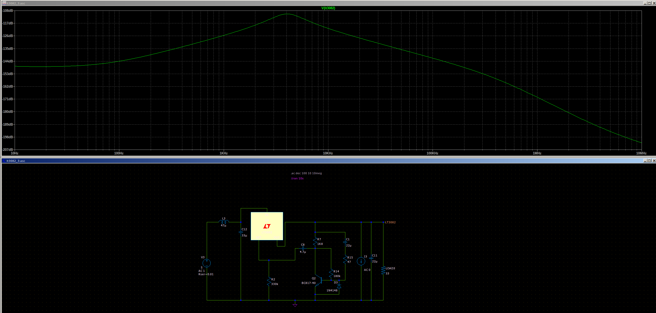

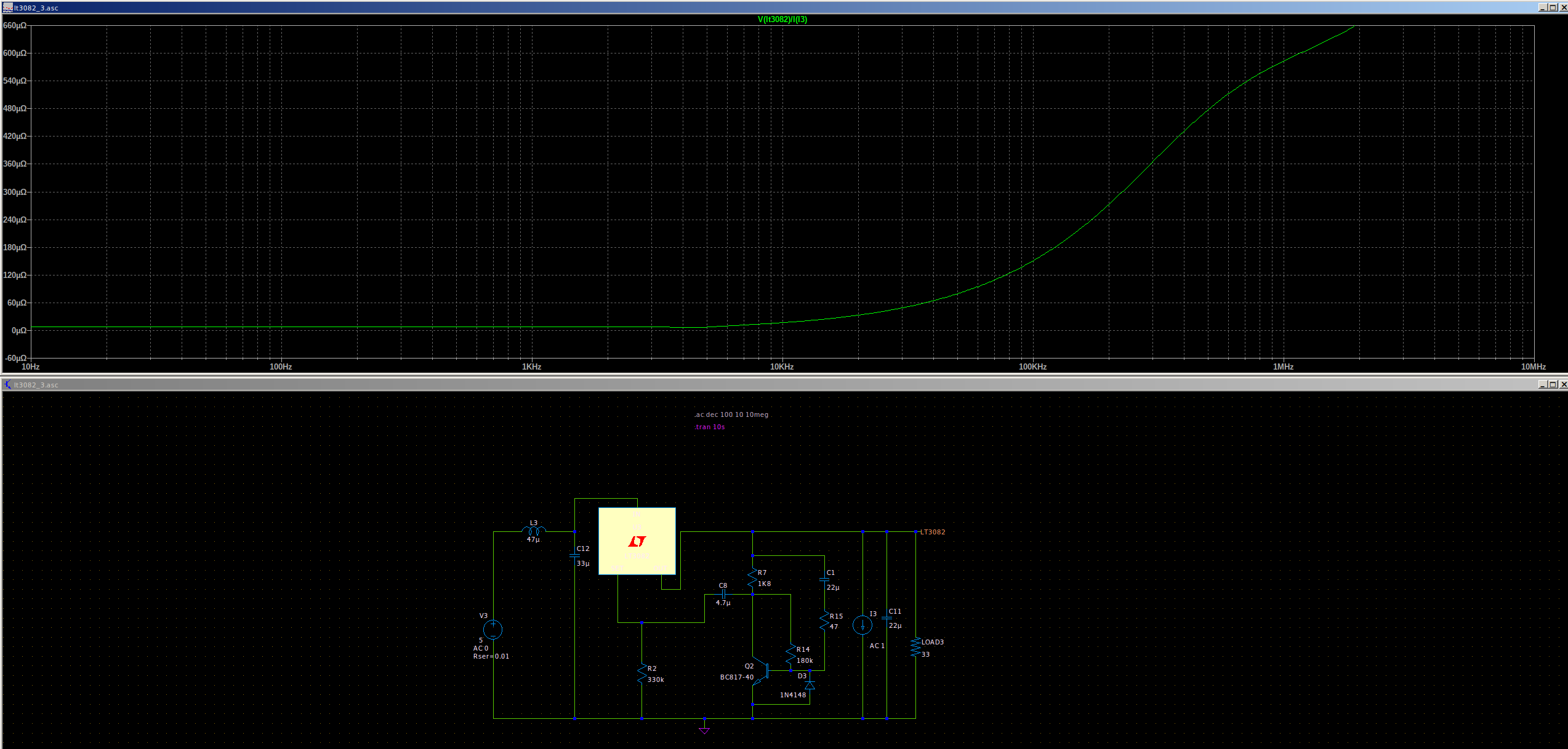

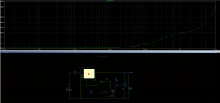

For the curious here's a simulation between LT3042, LT3082 and ADM7150, with 5Vin and 3.3Vout at 100mA, for PSRR and output impedance, just that LT3082 uses a denoiser and a small LC in front.
Not only does the LT3082 arrangement have better PSRR all around the spectrum, but it's in another league of its own for output impedance, at least from simulation.
If I've done something wrong with LT3042/ADM7150 in the sim please correct me, I don't want to present false info. I never worked with them so I only rely on the sim when I say this.
I did measure LT3082+denoiser PSRR at 100Hz these days. Measured a bit worse than sim, still better than the others. edit: I measured PSRR at 12Vout for LT3082+denoiser, might try tot measure at 3.3Vout but sim shows it still should be better.
I still have to do some measurements before I post them, for LT3082+denoiser.
I wish to retract this claim, apparently LT3082+denoiser doesn't really work. I gave further explanations in this post:
D-Noizator: a magic active noise canceller to retrofit & upgrade any 317-based V.Reg.
I am sorry for the bad info.
