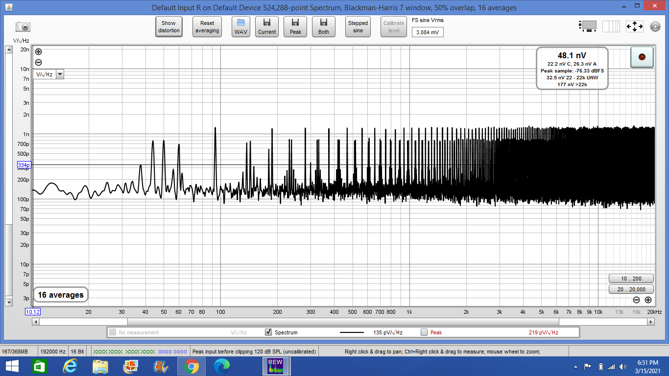

IME noise measurements in the frequencies below 400hz (maybe 10hz-200hz) are very important regarding power supplies. That is where the layout or decoupling issues will be most apparent.
Looking at my measurements, does the 10Hz to 200 Hz look flat. It does to me, but the line and fundamentals would need to be tamed, fixed with battery power.
Your measurements displays from 20hz upwards. Could you do another measurement with LNA input shorted displaying from 10hz to 20kHz, 16 averages, no smoothing, 256k or 512k FFT length.

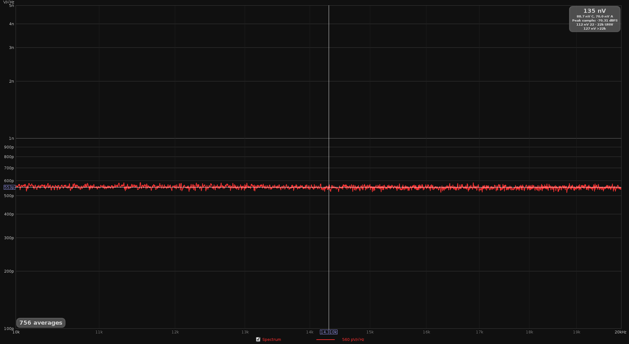

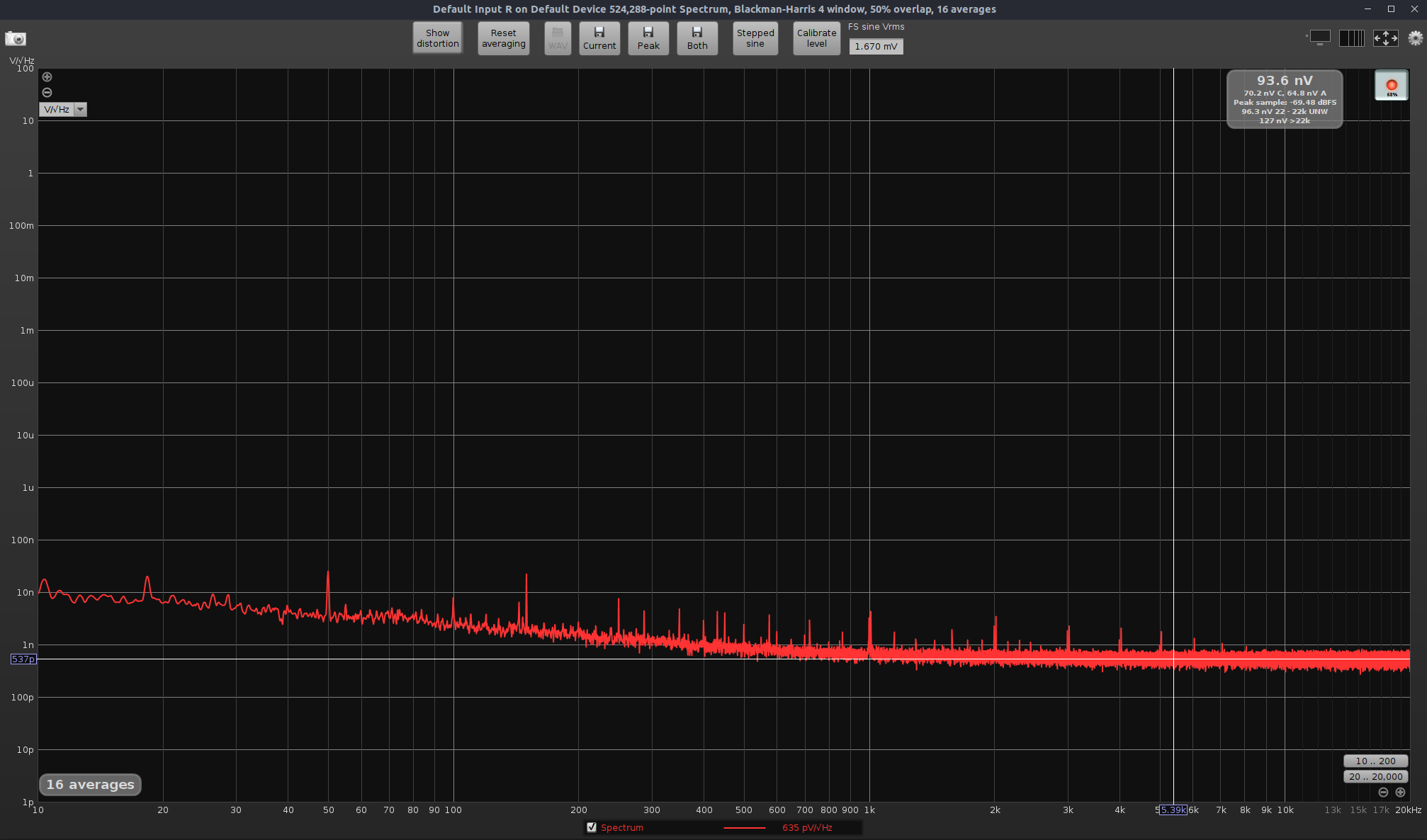

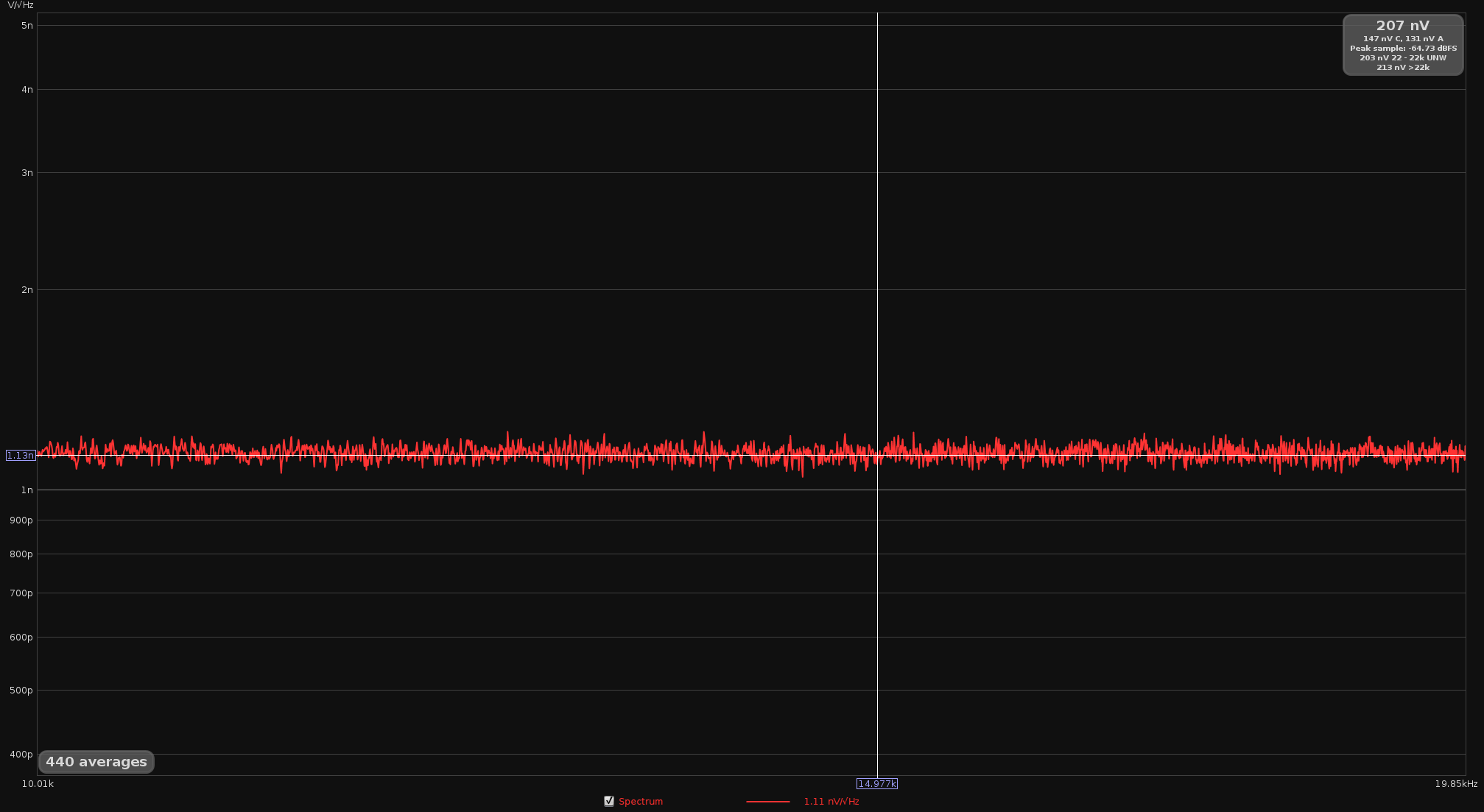

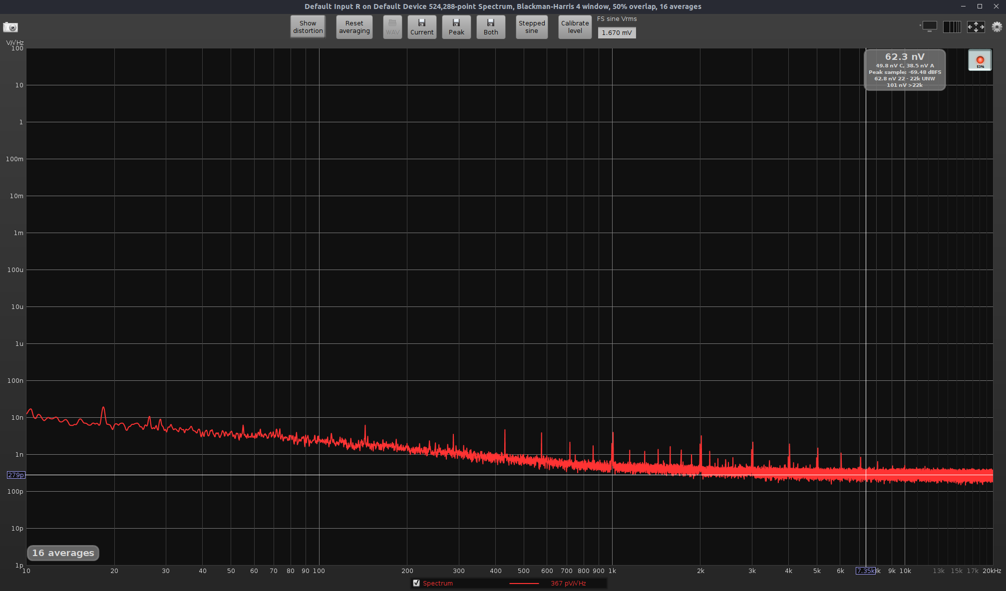

I did the 3dB calibration, and I got a 3dB increase in the noisefloor level with a 19R resistor. I used the 10kHz-20kHz spectrum as that's clean for my ADC.
19R means around 0.55nV/√Hz. So recalibrating so that my noisefloor is at that level means my REW calibration value changed from 1.47V that REW calibration found to 1.67V.
Using this value (1.67mV for x1000 gain) makes it that measuring a 19R resistor the noisefloor moves from 0.55nV/√Hz to 0.78nV/√Hz.
A 60R resistor now measures around 1.13nV/√Hz and the 204R resistor measures around 1.98nV/√Hz. I'm not sure how accurate it is now, but I also tried a 1Vrms input into the ADC and both REW and ARTA show -0.4dBV meaning 0.955V. So I guess the LNA has about 60.4dB gain. I set the ARTA calibration value to 2362mV which is Vp of 1.67Vrms.

Photos in order:
1. shorted LNA input
2. 19R measurement
3. 60R measurement
4. 204R measurement.

This does not appear to be a measurement of your LNA with input shorted as the noise level is much lower and the shape of the curve does not match your previous measurements. Either your LNA was switched off or you were measuring just the soundcard.
I did the 3dB calibration, .......
How would I subtract it from the total noise I measured for each?
This looks as perfectly OK calibration and all numbers hold. I have no afterthoughts on numbers you have published. I think you have now better than 5% accuracy and it is hard to get any better than that in our diy hobby.
Actual DUT noise can be calculated from total noise by the following equation:
Noise DUT = sqrt (Total_noise^2 - LNA_noise^2)
^ symbol represent squared value
LM317 + BC817 is measured as 1.34nV/√Hz
Noise DUT = sqrt (1.34^2 – 0.55^2)
Noise DUT = sqrt (1.8– 0.3)
Noise DUT = 1.22 nV/rtHz
For the discrete regulator with MPSAx6 and 840pV, same math result is 637 pV/rtHz actual regulator noise.

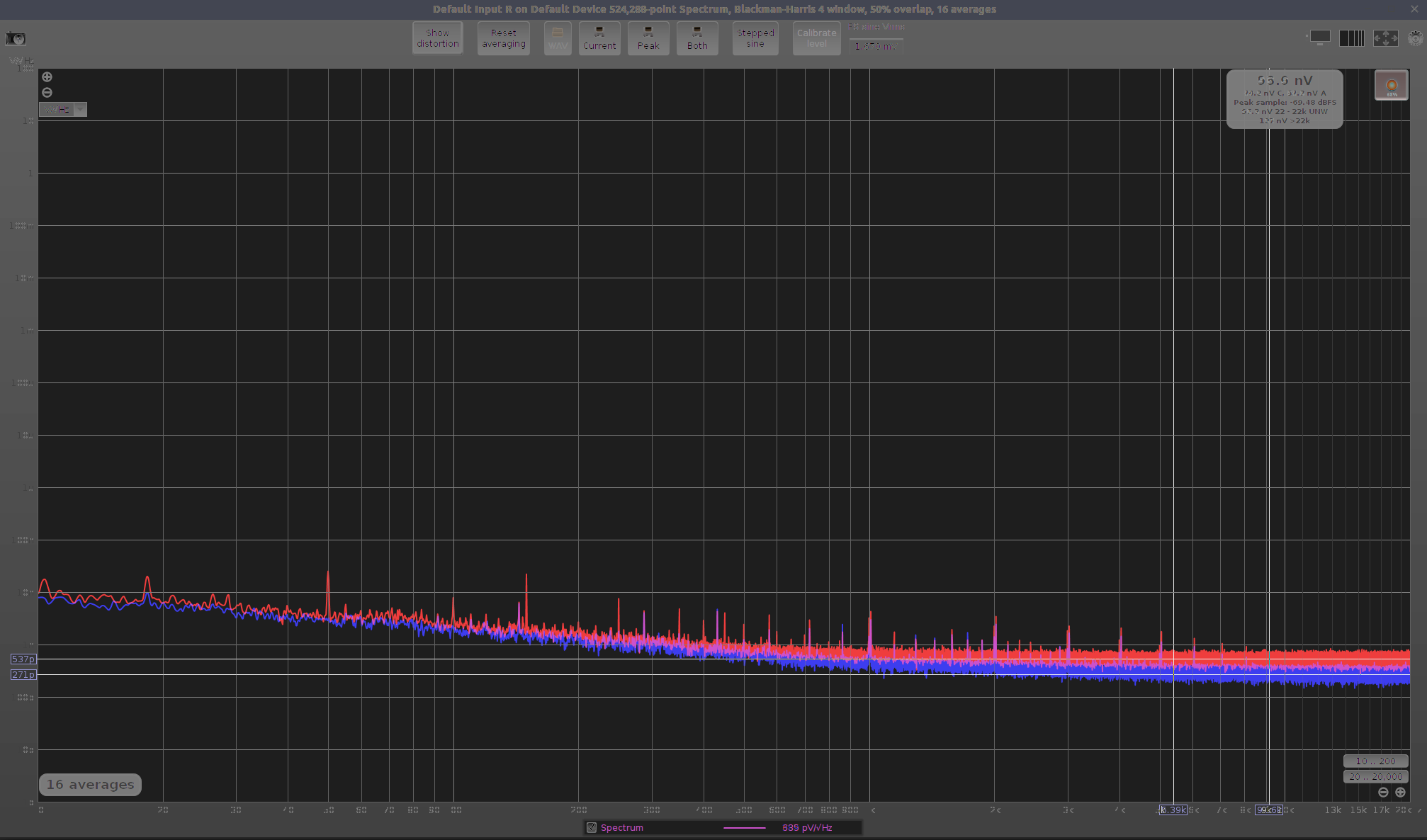

The problem with both RickRay's and your measurements is the total noise which is higher than what your estimated noisefloor predicts. In your case the total noise is less than half of what RickRay had but still based on the total noise your LNA is comparable to a 40 ohm resistor which corresponds to 0.8nV/rtHz. Due to the high LNA noise a very lengthy averaging is required to eek out a "noisefloor" but at least in RickRay's case the "noisefloor" looked suspicious. You haven't shown LNA noise from 10Hz to 20kHz so difficult to tell if your noisefloor looks more sensible.
Unless the LNA (or ADC) noise is toned down the noisefloor estimations are quite irrelevant. RickRay's LNA has a noise limit at 270nV. Your LNA seems to have a limit at 112nV. Basically you cannot reliably measure noise that is well below those limits. You can of course make relative comparisons between DUTs at some limited bandwidth but based on that you cannot tell which DUT has the lowest noise within audio bandwidth.
It was like that before with his measurements, but last calibration and 19 Ω & 204 Ω checkpoint measurements are corresponding to the 550 nV/rtHz LNA’s noise floor with small tolerance.
Though, RickRay’s measurement are still in "The twilight zone”.
As for the ADCs, it is enough that they have noise floor several times lower than LNA’s output noise. With 60 dB gain, 0.5 nV/rtHz input noise density is shifted to the 500 nV/rtHz at the LNA output. At half of available gain (usual position needed) Focurite (which RickRay and me both use) has noise floor of 70 nv/rtHz at line-in. That affects total noise by less than 1%.

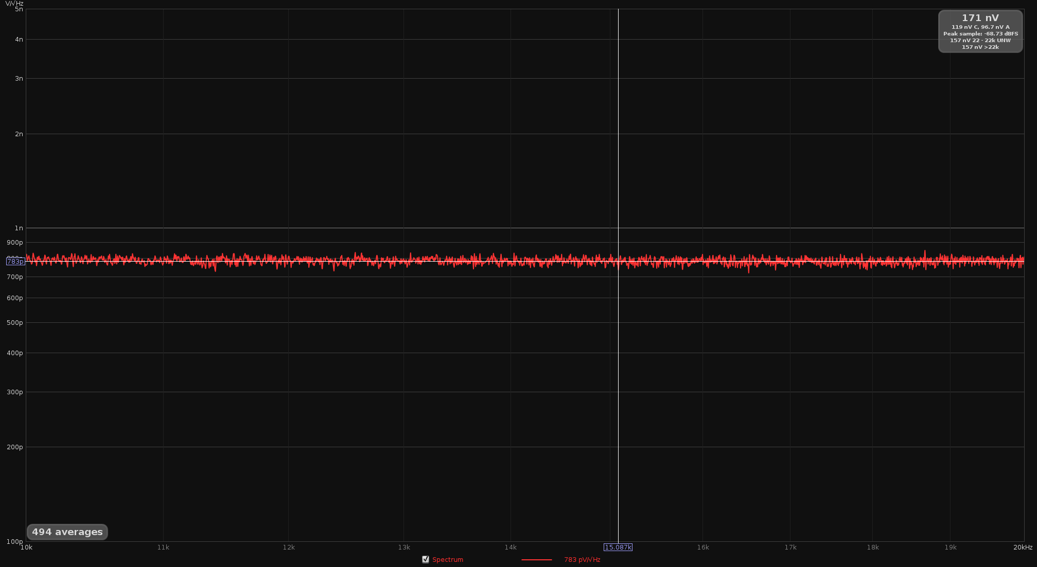

I attached the same measurement that you asked RickRay to do for the first picture, the second one is with the same conditions but ADC input shorted. I didn't change the multiplier for the shorted ADC input.
Clearly my ADC is not clean on the lower frequencies, hence I can only trust whatever is from 10kHz-20kHz.

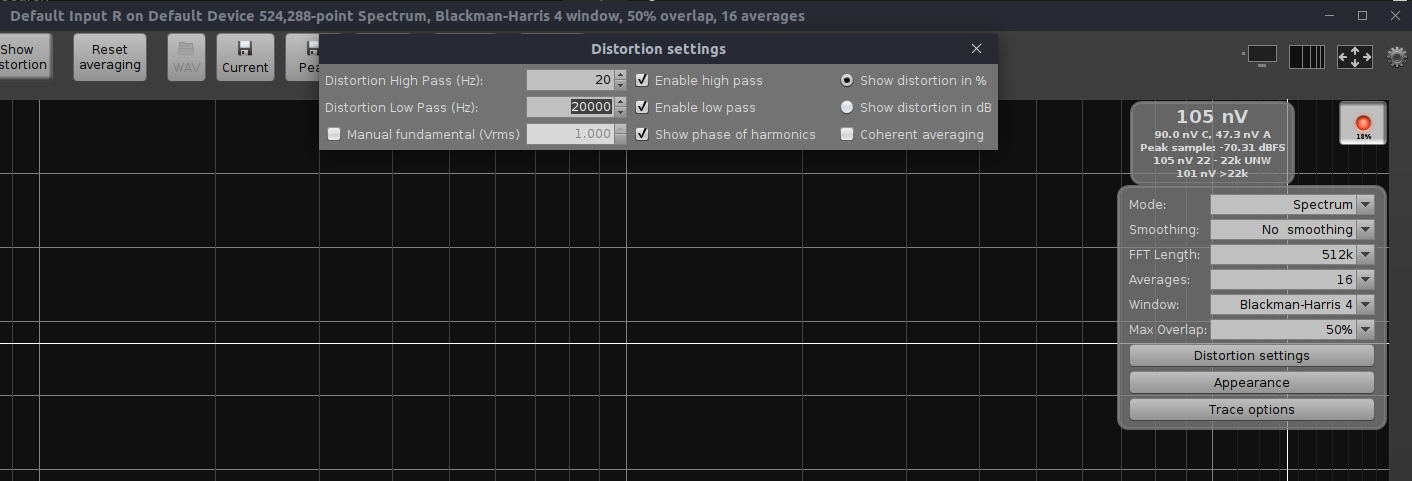

I think REW is always calculating the total noise of the 20Hz-20kHz spectrum. I don't think zooming into it changes that. Even if looking at 10kHz-20kHz it still shows the value for the total noise. Or am I wrong?
That might explain the numbers that REW is showing in the upper right.
If so, any way of making it consider just what is shown on the screen, while zooming on a certain range?
I made an overlay between the shorted ADC (blue trace) and shorted LNA graphs. At these low levels a crap ADC doesn't do it.
Yes I think the upper right value depends on the limits set in the settings. I see that the upper limit for the low end is 999Hz. Changing from 20Hz to 999Hz reduces the upper right shown value.
So ideally I'd change it to 10kHz so I can measure just for 10kHz-20kHz but that doesn't seem possible. The upper limit for the high pass filter is 999Hz.
These measurements look better and the total noise in the first one is now closer to the apparent noise floor at 5.39kHz. The second measurement reveals quite clearly that your ADC is not up to the task below 1kHz.
