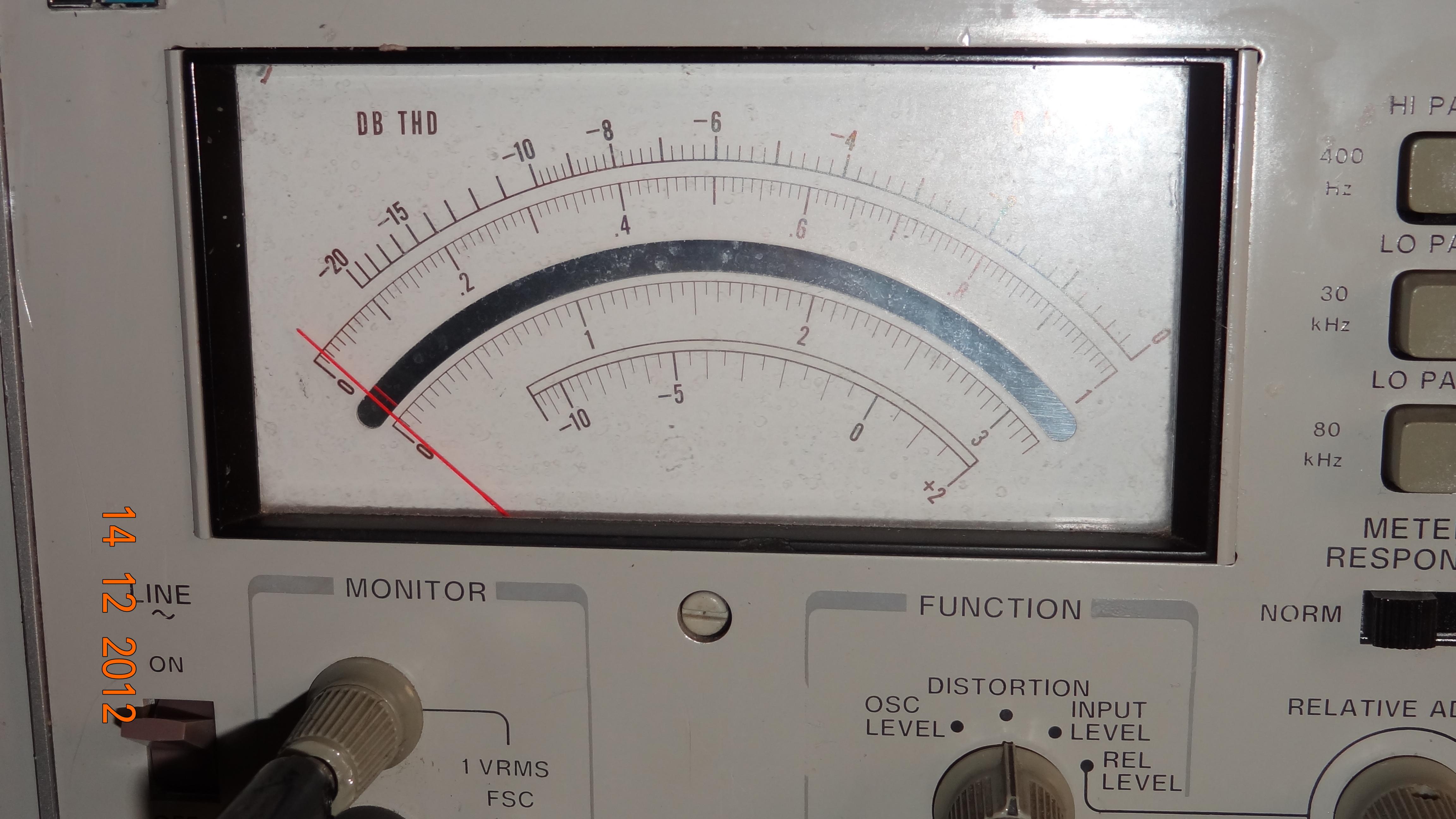

When I used the thd+noise instrument from Demian, it was reading on my little amp... .0005% . Too close to the test equip residual? The FFT output was uncalibrated so that didnt help. can it be easily/accurately calibrated? Looking for a test system to easily and accurately measure harmonics in the .00001 - .0001% area. Thx-RNMarsh
The closed loop THD only with that box (Shibasoku 725) plus the generator is around .00005 (-130 dB) or less. I have verified that its accurate. You use the individual harmonic measurement to calibrate the FFT output to known levels.

I have played - decades ago - with such long time constant oscillators.... but 30 seconds is way too long if I want to make null and balancing adjustments. The Shibasku 725 is 5-10 times better than i need so that should be accurate enough for now. Need to find another.. cant get to you often enough for any long term developemt work... just a spot measurement now and then. I'll be looking for one. Thx-RNMarsh

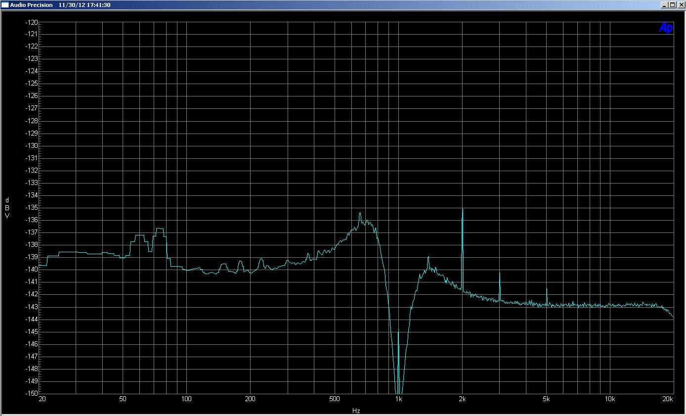

The AP 2700 is spec'ed at -112 to -115dB. I want better, unfortunately. Thx-RNMarsh
AP internal oscillator
Well, the EMU 0204 and the QuantAsylum 400 ADCs, used with spectrum analysis software, can both do -140dBV or better noise floors, RE 1VRMS input, out to about 30kHz, but then both show a rising slope due to the noise shaping ADCs out to the 90kHz limit, when 192kHz sampling is used.
As I've mentioned, I use an Active Twin-T filter to notch the fundamental out of the way of the ADCs. I've also used it as a front end for my Tek 7L5 with good results. The self-distortion of the Active Twin-T is unknown to me at this point, but I have reason to believe all of its products are below -135dBV RE 1VRMS input. The Twin-T has metal film resistors, wirewound pots, and polyester caps at this point.

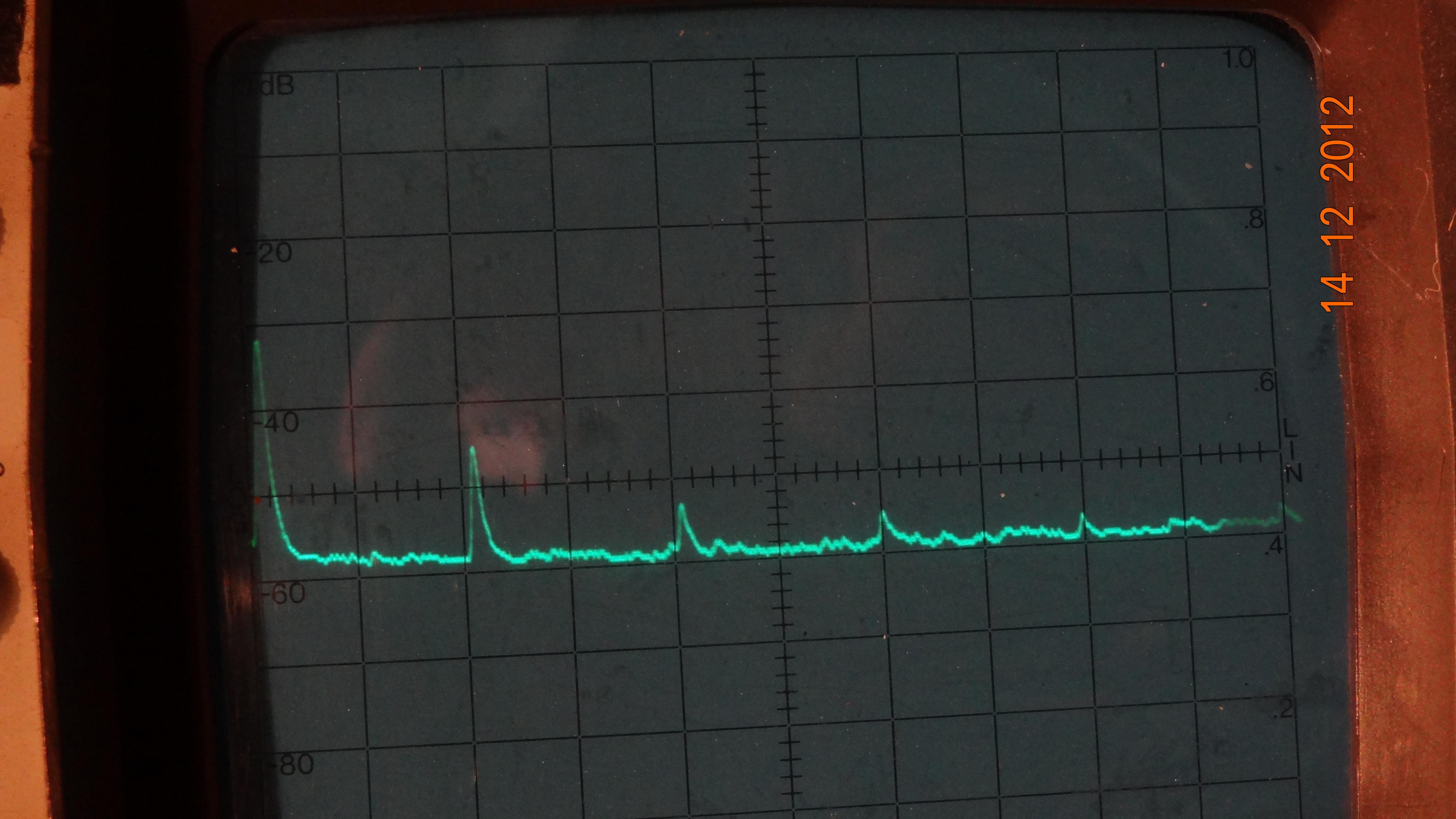

I'd like to see what existing/future designs can do, so being about 20dB better would give some semblence of accuracy; So around -130/-140 thd+n over 20Khz bw. Or better. Thx-RNMarsh
Have a look at my post #772 in this thread. Using the Jim Williams super oscillator through Dick's active twin T with the HP3562A. I can see out to 100kHz with a noise floor around -135db. Also note that the oscilator output in these examples is at about 1.4vrms.
Ken
Please ignore the THD values in the aforementioned post. It's calculated by an HP8903a. I usually hand calc the THD.
