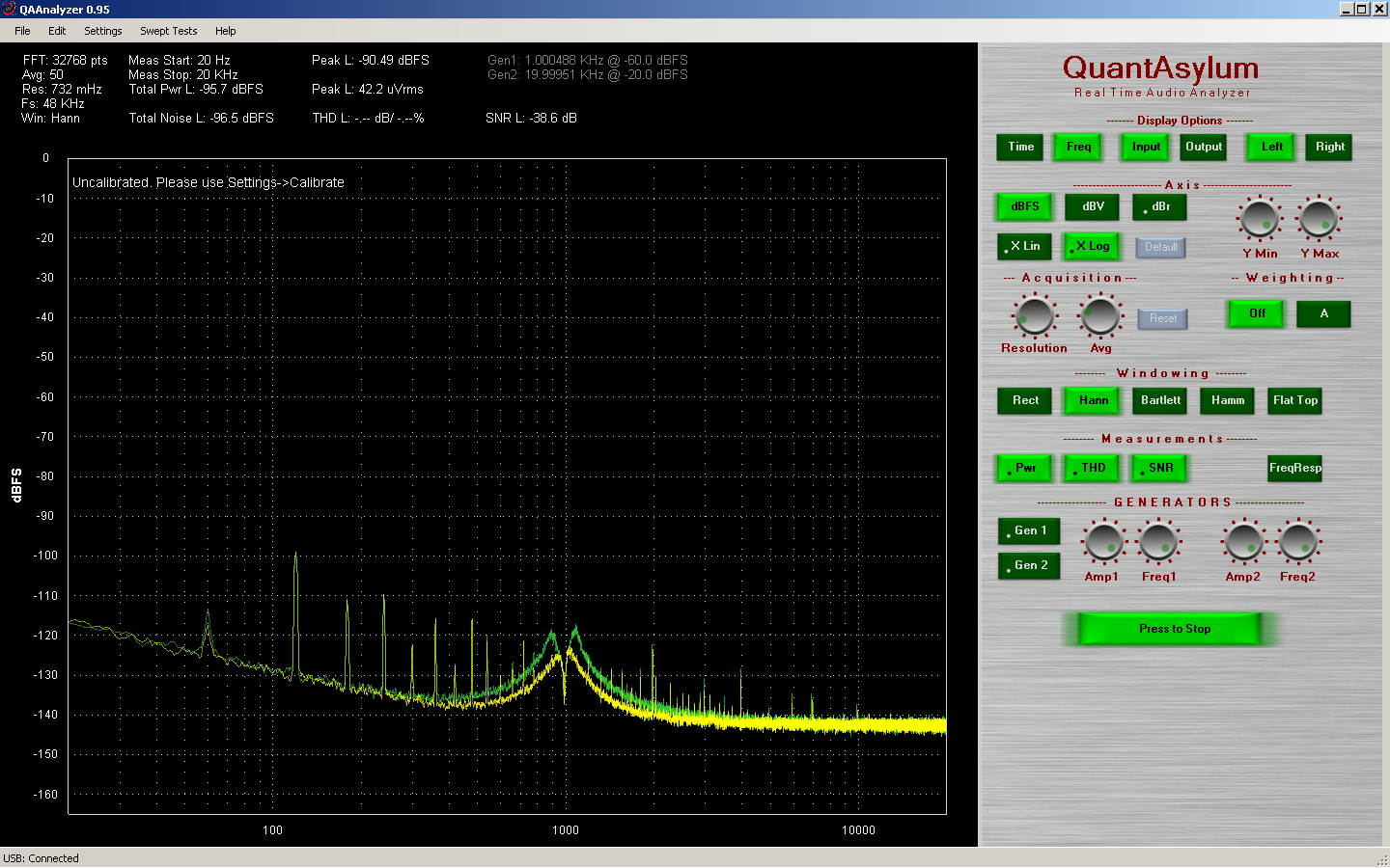

Difference of 339a range
Rick have a look at this.
The green is 1KHz in the 1K range and the yellow is 1KHz in the x100 range.
The noise floor and notch shoulders are lower in the x100 range.
The padding resistors and filter resistors are lower in value and the caps are larger in the x100 range.

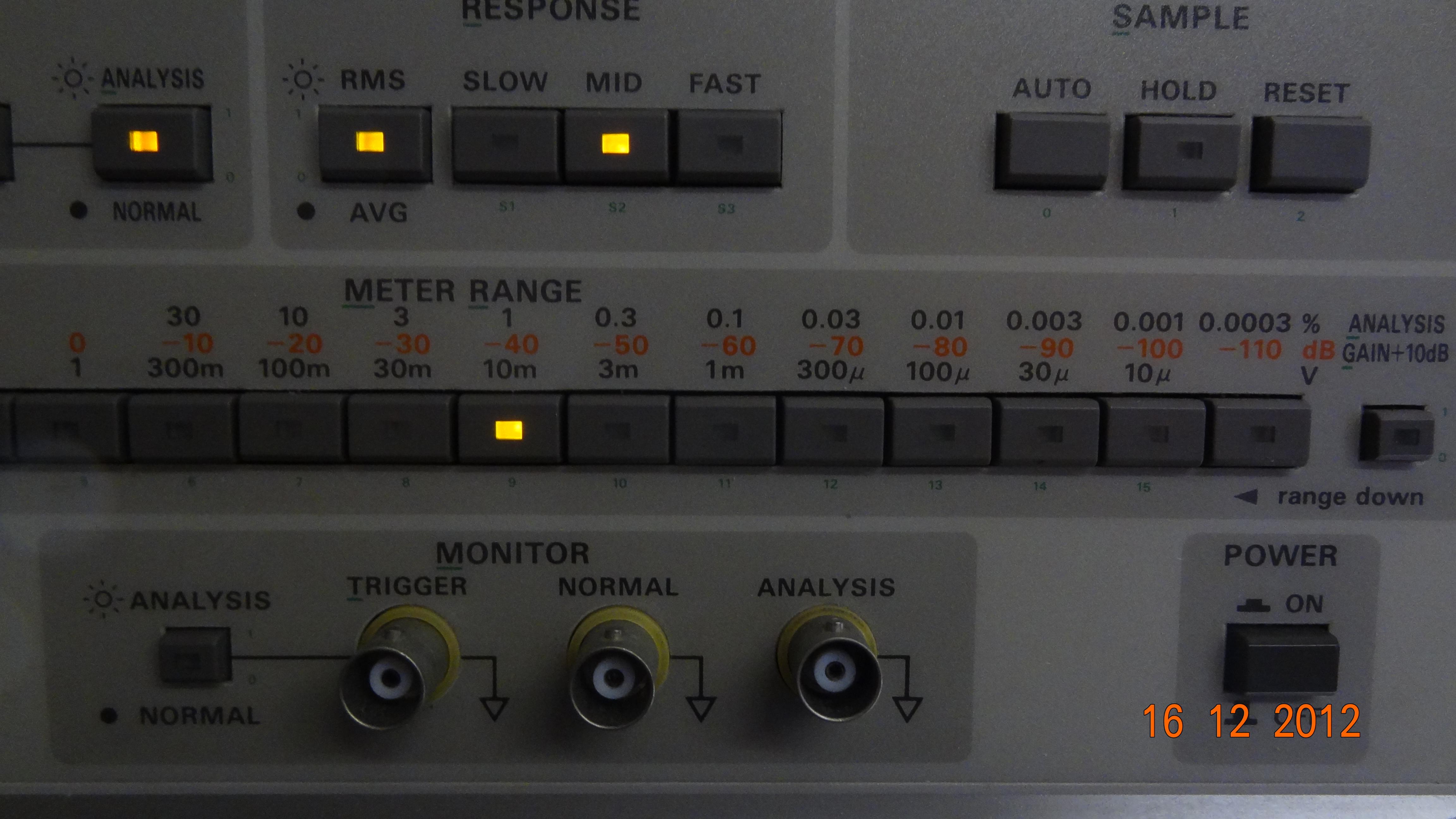

Take the week off! Drinks are on me ! The ShibaSoku AD725D has arrived. .0003 full scale. I'll check the 339A source today. [Now if I just had a schematic] -RNMarsh
Congrats on that. They are quite rare. We need to see how different yours is from my much older one.

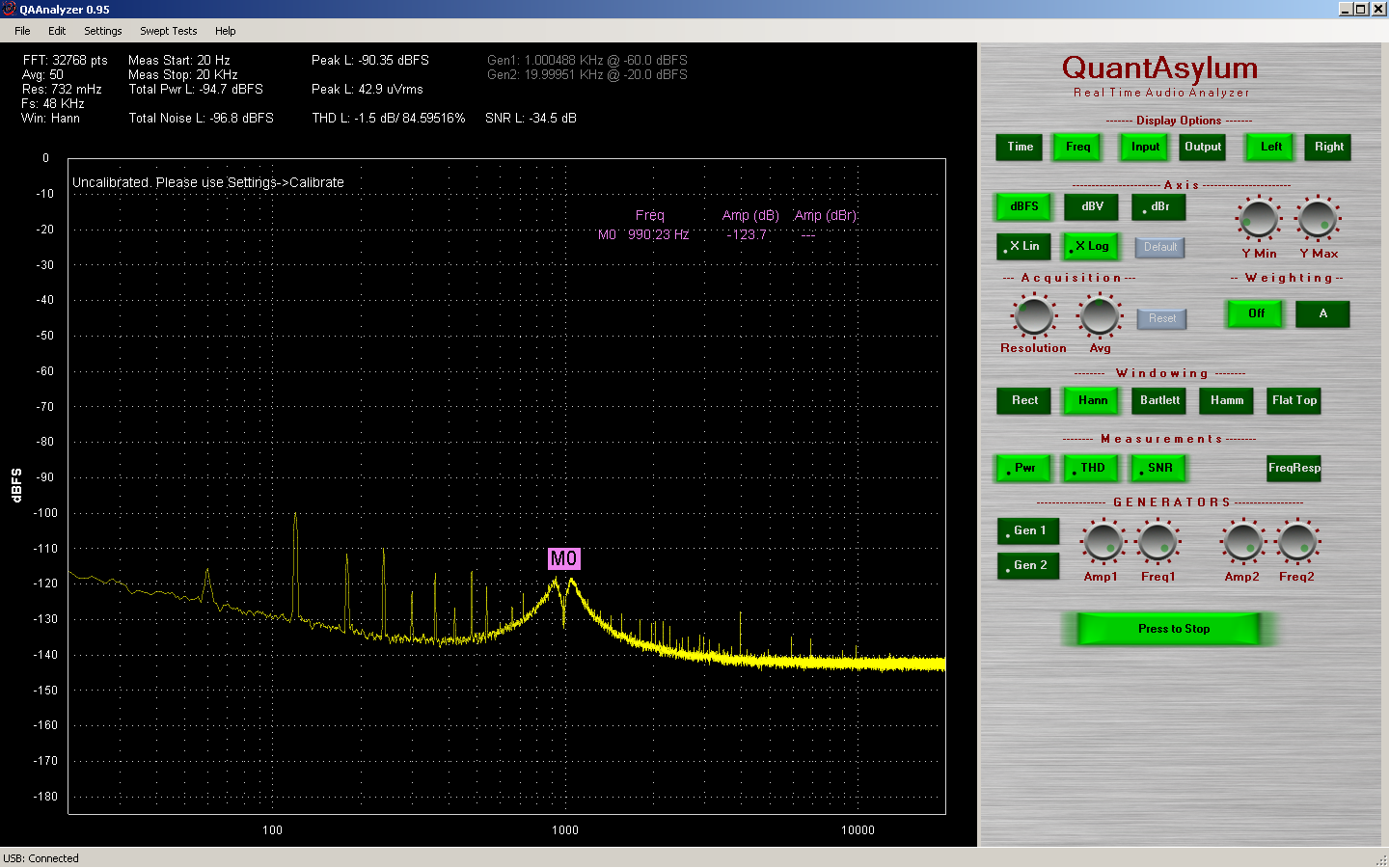

Hi Rick,
Here is something to compare it too.
This is the 339A oscillator, with mods and a tight calibration, at it best.
1KHz, 1Vrms. The notch filter in the 339a is seeing 1Vrms from the buffer amp.
Very good. David, where 1/f noise is originated: oscillator, input att/amplifier, notch amp/capacitance neutralizer, etc?
Hi Dimitri,
I'm not sure I can put my finger on it. It looks like it's a bit of all of the above mentioned.
Some of the answers can come from calculation and the rest has to be measured.
Resistor noise we can calculate or just say we have a 100K input impedance and so that is a source. But this is in parallel resistance with the source resistance which is 600 ohms. This impedance changes with input attenuation as seem by the input of the amplifier. At 0dB attenuation we have the source but as we change input attenuation we have something different at the amplifier input. This effect can be seen by reducing the oscillator output level and changing the input sensitivity. The 339a meter rises for the same voltage seen by the amplifier's input. We also have a gain change on this amplifier as the input sensitivity is changed.
I would say the most noise is generated by the notch filter control elements. The LDR's. Another source is the auto set level. The auto set level maintains a constant output level within a 10dB range of the input range selector. it also has an LDR. At unity it's resistance is very high and is reduced as needed to a max of 10dB increase.
Then there is just the normal contribution of the amplifier noise at what ever gain.
What matters most is the noise at the output of the notch filter. After that it is amplified 80dB, 10000 times. That's a lot. This gain is distributed over the distortion amplifier 30dB, the auto set level 10dB and the meter amplifier just before the RMS detector 40dB.
We can see from the plot in the last post the SW is reporting a total noise power of -94.6dB at the output of the notch filter. -95dB + 80dB is -15dB (0.178mVrms) of noise in a 20KHz of bandwidth. Out of 1Vrms this is 17.78% of noise out of the FS and with all filter, in that's a 29.6KHz bandwidth seen by the meter. 17.78% of 0.01% FS is 0.001778 residual which is exactly what HP states for the 339a.
My answer then is the majority of the noise is from the input stage, the notch filter and or the oscillator /attenuator. I don't think it's the oscillator but it might be. I'm at my measurement noise floor.
