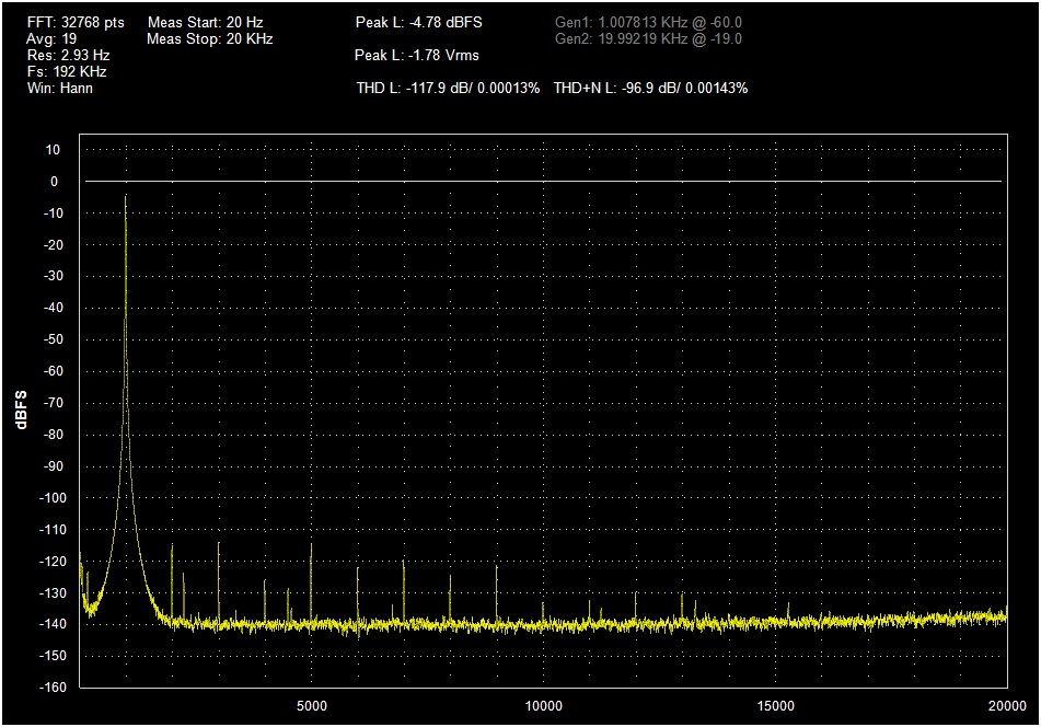

Here is an example of THD vs. THD+N. This is a measurement of my KH4400A. The THD is -117 dB/ .00013% but THD+N is -97/.0014%, a 20 dB difference and the noise floor is in fact quite low. Its just the effect of the energy inside the frequency band.

Hi Demian -- something isn't correct here -- I RMSed the first 9 products using my little Excel worksheet and got 0.00035%, -109dB. I assumed that the fundamental was at 0dBFS. If it is lower, and it seems to be lower than -4dBFS, then the THD is even higher than I calculated.
Edit -- with fundamental at approx -5dBFS, the THD is -104, 0.00064%
You are right, the calculation is off somewhere. I got different numbers the second time I tried it. Beta software. . .

My point was that the broadband noise can make even really low numbers not so low. And the THD+N meters (any of these older units) only measure the combination.
I't works out to .000607% THD.
