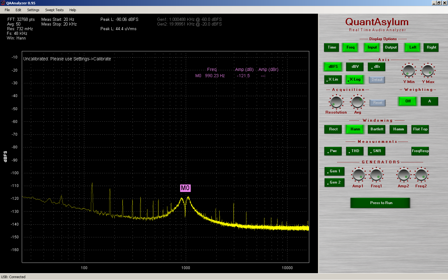

The 339A is beginning to see the effects of the THD of the opamps used in itself and also the parts and even contacts of the switches. All issues which an audio amp builder would also come to address at these levels of harmonics. The performance will be limited by the parts we use. I am installing sockets everywhere to try different opamps in different places.... will be much easier until the parts are settled as to which are best ones and stable. Thx-RNMarsh
I have the 1468 working fine in the input stage and an LME49710 in the buffer stage. This brought the noise way down on the FFT from the output of the notch filter. We have a max gain of 30dB in the input stage and need a GBP of at least 25MHz. At 30dB gain the LT1468 is 25MHz.
I may have to deal with some RF noise from the oscillator. When the range switch is set to off, which puts a 600 ohm load on the analyzer input, the meter goes to near zero with a -80dBV range. It is garbage getting in. We can filter the output of the the oscillator no problem.
Input and buffer amp
Here is the result for replacing the input amplifier with a LT1468 and the buffer with an LME49710. All the hash seen in prior plot is near gone and what remains is power supply harmonics and oscillator distortion.
All the caps found parallel the resistors in the input amplifier gain range stage have to be removed. The LT1468 doesn't like this. I'll work on filtering the input but for this I have to

Now, what does the meter on the 339A indicate? Is it off the zero position? Dropped in several op-amps today (LT1468's). I think I may need another FFT to verify this thing is even turned on and working !! Thx-RNMarsh
