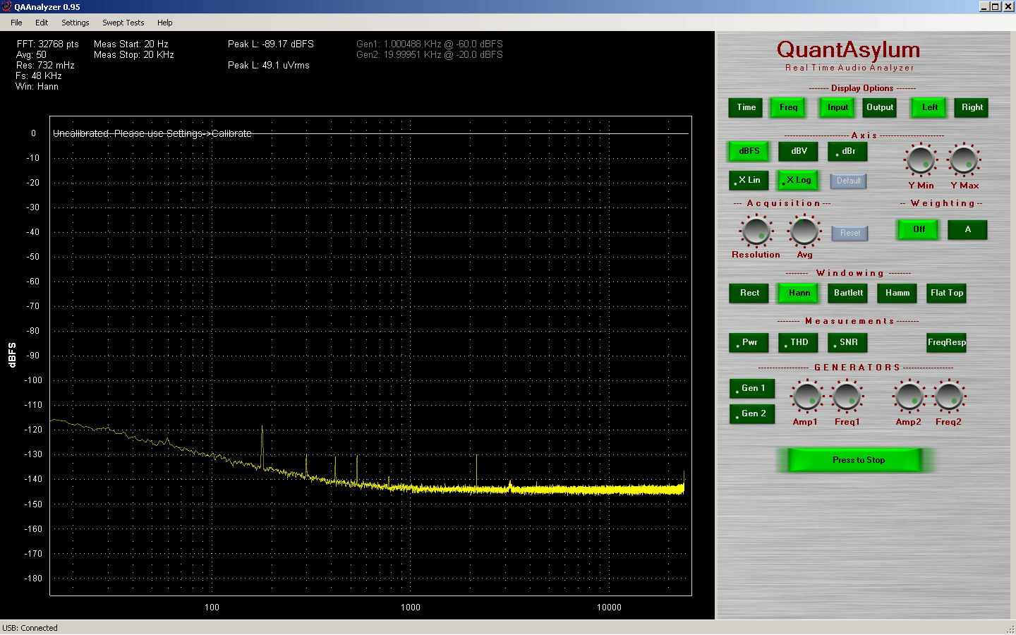

An Ooops Update:
After I repaired the intermittant contacts of the 400Hz filter switch (in series with the sine wave), the THD went back up! 😱 Apparently, the increased series R (switch contact) dropped the signal level during thd reading and it looked better than it is. But, it ain't bad, either.
Now the HD components without the most important IC's being replaced yet, are: .0007% H2 (-105dB) and .0001% H3 (-115dB). THD+N as read on the front panel meter: .0008% or just under the .001% mark. And, it's going to get better! Can't wait. That's, again, with all filters IN. Thx-RNMarsh

The changes may not show on the meter at this stage. The input noise and bandwidth could be the limiter. Even with lower noise input devices the input attenuator becomes the limit for noise. Using the FFT help see into the noise a lot.

The meter as it is isnt useful in resolving thd for DUT under -100dB.... the bottom 10% of the scale.... but even so, the FFT will get used.... just needed a good low thd flexible signal source. And, then there are the other sources.. like Victors or the one SW just build if DUT is really, really, really low. In either case, I am very curious about the prototype system davada is using.
