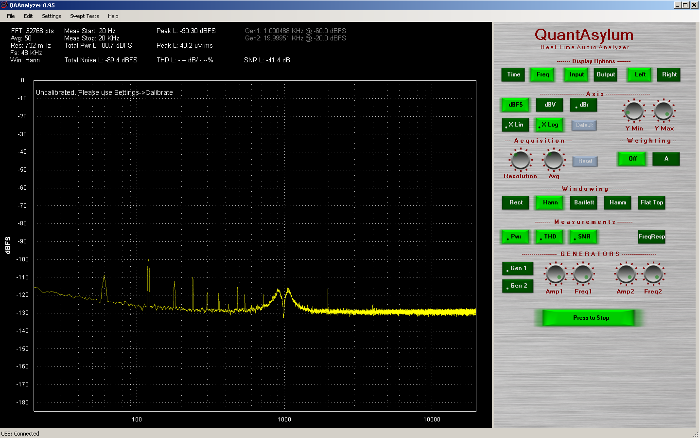

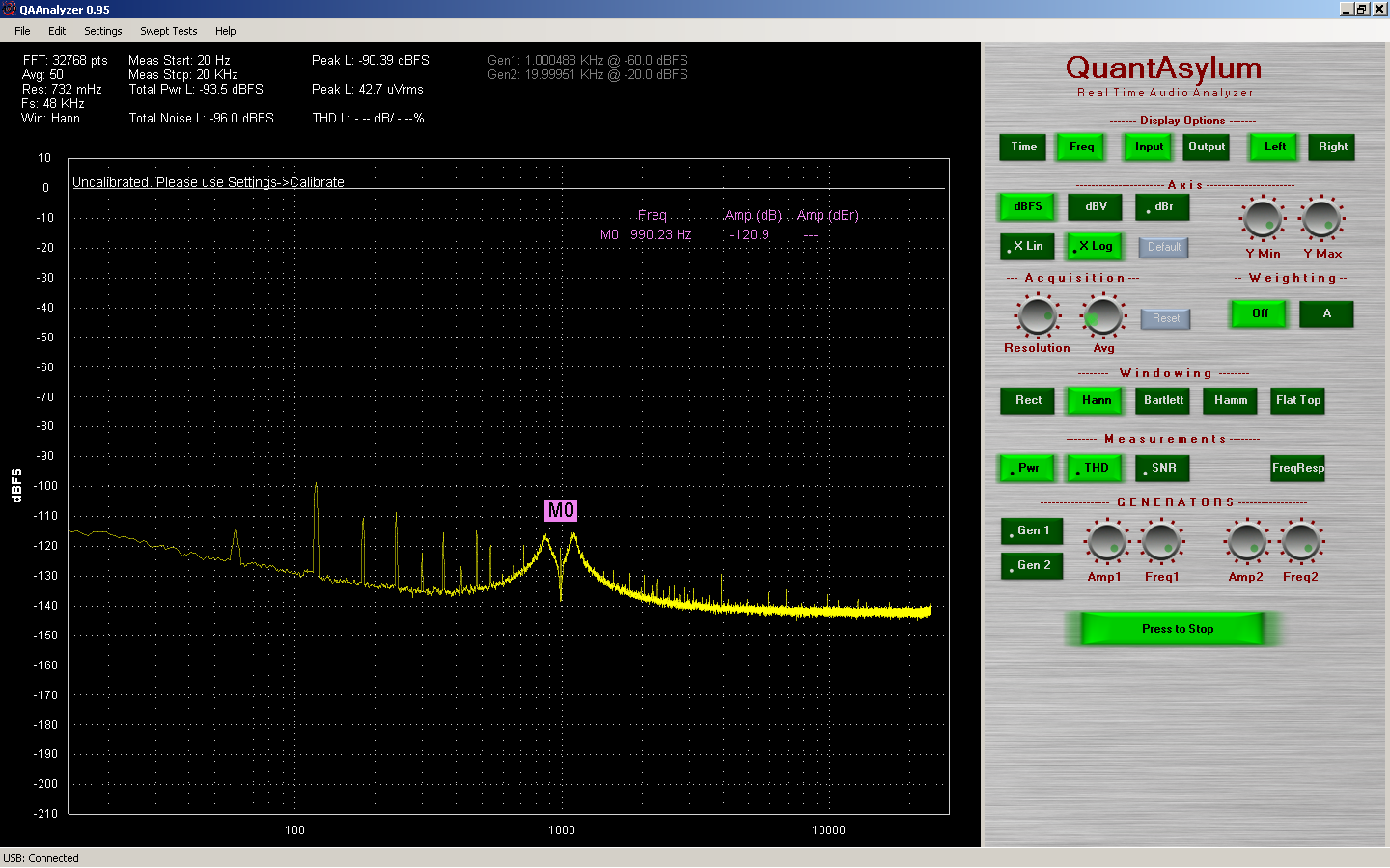

A look at Victor's oscillator on the 339a
This is Victor's oscillator attenuated to 1Vrms.
Every now and then it breaks into parasitic oscillation.
I have two of these and the parasitic in the other is too much to use the oscillator.
The noise floor is high by comparison and the only harmonic speaks for itself.
This reads 0.00325% on the 339a meter.

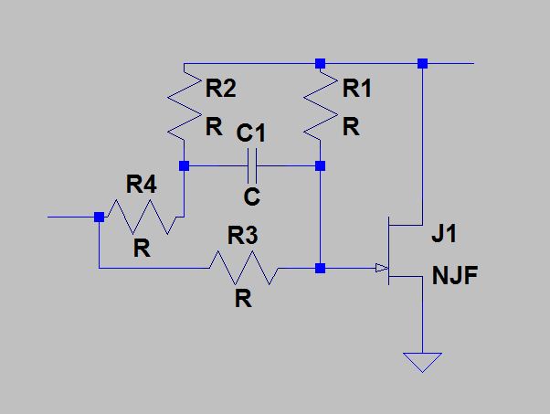

Try separating the AC feedback from the DC. I think one of the schematics I saw had coupling caps on some aspect of the FET. The AGC will change a lot as a function of the component mismatches in the notch networks. The AC linearization of the FET should be independent of the gain of the fet to some degree.

Demian how would you go about separating the AC feedback from the DC feedback?
There is a particular setting for the feedback where all ranges are stable but this is not optimal for best distortion in each range. The answer is to have separate setting for each range. I can't fix this with simple equalization on the AC side of things so switching in four different trim pots for each range seems reasonable. The oscillator works fine for the residual of the 339a analyzer. But we are greedy and we want more.
David:

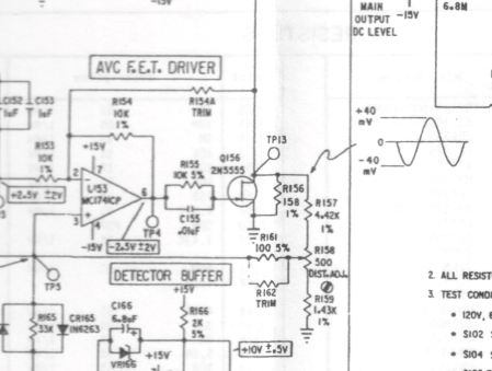

First here is some good background on how the linearization works: http://www.vishay.com/docs/70598/70598.pdf Looking at HP's schematic the linearization is ac coupled (60 pF cap) which means it changes with frequency. Possibly both a trim for DC and a cap coupled (at the wiper) trim for ac in parallel. The sketch shows what I am thinking- R4+R2+C1 are the ac (hf) distortion trim and R3 + R1 are the DC (LF) trim.
Attached is the circuit from the KH4400. It really works but you need something like the 725 to really use it. The trimmer really nulls the 2nd harmonic right out. It takes feedback from the voltage across the fet in positive phase along with a small negative phase (trim resistor) which seem to find the right balance. There are some caps for HF compensation.

Hi Demian.... there is an R and C in series across the FET (gate to Drain) as well as in series with the gate. The C value is large --60 Mfd.
I had put a trimmer in place of each R and adjusted. It helped but not a lot and couldnt null out the H2. Changed the 60Mfd to bipolar as well. Maybe a more elaborate network as you show with J1.?

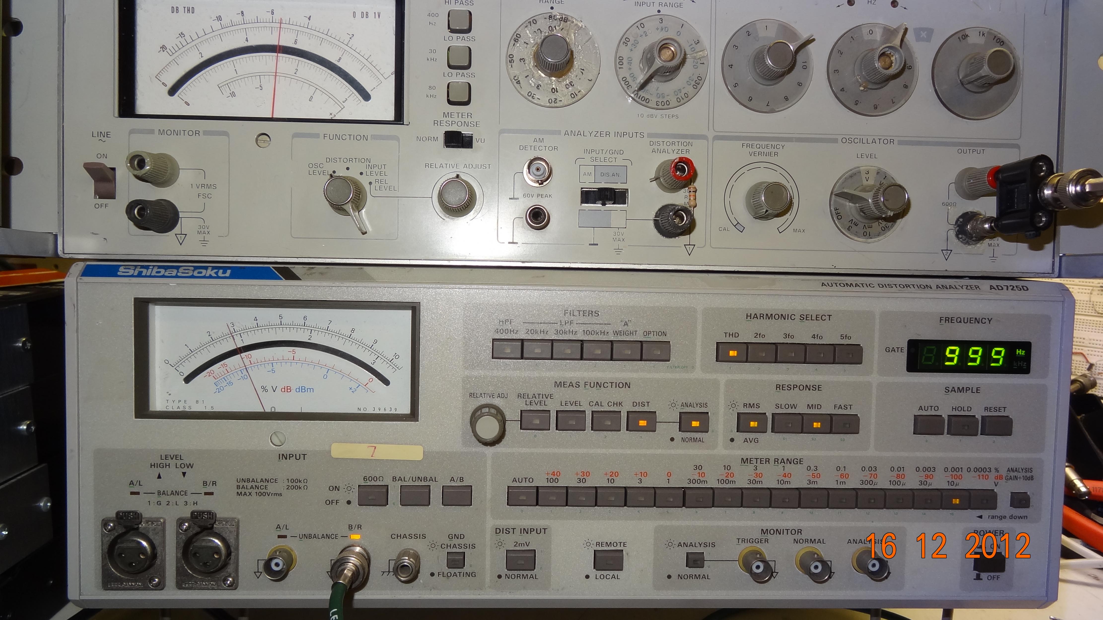

Right now, if i use the X1K range (optimised for that range) and adjust the freq dial from 1 to 10.... It'll cover most freq of interest; 1KHz to 10Khz. The ShibaSoku monitored the 339A generator shows good ageement with the 339A analyzer.. even though the levels are all small and in the lower 10% of the meter range. Good meter.
I get same reading value on both instruments meter displays. Nothing measurable above H2, btw: HP339A at 1KHz is .00023% thd+n and 10KHz it is .0008% thd+n. This is almost usable. I need .0001 or better. I havent replaced some opamps which could further reduce the THD. [And all filters IN on 339A analyzer.]

David:
Yes this is exactly the problem. You can see it monitoring the control voltage on the gate.
It changes with range and frequency.
I can use the summing amplifier which drive the jfet gate in the AGC to sum the signals in.
I'll give it a try.

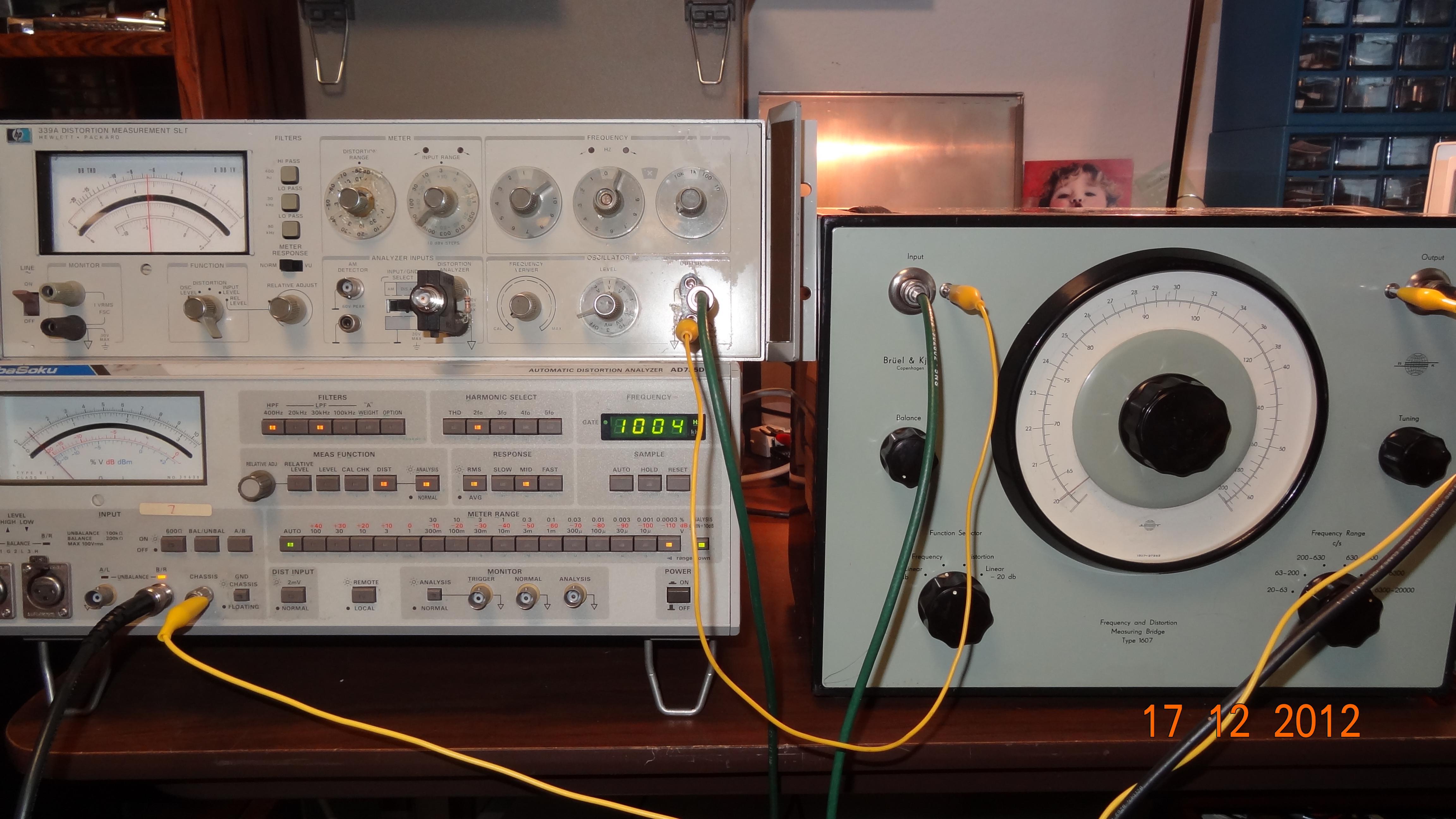

I have a variable twin-t filter and I applied it to the 1KHz signal from the 339A. I tuned the H2 out and now the distortion is -- .000025% (4 zero's) ! 😀 [maybe mostly noise.. have to check with FFT]
Though it will be great to have it all done in one box. I'll follow on further lowering; espec that H2. Thx-RNMarsh
The B&K is also lowering the 3rd and up harmonics (and the fundamental) so its not clear what you are getting. The 725 will go down to .00001% with the ag15. Too many zeros and its easy to get confused.

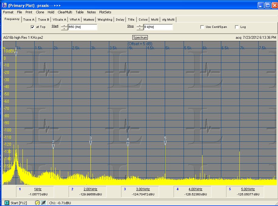

Attached is a plot of the distortion from the AG16 measured with an AK5394A demo board. All of the harmonics are -124dB or below. This is probably the limitation of the AK5394A since the 725 indicates much less distortion.
I think -120 dB and below for harmonics becomes a point of no real return for effort. No analog recording system ever came close and this is possibly the best digital today.

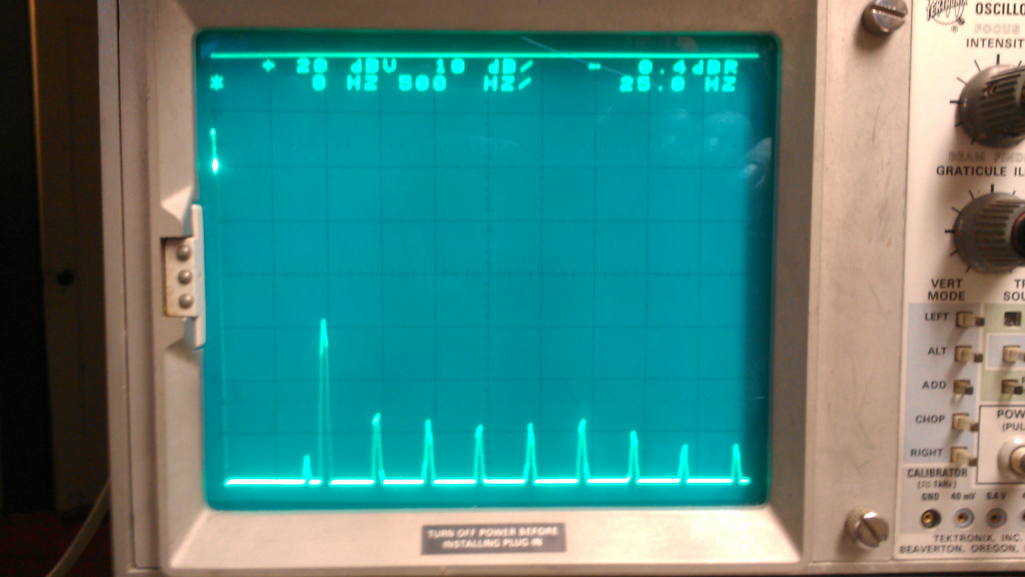

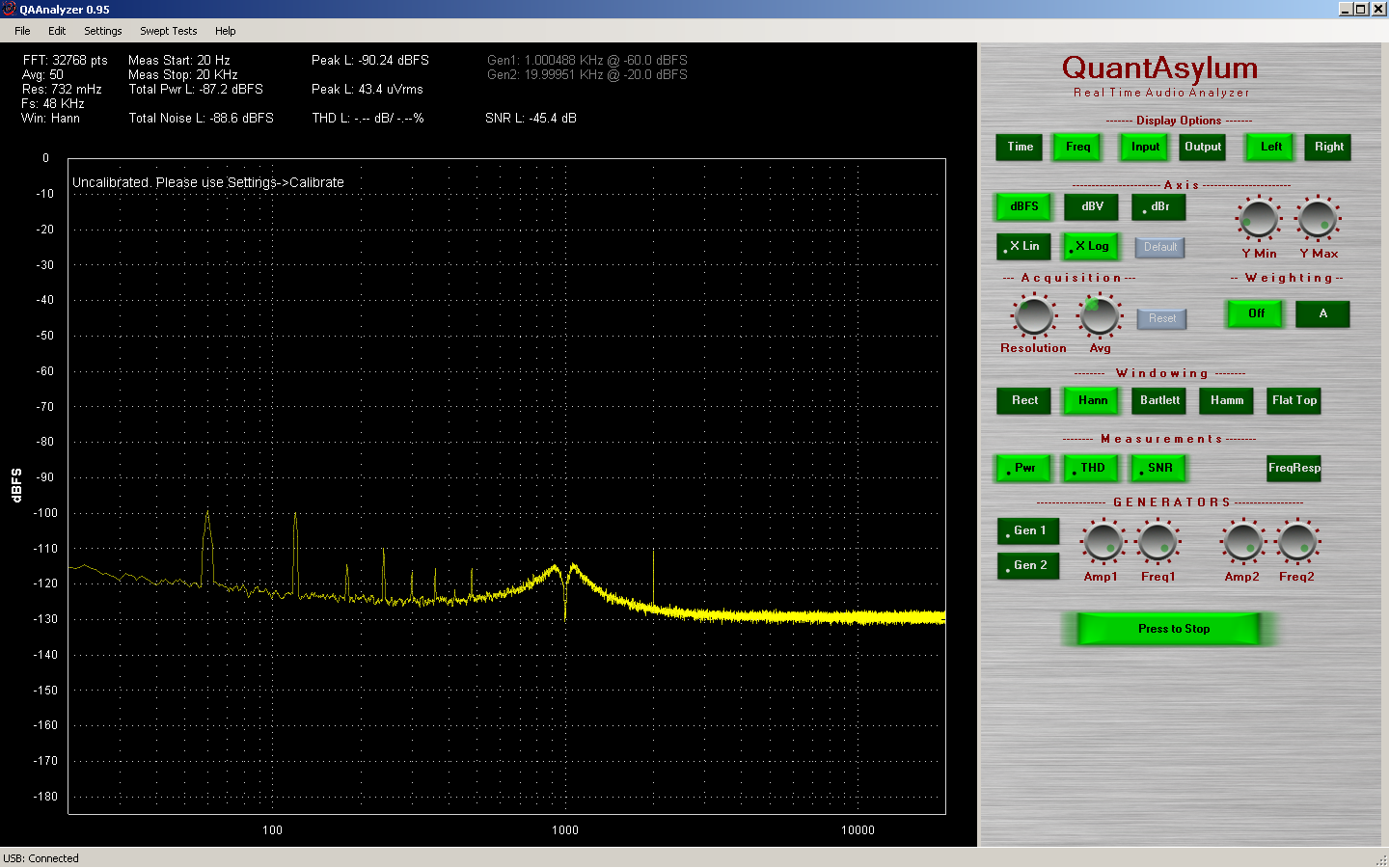

Attached is a snapshot I took of the distortion output measuring Victors oscillator. The tall peak is the 2nd Harmonic. 2-10 are shown in a bandpass to 5 KHz. This does not change with input frequency. You can also sync to the trigger output and see phase relationships.
